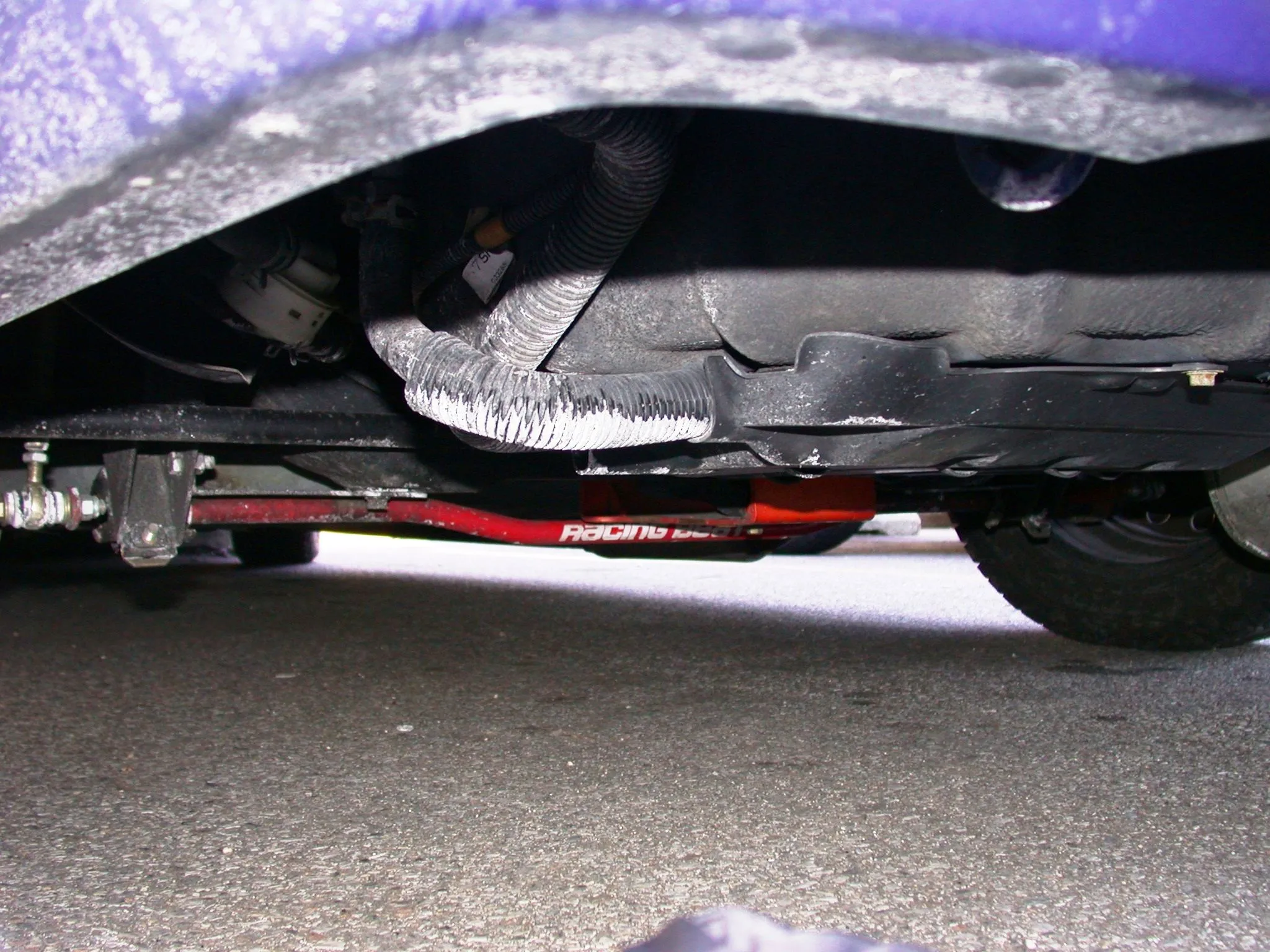

The result...My GTSPEC lower tie bar getting scrapped on driveways, potholes, or sharp turns. I couldn't fit a finger btw the tire and the fender (it's not rubbing againt the fender at least).

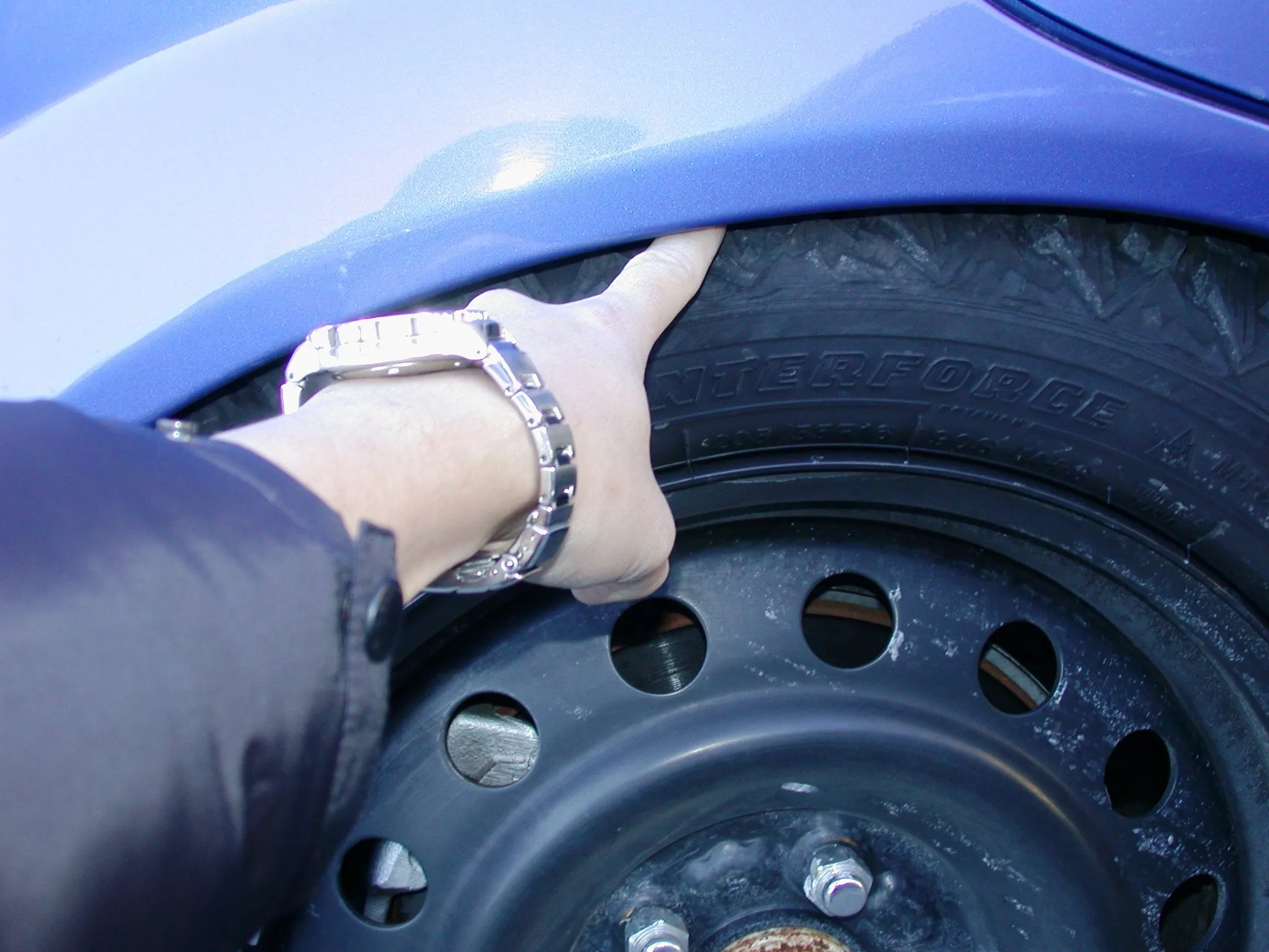

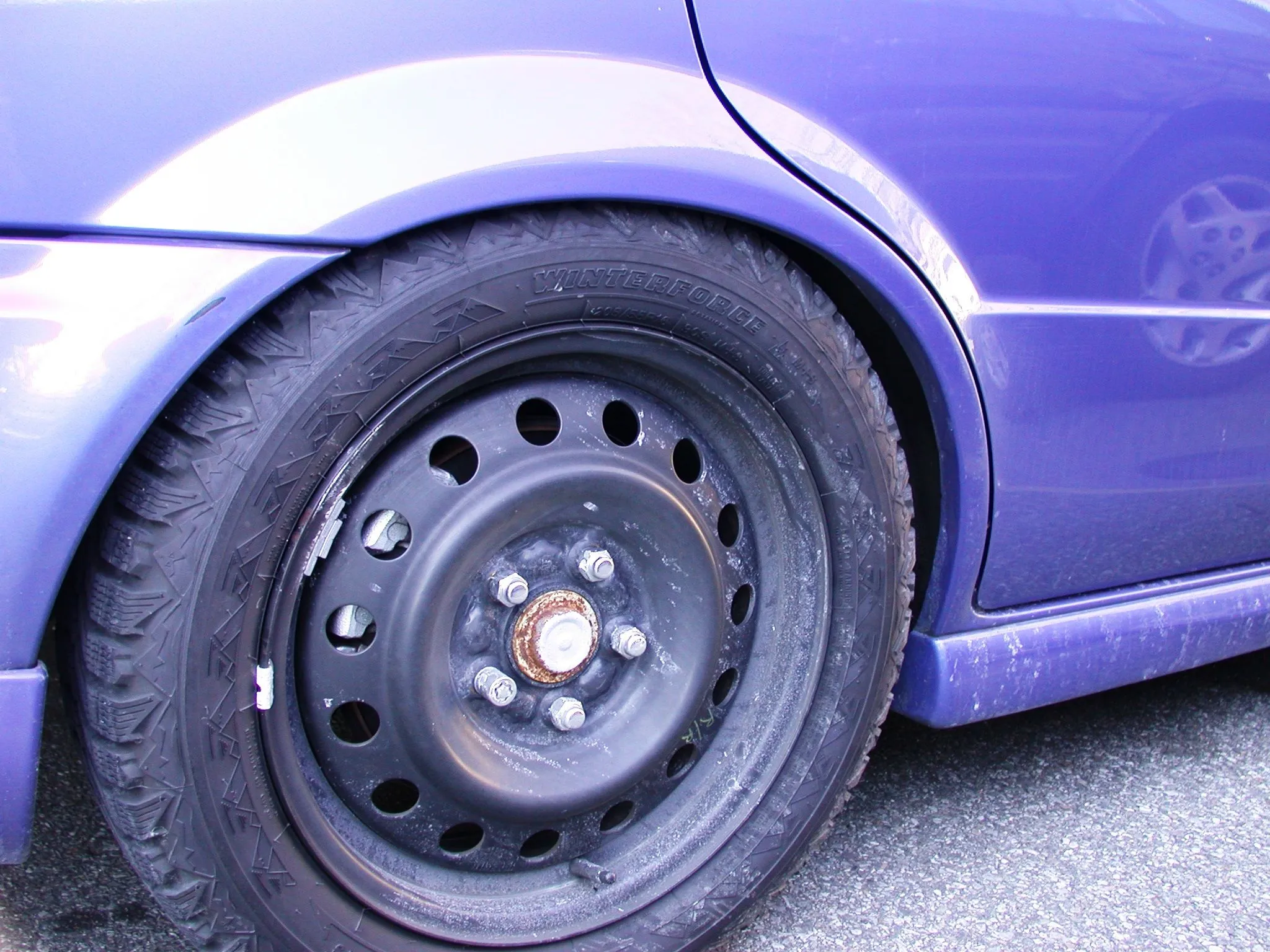

205/55/16 winter tires installed

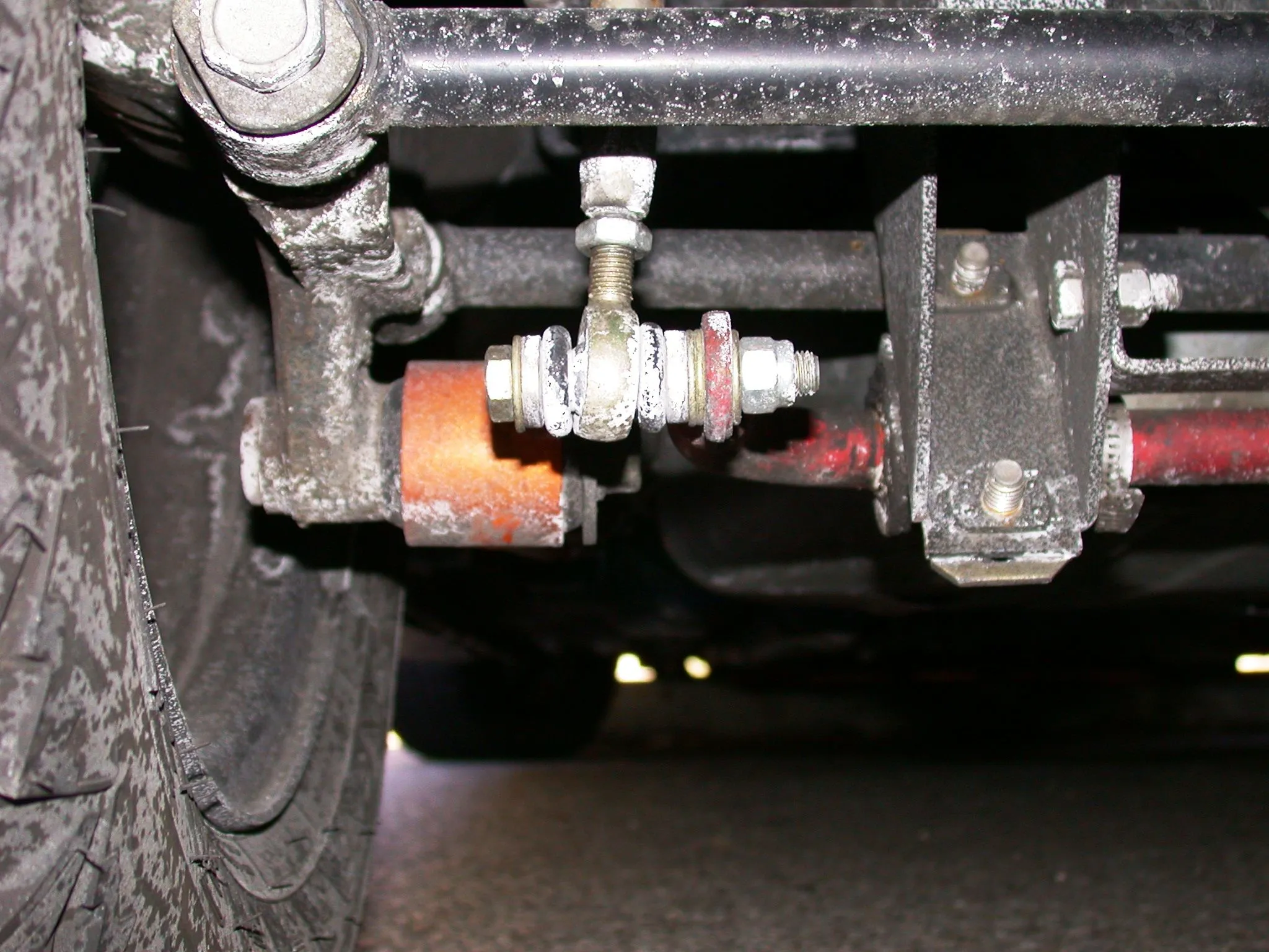

1. Rear Wheel Gap (can't get my finger between)
2. Rear Wheel

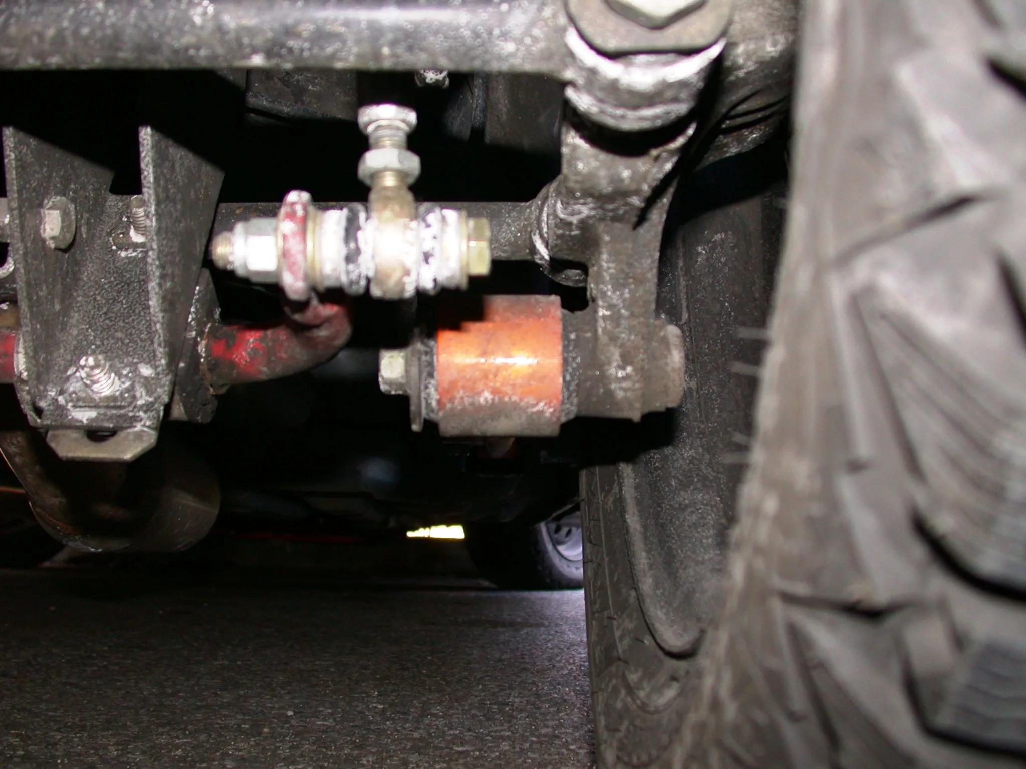

3. Driver's side lateral bar (note the scrape on the bottom)
4. Passenger's side lateral bar (note the scrape on the bottom)
5. General view of rear suspension
I couldn't get a good shot of the front tie bar, but it's really scrapped up.

There is no way that bar couldve hit the ground UNLESS one tire was in the pothole deep enough to come up 8 inches and hit the trailing arm.

Is the scraping you hear on sharp turns in the front end? You are running a very tall sidewall on your tires and they are probably rubbing on the inner fender. With your ride hieght it's possible the tires could get up into the plastic inner fender on bumps as well. Especially if one of the puch clips that holds the liner up has come out. I bet if you take the wheel off you'll see scuffs in the plastic or on the metal of the inner fenderwell. I'm not sure what the problem is in the back. Have you checked to make sure all the bolts/nuts are tight? Possibly the upper strut rod nut. Everything else looks to be correct. If the lateral arm or swaybar was hitting something you would be able to see a mark on it.
yes the tires are too big that's one of the problems...
he's supposed to use 205/50-16s or 195/55-15s
