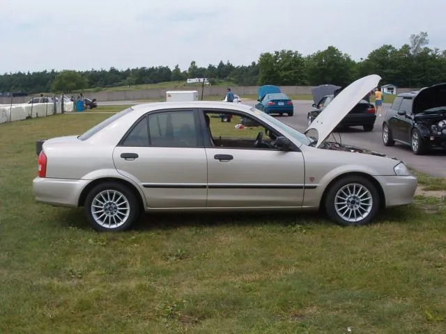

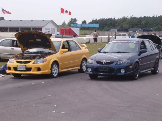

Here's a picture of Jeremy's sedan with with B-Spec springs, MSP adjustible struts and MSP Sway Bar Kit in track trim.
And here's a picture of my car with B-Spec springs, Tokico Illuminas and MSP Swaybar kit in track trim.
You'll notice that the sedan sits higher in the rear, and my car sits higher in the front.

Its not even possibble on any normal road for the Lateral arms to touch anything...I didnt see any scrapes in the pic..All I saw was a bunch of road grime and what looked like salt everywhere....?
I agree with you. I guess something else is scrapping in the back. My mechanic didn't see any fender rubs.
