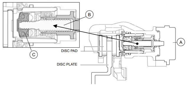

So I couldn't get good photos but the diagram in the TSB is pretty good. The EPB motor (A) turns the screw (B) to retract or compress the the brakes just enough to apply the braking for parking. I believe the purpose of maintenance mode is actually not to protect the motor as much but to retract the ball and ramp (C) so the piston can be pushed straight in. In my case, the screw (B) got pushed out so far it was no longer in the collar and trying to push straight in and turn the screw would have worked but it's very hard to get lined up. On one side I ended up crossthreading it pretty badly.

The TSB says:
DESCRIPTION
Some vehicles with the electric parking brake (EPB) may exhibit the rear brake dragging resulting in brake noise and the outer disc pad abnormally worn out. Or the vehicle may roll momentarily when starting from a standstill with the EPB applied. (The EPB is not automatically released for both wheels at the same time.)
CAUSE
This concern is caused by the EPB being not completely released.
The EPB control module judges that the parking brake is completely released when the current value flown to the motor (A) drops to the threshold, namely when the rotating torque of the spindle (B) drops.
Due to insufficient accuracy of the screw threads of the ball and ramp (C), the spindle (B) may idle momentarily during the EPB release operation causing the spindle rotating torque (the current value to the motor) to drop to the threshold before completely releasing the parking brake.
MASS PRODUCTION CHANGE
The ball and ramp has been modified to improve the accuracy of screw threads.
That’s why I’d go get a pair of new and revised OEM rear disk brake calipers instead of trying to salvage the original ones which have flaws.

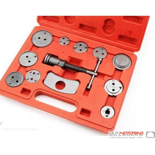

So what’s the consensus on the proper tool to compress the piston back into the caliper? Plan on using it across several vehicles. Not a huge fan of the c clamp since it’s not quite as precise applying force on the piston And it’s a bit clunky

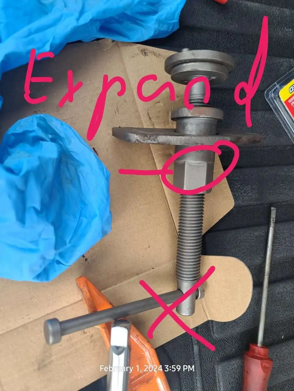

Well that didn't go too well. I ended up finding a youtube video on manually resetting the electronic brake here: https://www.youtube.com/watch?v=wAB43eO7wIs and it allowed me to reseat the piston, however I could not get it down far enough to span the new brake pads. All I could do was to put the old rotor and brake pads back on till I can figure it out. At least I can drive it now. The procedure in the video is the same for the Mazda, instead of torx screws they use allen bolts and a hex-headed adjuster bolt. I wound the adjuster bolt all the way down till it stopped and compressed the piston as far as I could but it wouldn't budge after it got down to about 3/8" from where I needed it to go. Just could not fit the caliper over the new pads for anything
The brake maintenance mode light will not turn off either. I tried holding the switch down and foot on the gas while hitting the start button 3 times twice, but it won't turn it off. Tried resetting it into maintenance mode again, then trying to turn it off, but that didn't work either. I can drive the car, but the emergency brake light keeps flashing and it's still in maintenance mode. pissing me off. half hour job is turning into a nightmare. Any help gladly accepted!
I'm also going to get that compression tool as I don't think the C-clamp is probably a good idea being that I had to attach one end to the plastic housing of the EPB. Ended up making my own tool to use for tonight.

The fancy brake tool set with many adapters you linked is mainly for the rear disk brakes also used by mechanical parking brake. The adapter needs to fit the size of the caliper piston, and 2 dots on adapter are to fit 2 holes on piston to turn it while pushing the piston into the caliper. You can also rent this brake tool set for free from AutoZone even if you dont get pads from them.
But for rear disk brakes with EPB on 2016 CX-5, you dont turn the piston while pushing it into the caliper, or the internal components may get damaged.

So if you have a wrench, you can move the large nut down. It won't spin the shaft but push instead.
