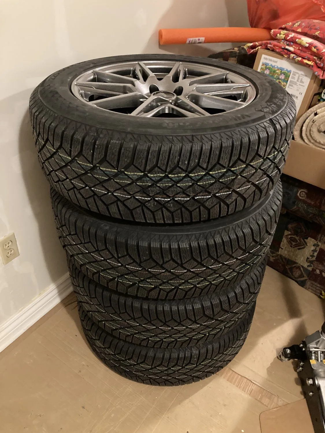

Yes, 19x8 ET45 will fit with no modification. The tires will look and function the same. 225mm = 8.86", so the tires are better suited to an 8" rim anyway.
Here is a 225 tire on an 8" rim:
