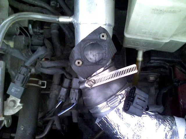

is the piping the same size as the stock intke? are you sure the sensor seals well with the intake u bought, can u wiggle it while its in the intake?
if its the same size, then get a bicycle inner tube patch kit or two, take the biggest one, and cut it out as a gasket with some manicure scissors.

screw it.. its universal so my im putting it in my friends car to see if itll work. if it does, he;ll just pay me for it. lol lets hope it works.
Pst, hey, buddy, I made a CAI w the same parts as you did and had the same f*cking problem. The solution? look for a piece of pipe that's the same size as the stock MAF housing on the air box (I used white PVC, exact size), cut a hole on the pipe to match the MAF opening on the adapter and then use something to hold and fill the pipe inside the adapter (I used sheet foam). I did that on mine three years ago and no problem. The hesitation issue can be solved w a Celica Maf, as I did. You'll feel the difference, since the universal ducting is larger than the intakes offered for the 1.6L. They scream pretty loud too (friday)

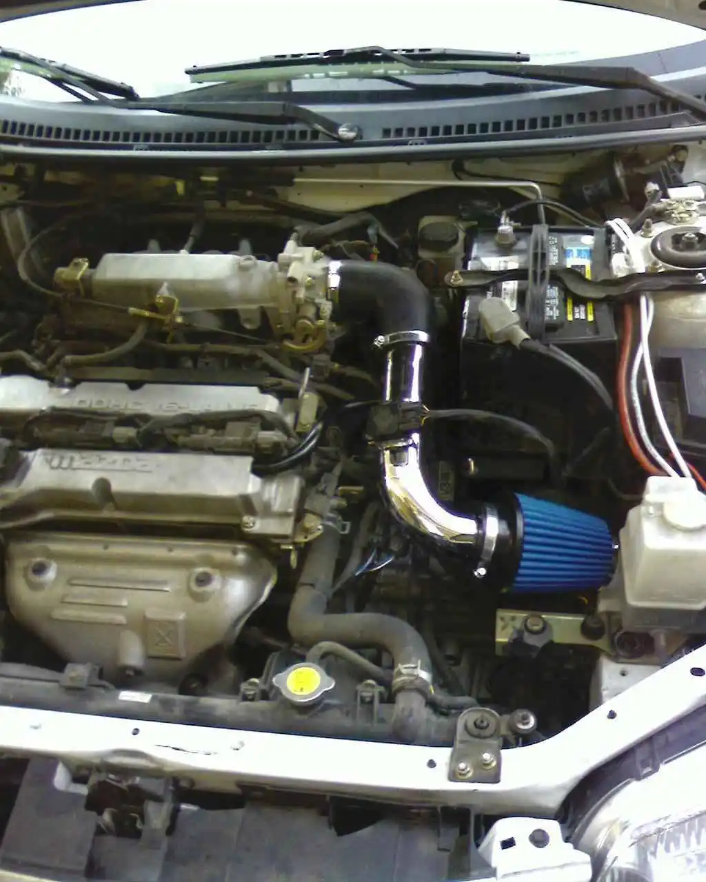

The SRI is $80.00 shipped...pic below...and I can get most things available
for third-gen pros.

now this will deffinatly work with
A. my MAF sensor,
B. automatic 1.6 with little to no hesitation??
