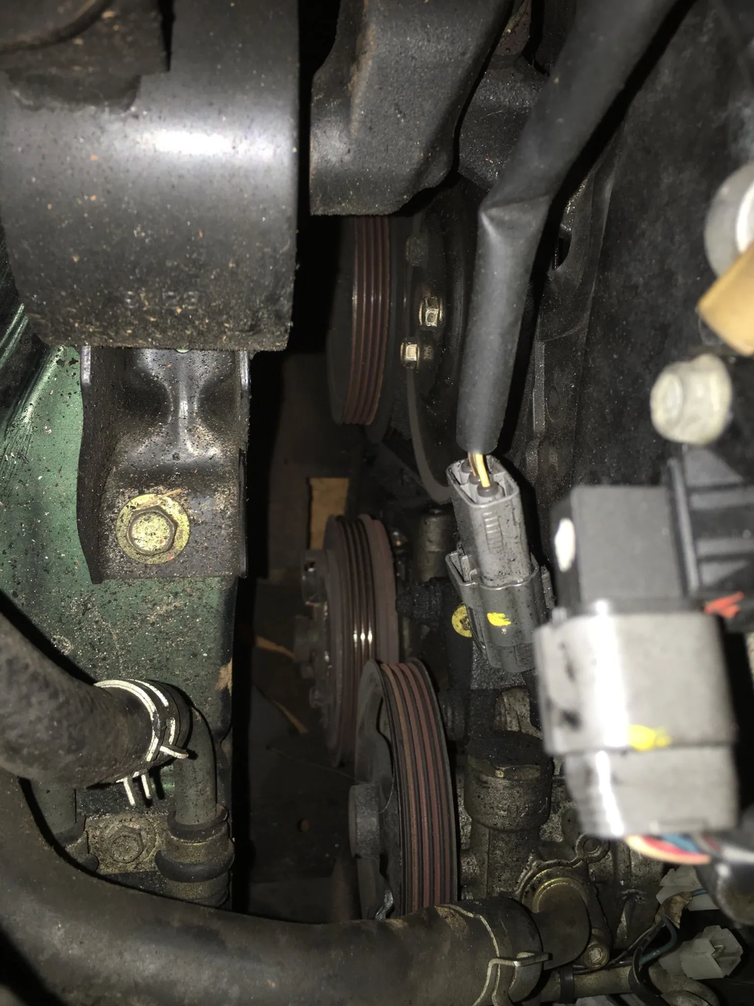

funny and strange story. When we spoke weeks ago you asked me to test for clearance with a flat stick. I did that and it looked like there was definitely clearance. Not a lot but still there Was clearance. Now when I checked today there was no clearance. We only loosened the Power Steering Pump to try and get belt on. What could have changed (moved)? Either that or Im going out of my mind. Just my luck that this would become such a problem.

Perhaps when you rotated your power steering pump the pulley rolled in the way and you lost clearance??
There's quite a bit of movement on the power steering pump. (on my car anyway)
We had hardly any movement at all. Maybe a quarter inch movement tops.
We kept on thinking it should move more but it never did.
We loosened all 3 bolts on it also. Still not much movement.
If you loosen bolt B, the pump should pivot down to give you clearance for the belt.

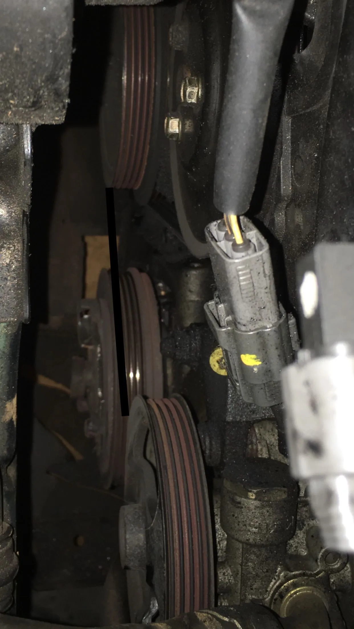

My clearance looks nothing like yours. You have plenty of clearance. I do not. Open Attached Photo.

Your picture is from a different angle.
Mine was from the front looking down.
Did you turn the adjuster bolt all the way to fit the belt on?
It should pivot the whole pump until the belt fits on then tighten it up again and it should clear the AC pulley.
Did you fully loosen (or even remove) adjuster bolt C?
The belt should fit on even if it's clipping the AC pulley.
Unless our diagrams are wrong and the 1.6L is different.
The red arrow is the angle of my picture.
I think the blue arrow was your angle

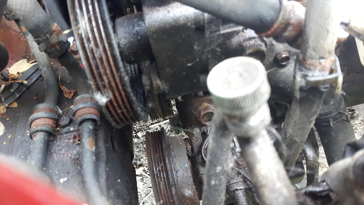

Yes my Photo was taken directly from top not a side view.

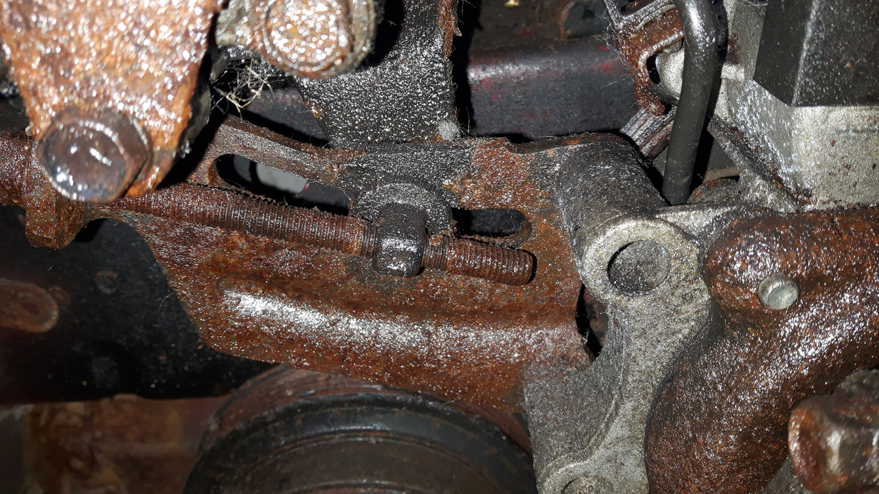

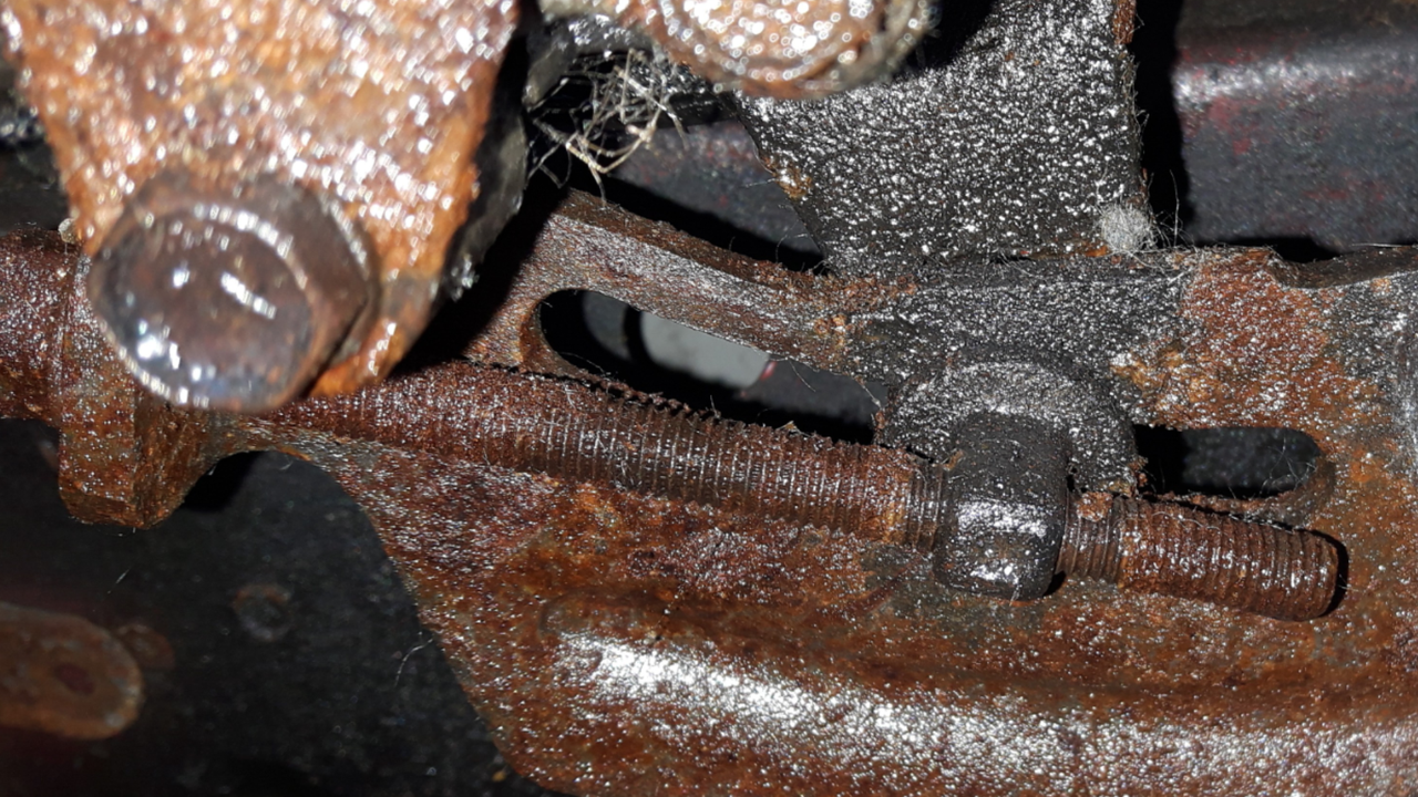

Loosen adjuster C until it unthreads from B then the PS pump will push all the way down giving more clearance.
This is my rusty adjuster C.
You may just need enough clearance to get over the lip of the pulleys.
