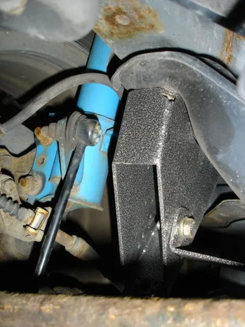

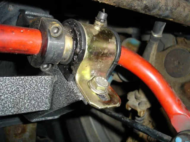

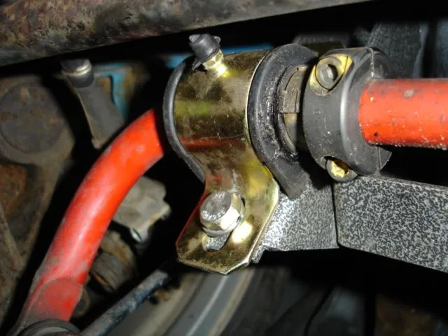

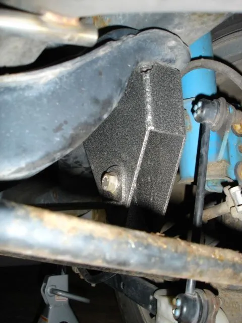

photos of installation--please help
I left the pics large on purpose so that if I've done something blaringly wrong someone can tell me if I f'd up (the pics in the installation manual were pretty much useless for me). The first 2 pics are w/the anti-sway bar installed, and the second 2 pics are just the brackets w/out the sway bar attached yet.
Please let me know if something looks "off" b/c everything seems tight as hell. Nothing moves back and forth or otherwise (at least not with my bare hands trying as hard as I can to move everything)

doesnt the "Clunk" come from the link kit? and the squeek from the Swaybar?
so wouldn't this kit solve the squeek, and not the clunk?
IMO
in my case, the clunk was caused by the bushings wearing out and having play. They wouldn't last for more than 10K miles or so (and that's under normal driving--not hard cornering at all). The root cause, as I see it, was the original design of the brackets for the anti-sway bar being in the wrong spot, thus allowing too much flex in the sway bar. This bracket kit extends the point at which those bushings attach outward, suposedly correcting the flex problem at the source. However, there is clunking despite it being totally snug, greased like crazy, and handling wonderfully.
I'm completely stumped, and quite frustrated...
Now having run these brackets for oh, about two years or so, I must come back to provide a long term review. I am still so pleased with these brackets. They are simply one of the best upgrades I have made to my MSP (Tie at the top with AWR Motor Mounts). Do they squeak? Sometimes. Do they clunk? No, Not at all. The AWR endlinks do, but when adjusted correctly and lubed, they do not. Now, that said, my ES bushings themselves were binding. Search Andy Howe's GRM article that talks about his STS Miata's rear bushings binding. After modifying my bushings, the rear bar was great and the car suffered no snap oversteer. There is no design flaw with these brackets, I'll endorse them whole-heartedly.
