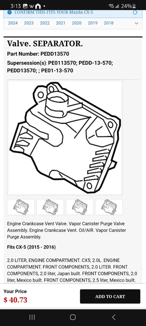

I'm guessing it something that attach to this. Going to have to dig around, not many documents or video.

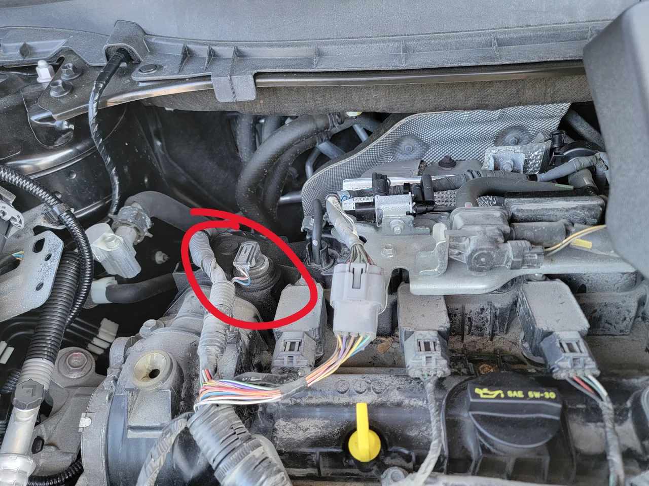

Check this hose, circled in red. That hose is connected to the oil separator, sometimes also called the PCV valve. As @N7turbo suggested, check to see if it's loose or if it has cracks/holes. It's located at the front of the engine, driver's side. In this picture, the engine cover is removed.
Maybe also check the oil control valve (OCV) on the top of the engine, passenger side. Some seepage is common, but it may be seeping or leaking more under load, then dripping onto a hot surface.
Also, keep an eye on your engine oil level just in case.

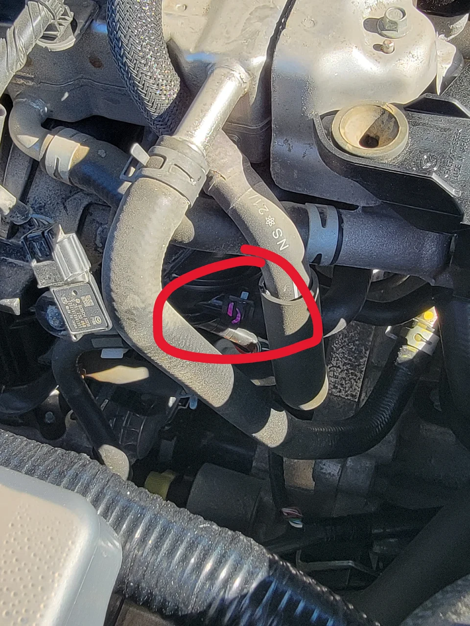

Hi so been a while. Was back in town for the holidays. I cleaned my engine and look around. I pretty sure this is the issue.
Some other people have this here too. It's near the air condition. So I'm positive this is it. I'll wait till next weekend. Clean it once more and drive on highway at night.
If so, whole Valve Cover needs to be replaced. Which from some user, issue came back still. So, less zoom for me I guess.
