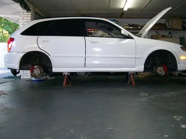

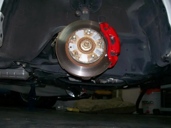

I believed i used the Duplicolor brake kit with the brush, i put my car on four jack stands and took all of the calipers to paint. I put two coats on all 4 and they have been on for about 8 months now and are chipping pretty badly. So i would make sure you clean them really well and def. put on two coats at least.
