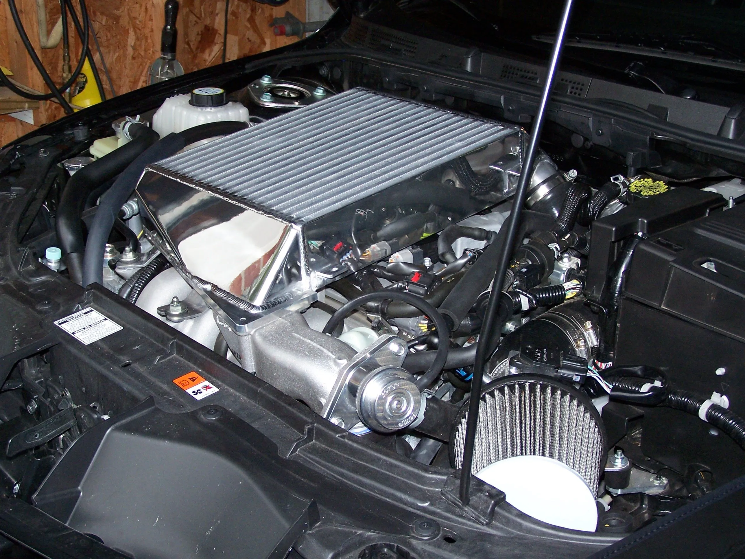

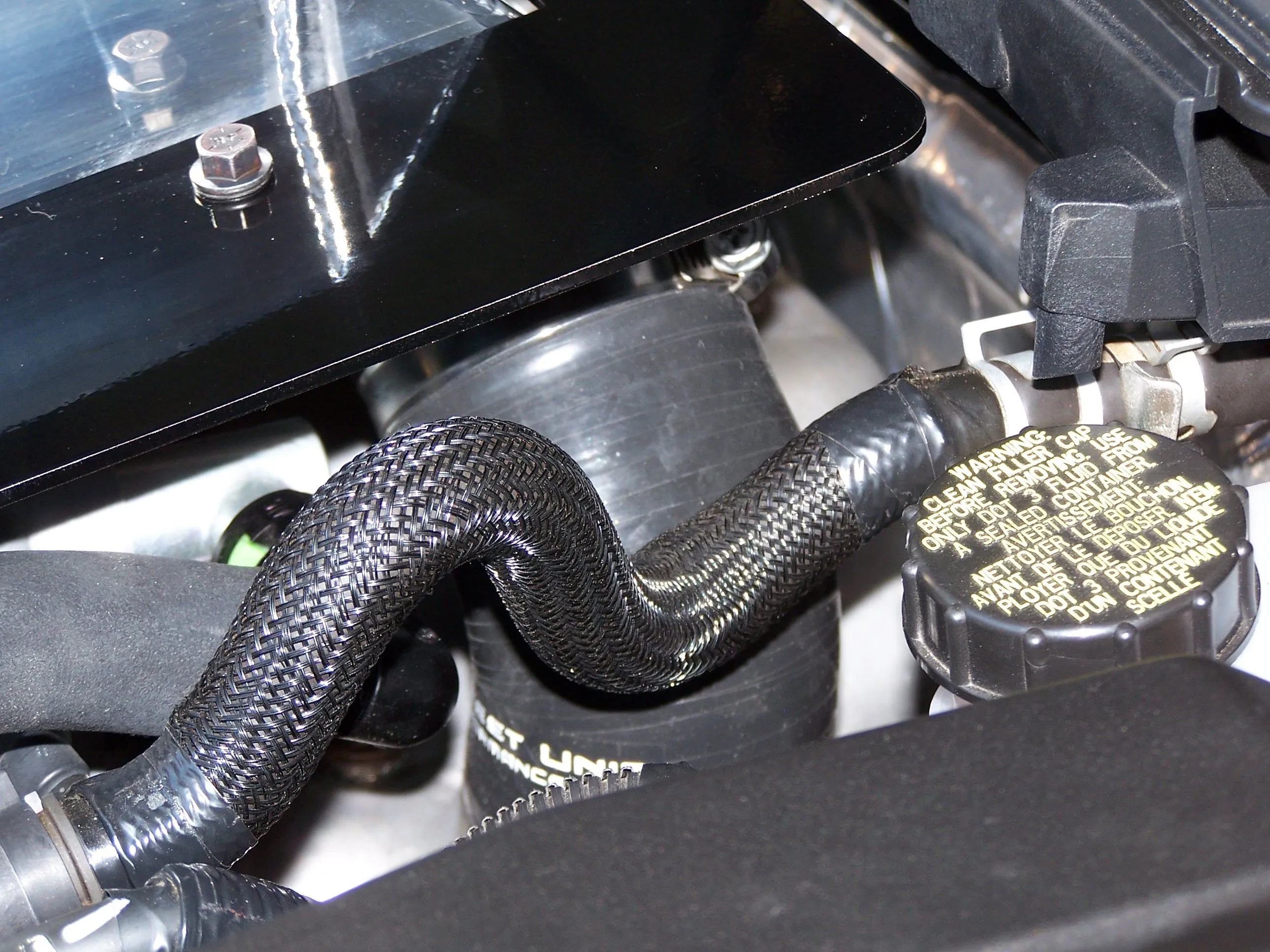

I just installed my ETS and used the SU Boost Tubes. They fit great. I had no problems with them, no kinking. They went right on, with a little smear of vasoline. The fitment problems were with the old style SU TMIC.
Edit: I tried to get a pic of the rear tube so you could see.
thats wierd well their the ones from the darkstar motorsports. But they look alot like the obx-r ones so screw prabaly just go with SU tubes.
This site blocks any mention of SU, even in links. Do not get the OBX tubes, they are too long and will have to be trimmed. I had them 1st in the GB kit from Darkstar.
