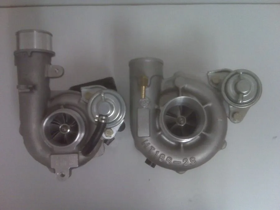

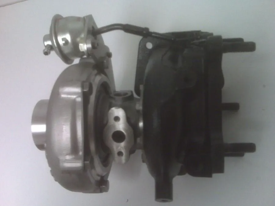

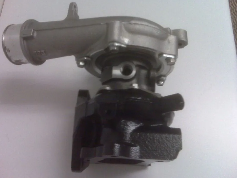

I just wanted to make a robust, reliable replacement. HP improvements just come with the package (pullup). Here are some pictures of the units.
