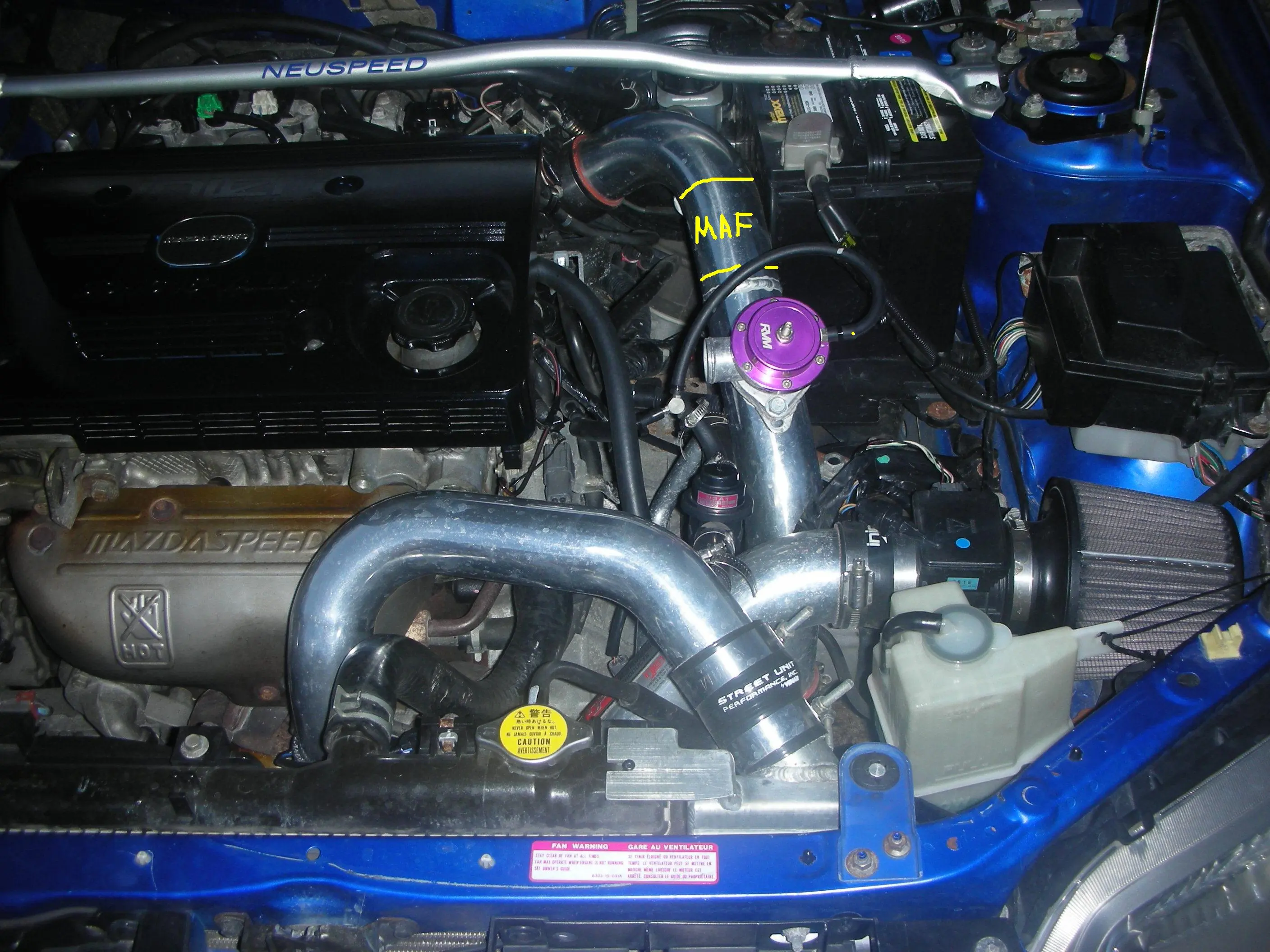

i think thats what im going to have do to . but im not sure how far apart to place the maf. betwen the tb and the bov.
there is a thread on this but i believe it is at least four inches, but double check that with a search for maf relocation
4 inches is correct. If you locate the BOV and MAF apart with a silicone coupler, you should have adequate distance to not cause any issues. Don't forget to put the MAF before the BOV on the pipes way to the Intake manifold.
Do you think this is a good spot to put it?
