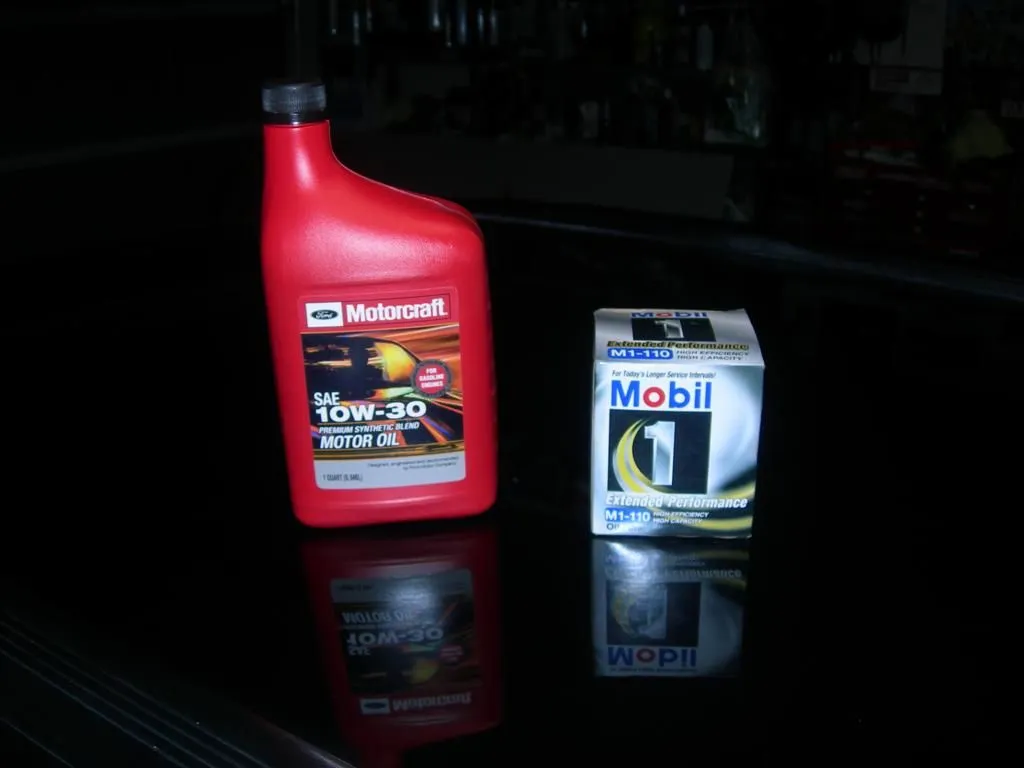

Same thing here: the M1-108 replaces the OEM size unit. Can we use a larger Mobil 1 filter that will fit ?

I use the mobile 1 626 filter in my car with synthetic blend oil.

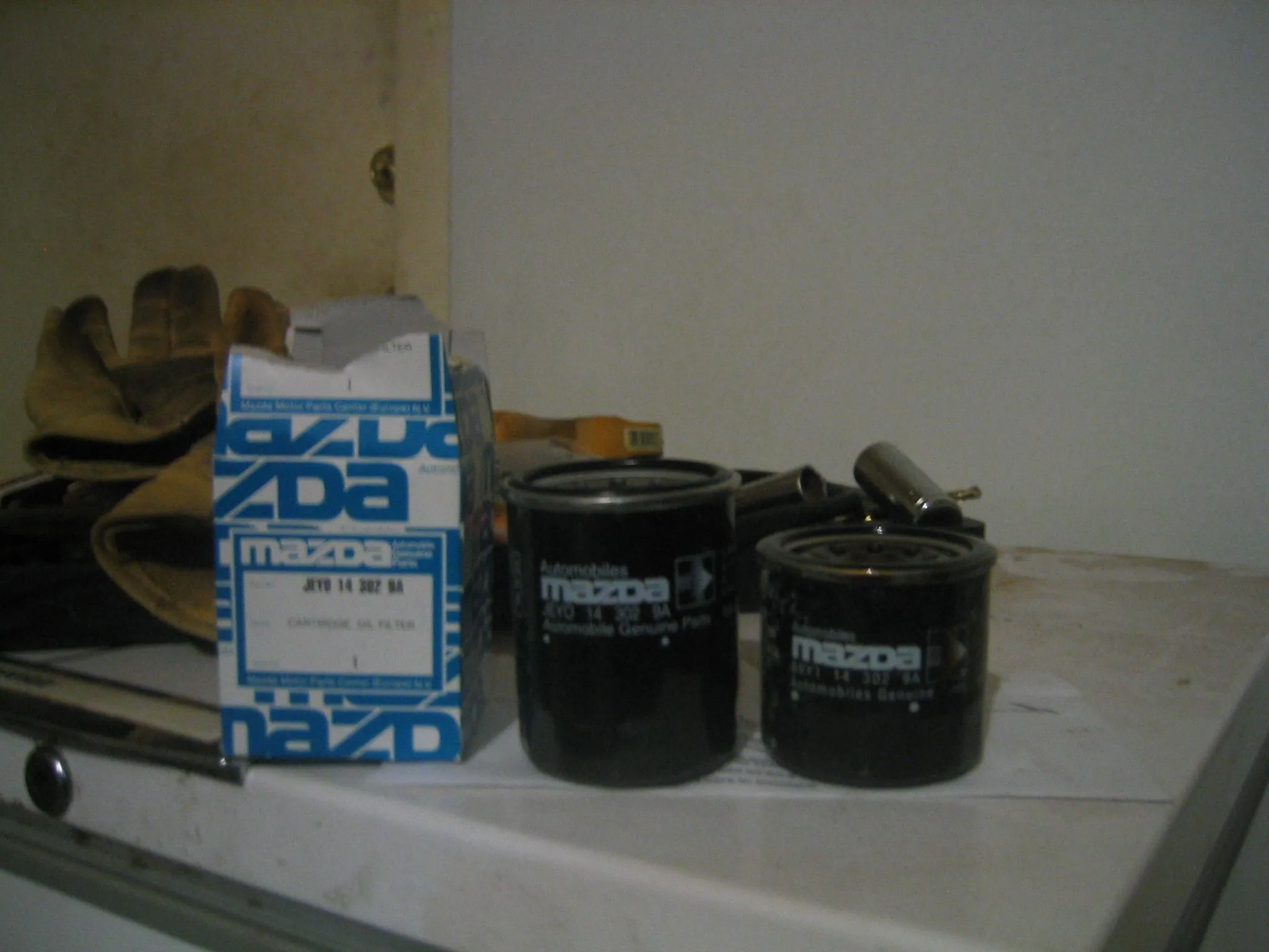

OEM 626 filter compared to OEM pro5 filter

Hi folks, I know theres numerous threads around talking about the substituting the 626 for the Pro5 oem filters, I just tried it at the last oil change.
Anyhow, for those curious about the difference in dimensions, heres a pic.

I also used the 626 V6 oil filter for the first time last change, havent noticed any changes, I was just hoping that it would clean the oil better and keep it cleaner longer? I dont know what other reason you would even use the bigger filter?

did my oil change yesterday end while shopping for filters I remembered that we can get the filter for the 626 V6 2000 or so...so i check the stock one versus the v6 one and oh great they are exactly the same but the v6 one is 1 inch longer so thats great!and what is great too??? IT COSTS 67 cents less :P so here it goes on my p5
and it is easier to put on then the stock one while filtering a bit more. and crap i put 4 liters in it so gotta purge a little to get it to the full line on the gage and oh surprise doing that was unexpectingly good cause lot of old oil was mixed with the new!
runs like a charm...so no difference at all placebo effect i think..we'll see at the next oil change :P
The only thing it does is allow 4 quart changes vs. 3.75 . Is basically adds 1/4 quart more to full mark on stick.
