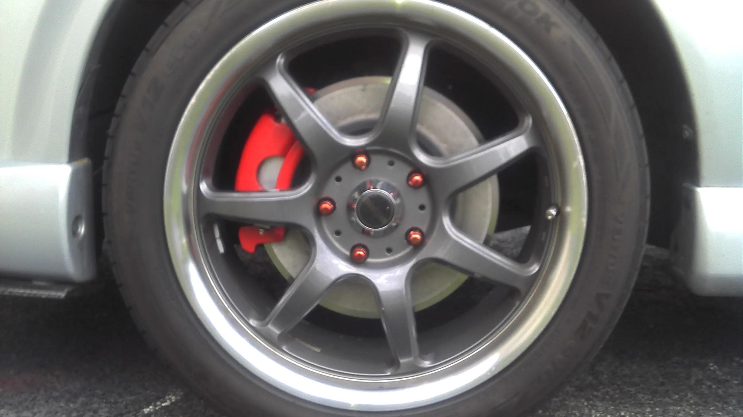

Finally got the mazda 6 rotors, OEM to make sure they fit jeje, if somebody wants to make the mazda 6 05 swap I have the rotors power slots almost new.
