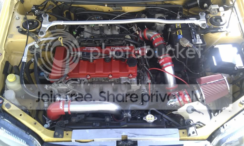

I am going to a MAP based tune with a megasquirt, and venting to atmosphere with an HKS along with the stock BPV recirculated unless the noise is too obnoxious in which case, I will buy some sort of Y adapter to recirculate both. However, I don't think the diameter of the return on my injen intake is large enough to completely eliminate back pressure on the compressor if I recirc both, so I may have to have a larger return welded into it, or just live with either the turkey or some BOV noise. I've asked around for opinions, but I really won't know until I try.
