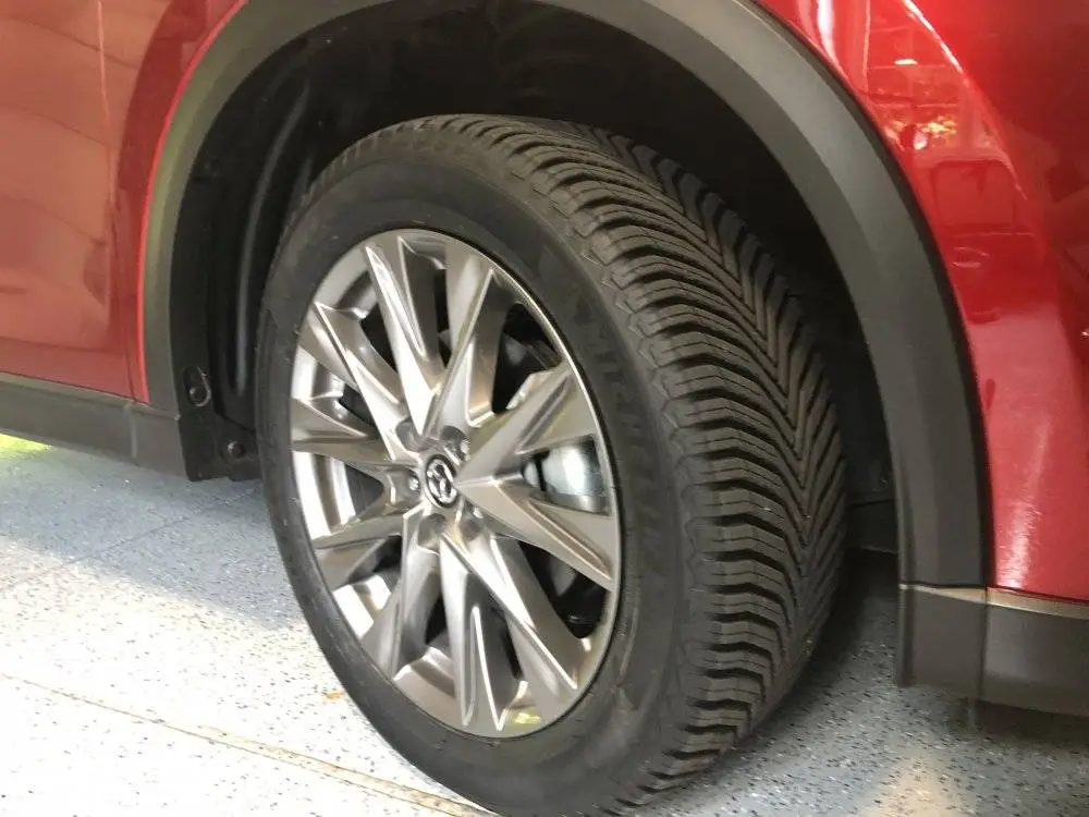

My Michelin CrossClimate2s were installed at Discount Tire this afternoon.
I received a $110 discount from DT for ordering online, and there is a Michelin Back-To-School rebate of $100, bringing my grand total to $839.72.
Nothing to report as far as performance since I have only put 12 miles on them so far. What I can tell you is that they look a lot better than I thought they would!
EDIT: I just read the Michelin Back-To-School rebate again, and the rebate specifically for CrossClimate2s is $100 not $70 !!! I made the change above.

Thanks! That's a great deal! Mine will end up about $100 more than you paid. I guess living in a populous area is not a good thing right now. :) They look great!
