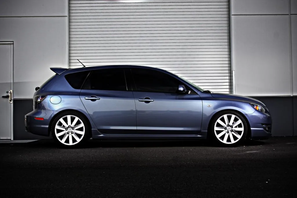

I don't know what tire size Mushdawg is running in that pic either. My big concern with lowering was to get the front down. I could not stand that the front sat higher than the rear stock on this car.

ya you wanna adjust it so that the spring is not too compressed compared to the length of the shock, or vice versa- that will cause bouncy-ness. It must be adjusted in equal proportions. I wanna cut down the threads on the adjustment part for the shock and shave the rubber spacer above the springs down to get my car about .5" lower. I already removed the lower of the two rear rings. If I can get my tires (225/40) flush with the wheelwell I will be happy as a clam on a mud bank at high tide

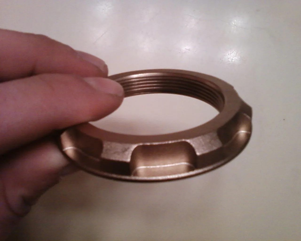

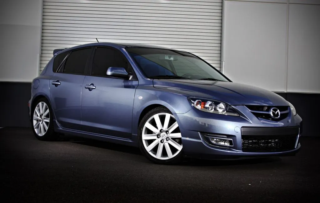

haha thank you man, I am really happy with the BC's. I have a few more of the car and one of the lower ring I took out from the rear spring.....
