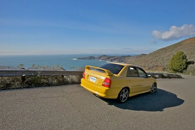

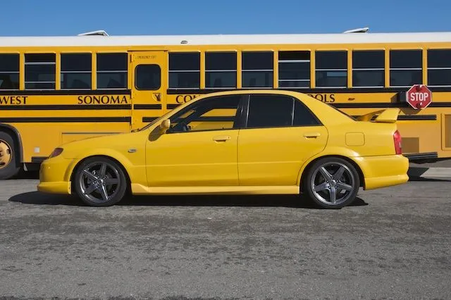

finally took it for a test drive today. handling was great! solid as heck. again, it was the drop out of the box. don't know how much lower than stock that is. and the dampers at 14 front and 13 rear. i probably won't go any stiffer right now since it's also a daily driver... felt plenty firm for some curvy roads.
here are photos of the drop out of the box, the test drive, and a friendly reminder!
