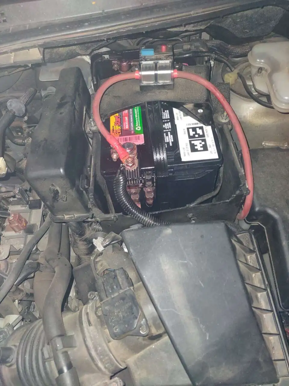

The van is spec'd to take a group size 35, same as my CX-5. You can go bigger though, to a 24F if you want a tad bit more "oomph" like if you have a stereo or whatever. The 24F pops right in without any modifications at all. That will get you an extra 100 CCA, give or take.
Another option that fits, Group 34 (med-big battery so tight fit and need slight mod to bracket). Costco carries Interstate @ $85 (a few years ago but prices likely increased), and IIRC, 800CCA (need to confirm).
