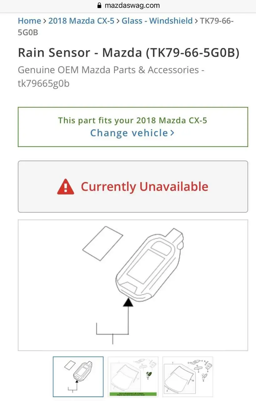

Anybody have any experience with this issue? My instinct is to replace the rain sensor on the windshield. Nothing visibly wrong with it, it’s adhered to the windshield. The wipers also function normally with the auto sensing feature. No other faults I can see other than the vehicle sensing it’s dark all of the time.
Parts to replace? TK78-66-5G0A (sensor)
TK80-66-5G2 (sensor adhesive sheet)

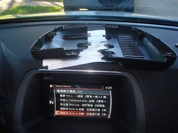

In circle is the infamous T20 Torx bolt which is always loose causing the rearview mirror vibrates (mine is loose again). The rain sensor is the one with the letter “A” which is supposed to clip on the pre-glued bracket.

I think the rain sensor is actually the top left module in that image, not the module with the A. I need to pop the cover off and investigate as you suggested. Bathroom reno is taking up all my time, damn cabinet installers popped the cap off a sink waterline and soaked a bunch of insulation and drywall this morning (facepalm)

⋯ I think the rain sensor is actually the top left module in that image, not the module with the A. I need to pop the cover off and investigate as you suggested.
Yes, I believe you’re right. Not sure what is it for the one with an “A” in picture? These pictures are from my 2016 CX-5 GT with Tech Package without i-ActivSense Package. There should be only one rain sensor in there. And looks like the correct part number for rain sensor is TK79-66-570B which includes the pad.

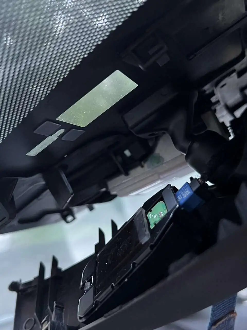

Nailed it. Aftermarket windshield (Fuyao), and there’s no bracket. I thought I saw the sensor through the windshield but it wasn’t attached. Gel isn’t sticky enough to adhere to the glass, and there’s a couple gray sticky tabs that I think were original to the sensor lol.
Going to see if I can procure a bracket and glue it to the glass. There’s a YouTube video of a guy doing that for a CX-3 or 30. I’ll order a new gel layer for the sensor as that’s one time use.

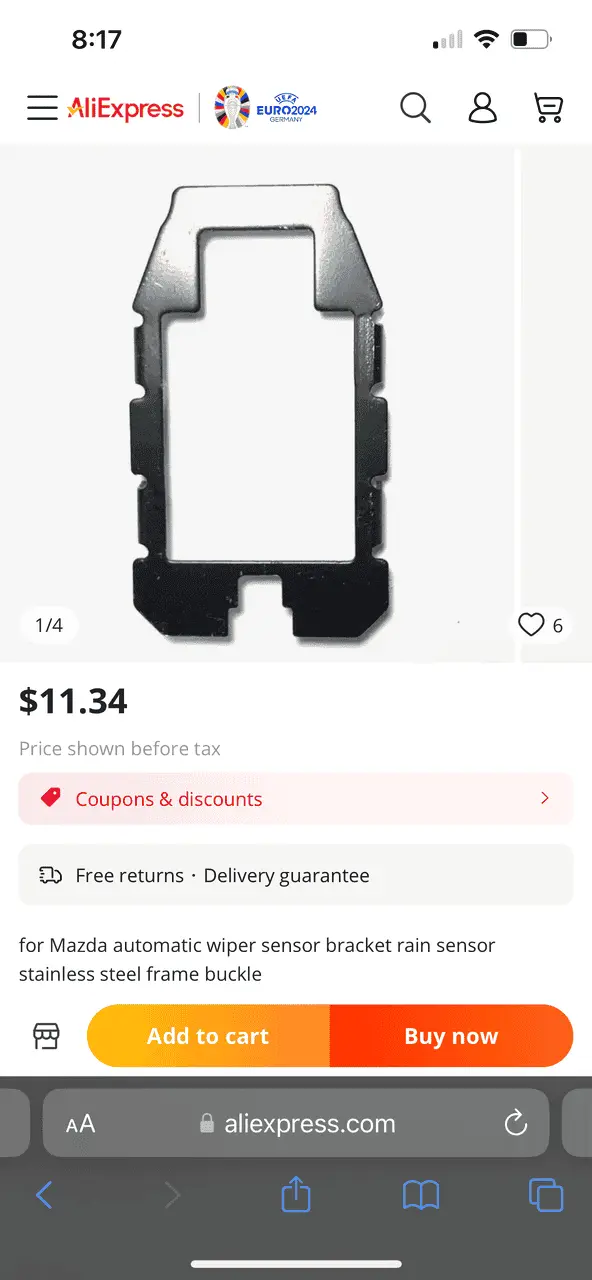

Giving AliExpress a try for the pictured bracket. As I feared, can’t find a OEM part as it’s part of the windshield. The appearance is consistent with a 2019 bracket I saw in an eBay picture. Wish me luck!

Actually you can have your mother-in-law taking the case to Safelite and ask them to put a correct windshield on which comes with pre-glued bracket for rain sensor. Aftermarket windshield such as a one from Fuyao they should have the one like OEM windshield with pre-glued sensor bracket. From OEM they have at least 3 different windshields for different trim levels and optional sensors. I believe Safelite simply ordered a wrong windshield originally.
The problem for putting the bracket on by yourself is you may have a hard time to the find the proper position on the windshield, and how long the bracket can stay on the windshield with the weight of rain sensor. The workshop manual even calls a calibration step on rain sensor after the (OEM) windshield has been installed.
No, the sensor bracket(s) comes only with OEM windshield(s), not sold separately by Mazda.
AliExpress is a great place to find something which is hard to find or not available in the US (like problematic CX-5 power seat short and long cables) with excellent price. I just got wiper rubber inserts for all of my vehicles as the prices for OEM inserts from Mazda are outrageous right now. They cost $2 ~ $3 each instead of $10+ each from Mazda, and they all look exactly the same as OEM and fit perfectly. They wipe very clean and quiet during many raining days recently in Dallas area. The only thing I don’t know is the longevity. Only time will tell.

new sticker is to be used when changing the windshield glass. The sticker is the gel type that makes the sensor work properly. Nothing wrong with the sensor. Its sloppy job by whoever changed the glass.. unfortunately.
I also have the adhesive sheet ordered from MazdaSwag. That should be here soon. I’m sure I’ll be waiting longer for the aftermarket bracket from AliExpress. That’ll give me time to choose an epoxy for the bracket
