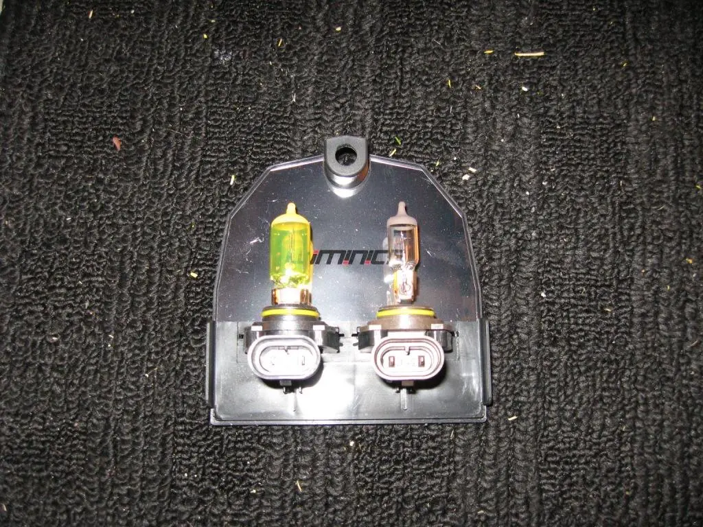

The first attachment is the Luminics JDM Yellow Krypton Series 9006 12V 55W bulb vs. the stock 9006 white bulb:
(as found here, FYI: https://www.amazon.com (commissions earned) )

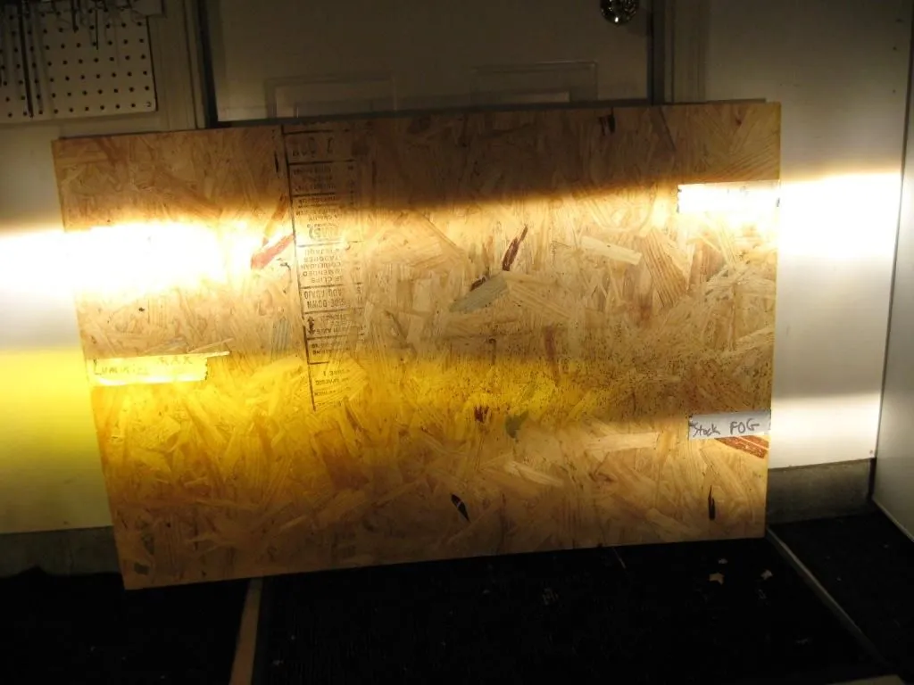

Second attachment is just a rough comparison of brightness and beam height/angle of full max (yellow) vs. stock setting (stock white).
I've noticed the following with the luminics mounted in the maximum upward angle and the light shields removed (as done in the write-up made by Rotus8):
  • no complaints from other drivers (so far anyway)
  • much improved viewing to the sides, though it might be better if I lower them a bit below max-up but not as low as the stock position
  • little light wasted to the ground (I don't have two bright yellow spots on the ground and the useful light is getting out)
  • the light I get back seems about 1.5X brighter, but only slightly yellow in appearance EXCEPT for the regions out to the sides - the luminics do a much better job out to the sides than did the stock fogs or the low beams (as one would expect, right?)
I can make more pics to show the side-performance or look if anyone is interested, but I think others have captured the general appearance in other photos...
