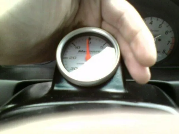

Yeah I am using the hard-line with a retrofitted connector at the end into the soft (rubber) line, i will double check my resting point today. As for the bouncing say i'm in 2nd gear and mash the throttle, the gauge will go to around 5psi and bounce... if i were to compare it to something i'd say like hitting a rev limiter only the needle bounces faster. You know what I will take a video with my phone today.. show you what I mean.
attached is the resting point of the car.. sorry for bad pics.. my cell phone.
Car is off.

Based on the gauge position with the car off, your probably right in the mix given the wide variance of MSP stock boost. I've always used 3rd gear to check and set my boost.
Ideally 20-22 IMO at idle. 17-22 is considered the sign of a healthy engine however. My MSP has always been 20. But no two gauges are alike, especially the ones drop kicked in shipping and neither are MSP's.
