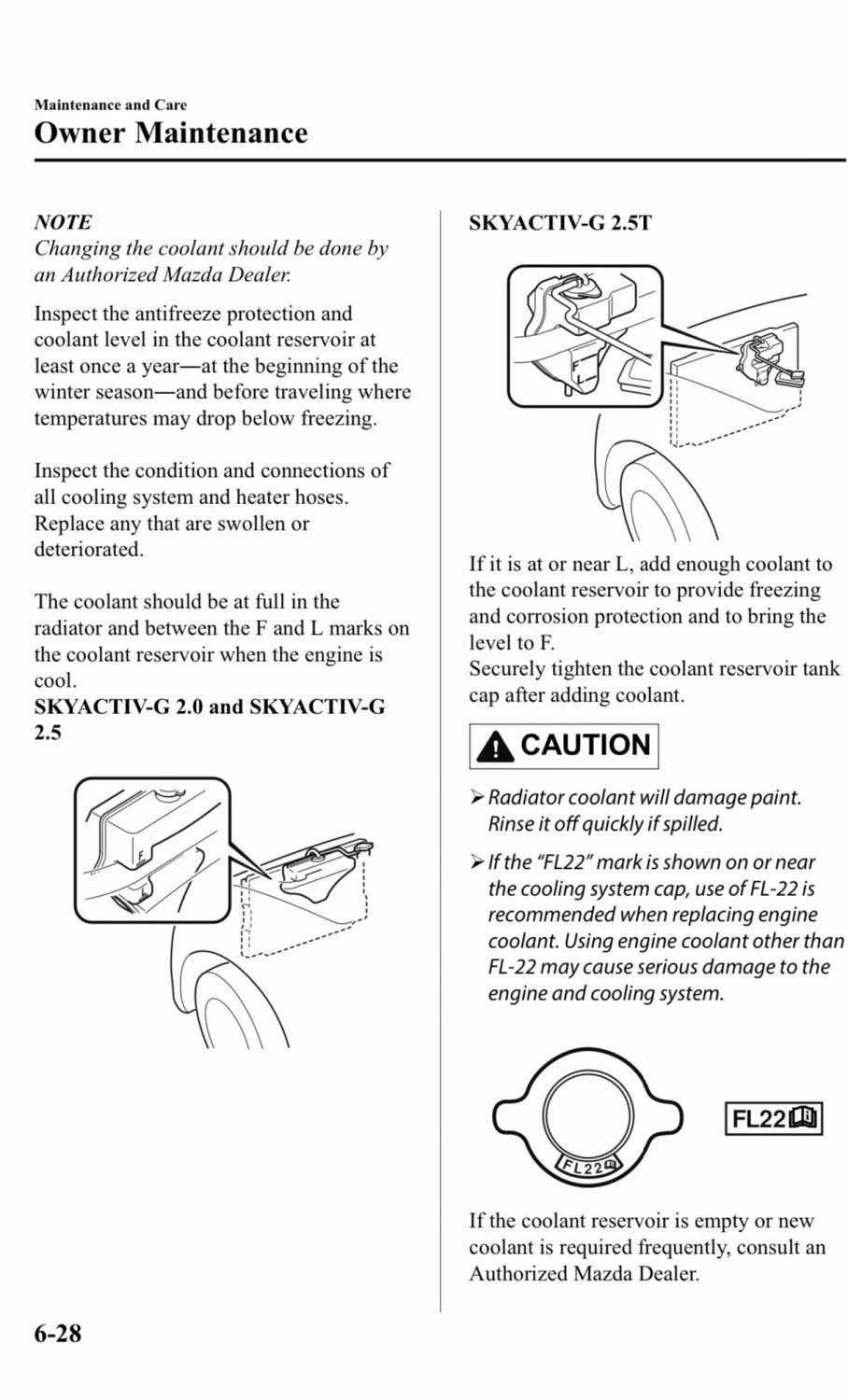

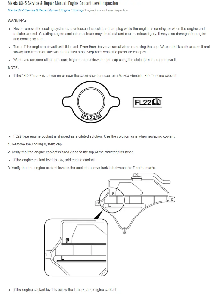

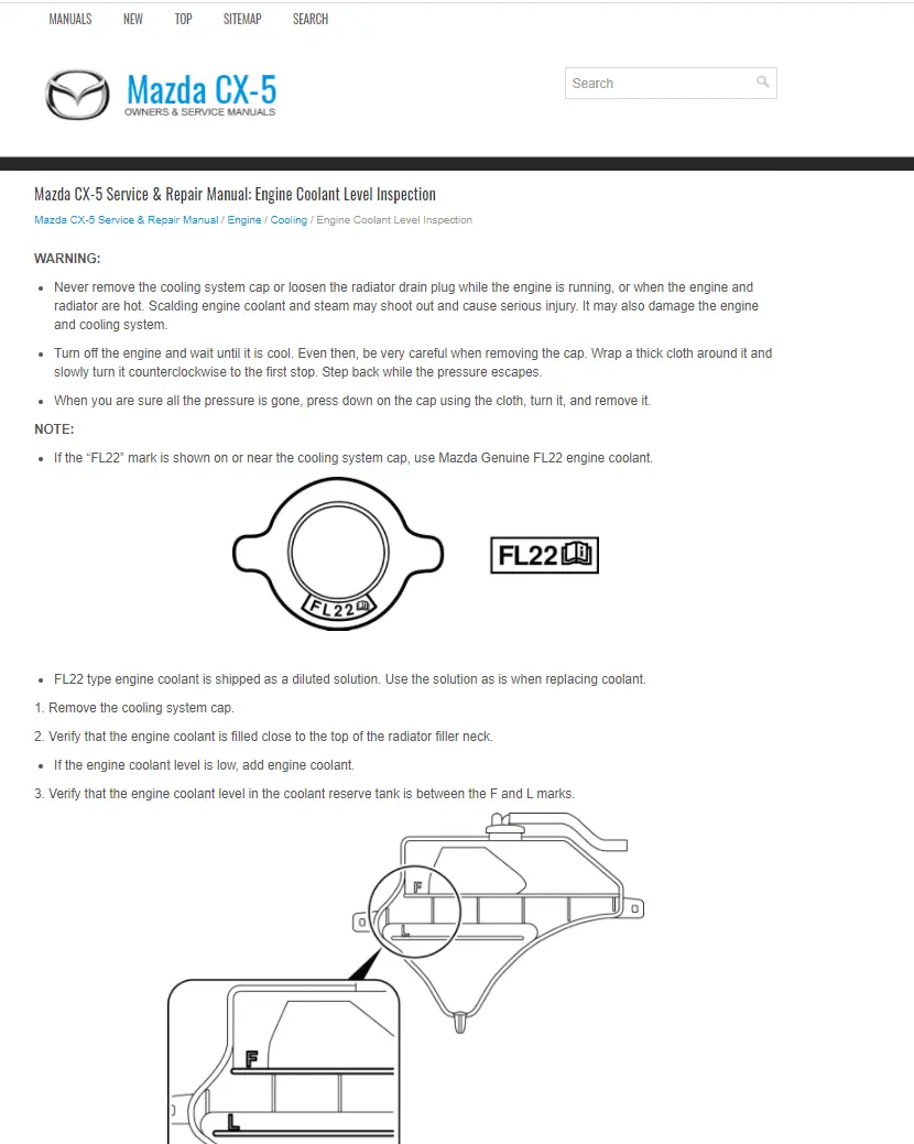

The service manual says when cool it should be between L and F, if below L, add coolant. I would add coolant until it reaches "full". There's a significant amount of volume in the tank above the L line, probably greater than the volume betwen L and F. So even if there is that much difference between cold and hot, It shouldn't be an overflow risk.
Like topping off the engine oil to bring the level to MAX, the owner’s manual says:
“If it is at or near L, add enough coolant to the coolant reservoir to provide freezing and corrosion protection and to bring the level to F.
I ordered some coolant and stopped by Mazda today. I watched the tech pour in OEM Mazda Coolant FL22. All is good now, and I’ll have a jug to top off in the future!
