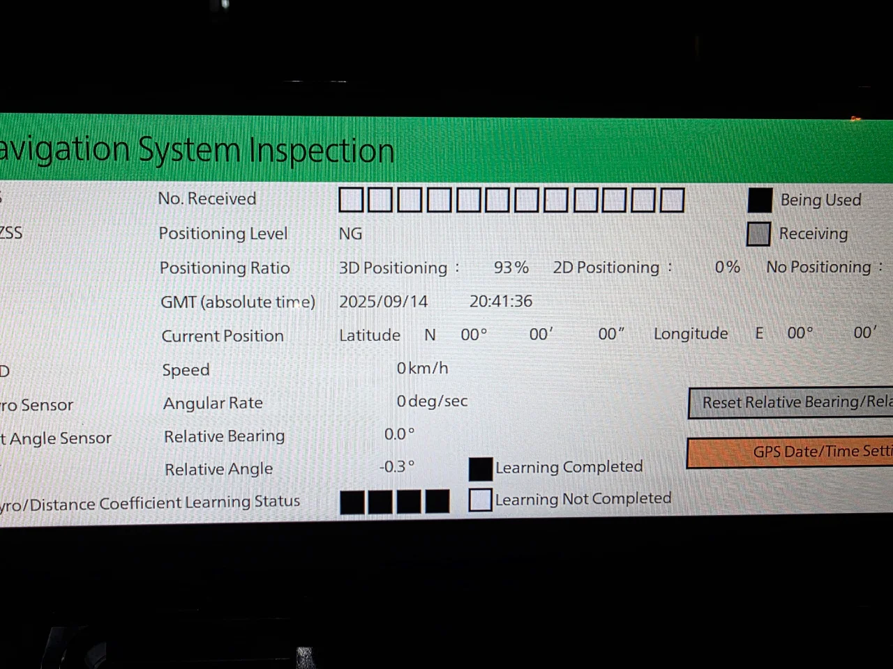

Hi bro! I have had the same problem starting from yesterday. I'm also from Ukraine. I changed the date from the Engineering Menu in the chapter related to Navigation. When the display rebooted, I could access Android Auto. But after the engine was stopped, the problem turned back.

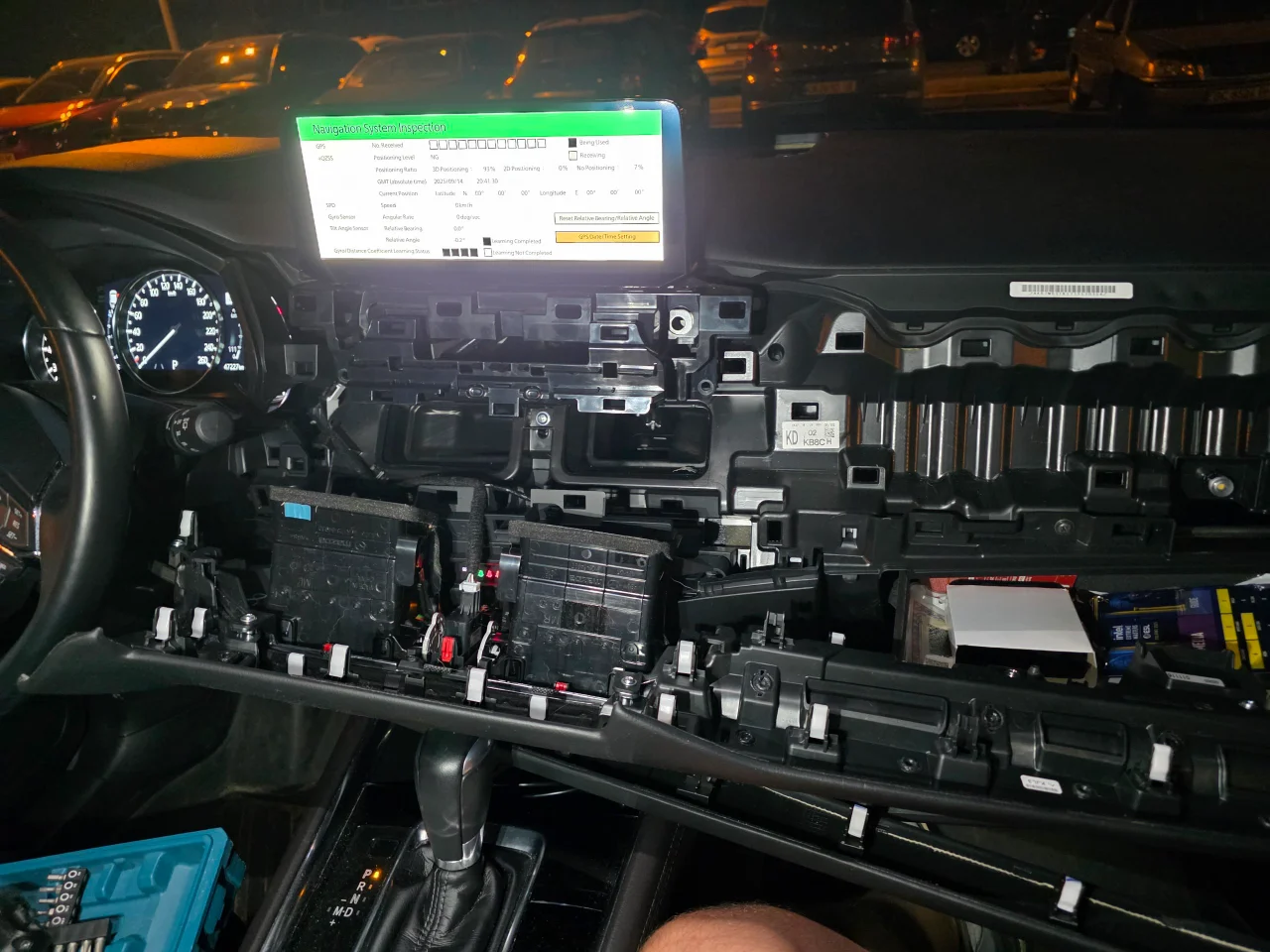

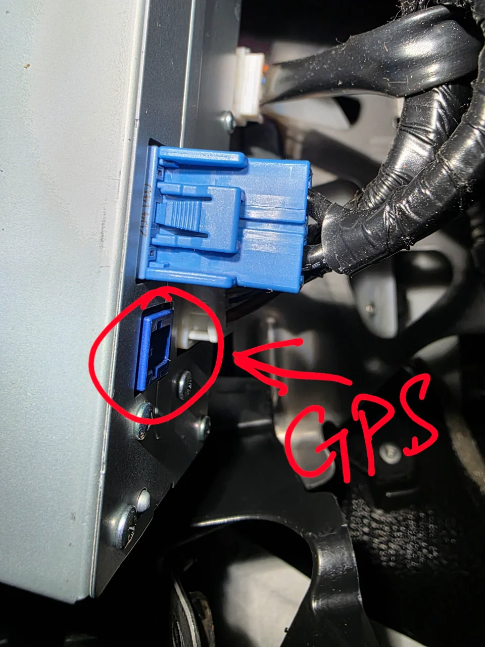

Hey guys) Found your question while searching for solution of the same problem. Did all the actions as well before that, so it was a little bit of a time waste :D
Only workaround for now I've come up with is to disconnect the GPS antenna temporarily. For me it's not a big deal - Gmaps and Waze are much more important. It could be done in like 15 minutes or so.
1. Remove to dashboard panels (as shown in the video).
2. Remove two philips (cross) screws holding the screen and infotainment system - it's on the same video.
3. Remove two bolts with 10mm heads holding the screen and infotainment system - it's on the same video.
4. Take the infotainment out, and disconnect the small blue connector (should be on the right hand). There are variations of it's position but connector itself is the same - blue one 1cm*1cm.
5. Before putting all together turn on the ignition and enter service mode on infotainment. First push and hold the Mute, then press and hold Favorites, then press and hold Media (note icon). You should hold all three together for 5sec. Go to Functional inspection/Adjustment - Navigation System Inspection - GPS Date/Time Setting. Done)

@daemonkor — I really appreciate your input. I also tried through the Engineering Menu, same result as you: it works until the next engine restart, then everything goes back to 2045. Hopefully, Mazda official service will provide an official fix.
@pioneer_ma — your method really saved me! 🙌 I followed your instructions step by step and Android Auto is finally working again. Huge respect for sharing this — I’ll also send it to our local Mazda CX-5 club, I’m sure it will help many people facing the same problem.
