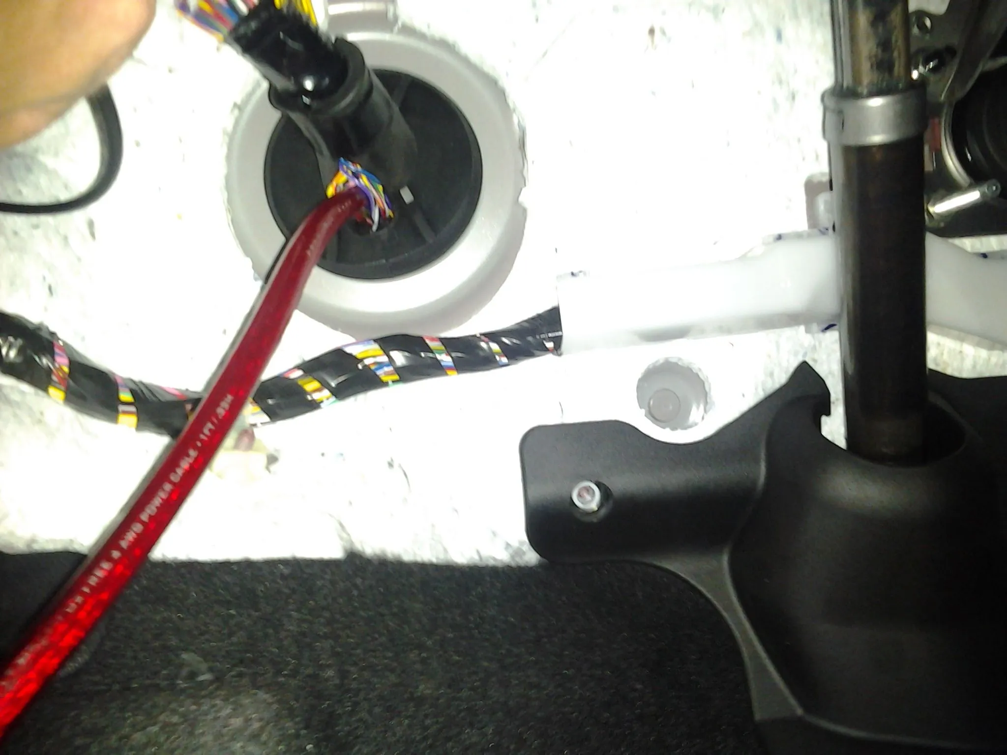

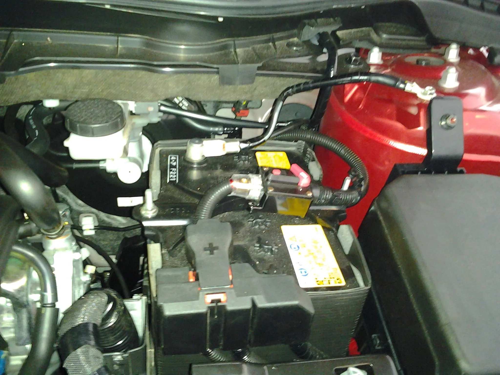

Removed the battery and ran the power wire through the grommet behind it
attachment.php
Power wire coming through the firewall on driver's side
attachment.php

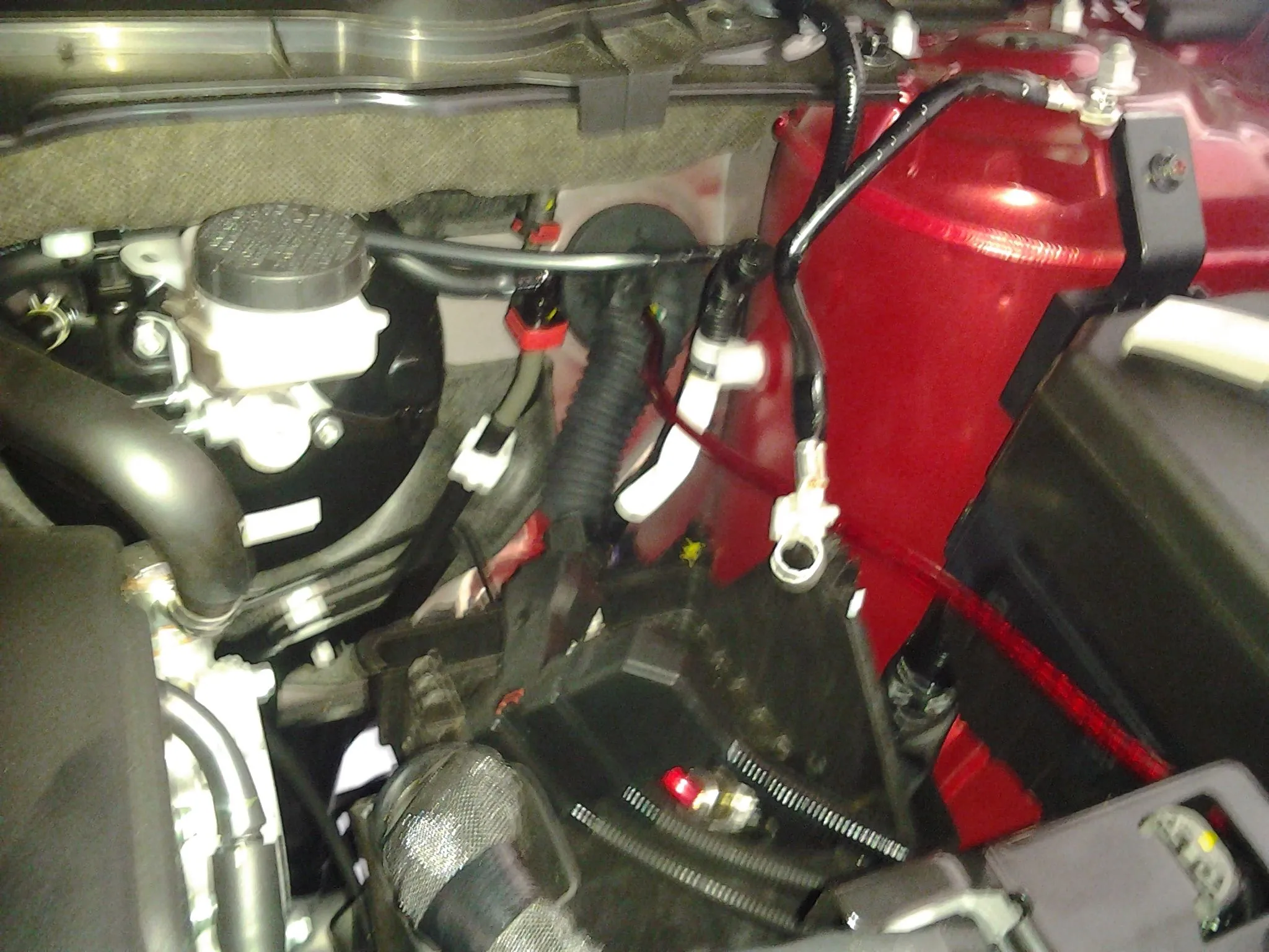

Battery reinstalled with a circuit breaker on the power wire
attachment.php

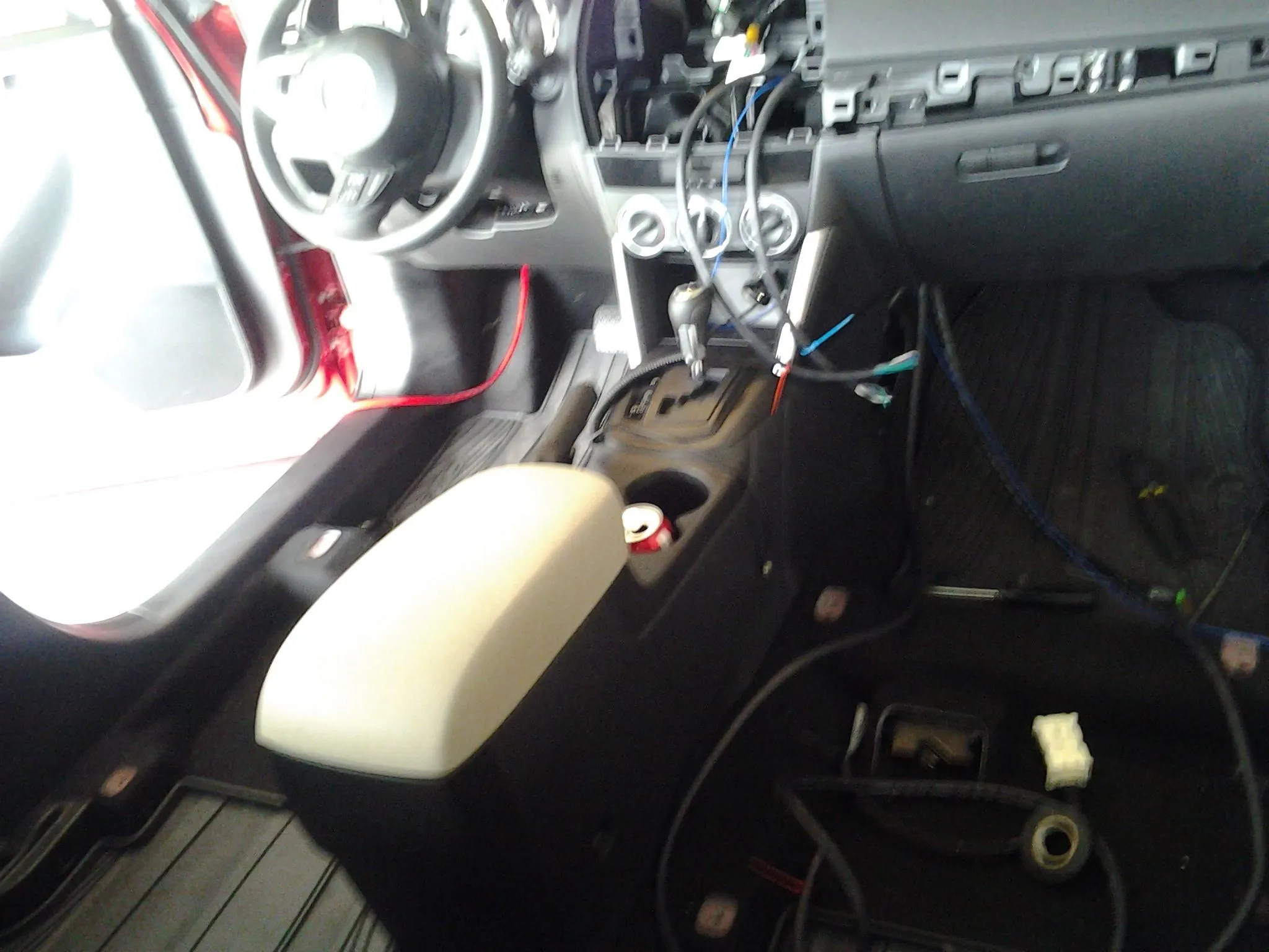

Inside the car with the seats out and wires routed. I ran one section of speed wire from the radio outputs to the LC6i and another set from the amp up to the factory wires. The fat black wires hanging out where the radio should be is the speed wire.

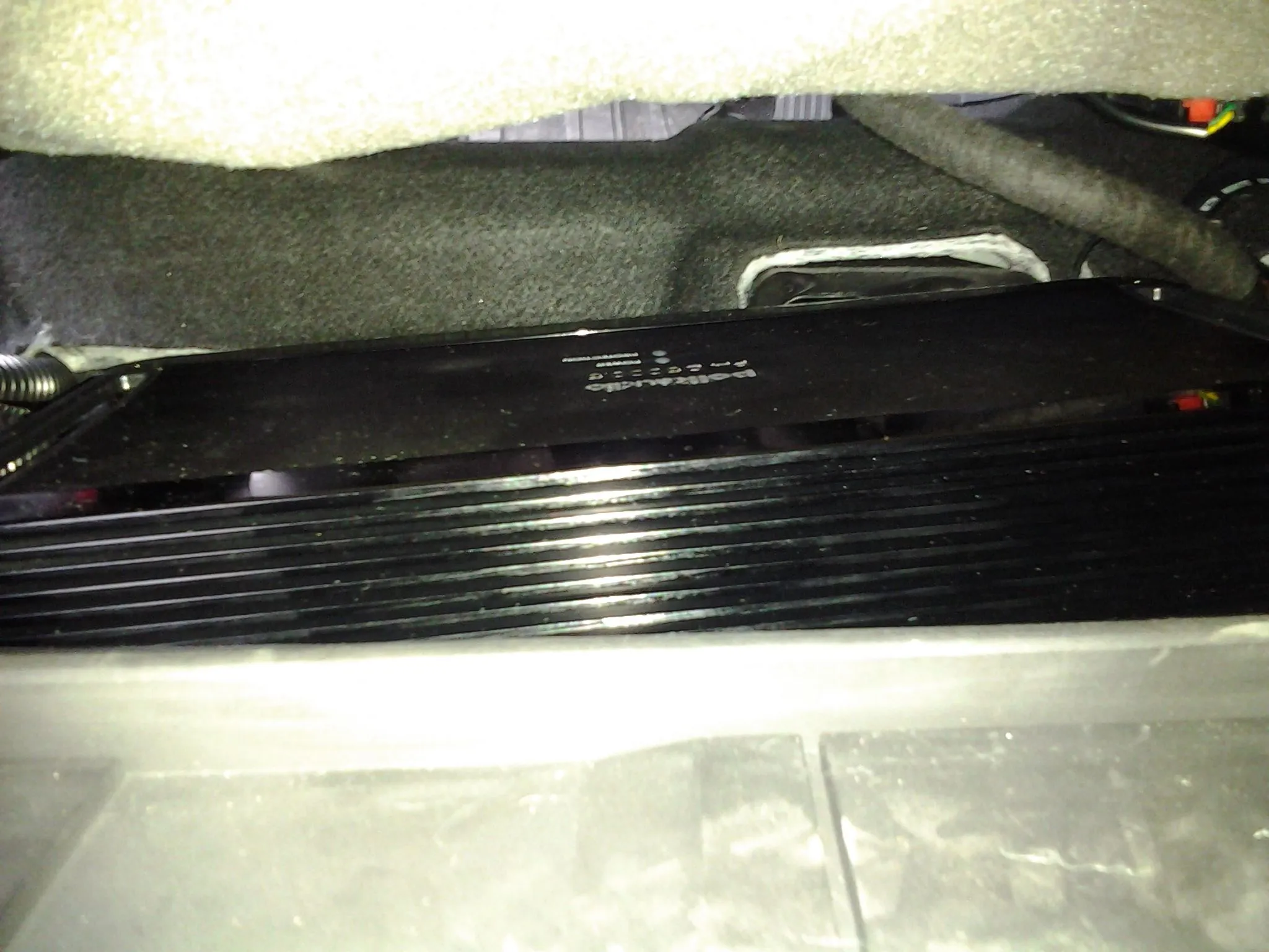

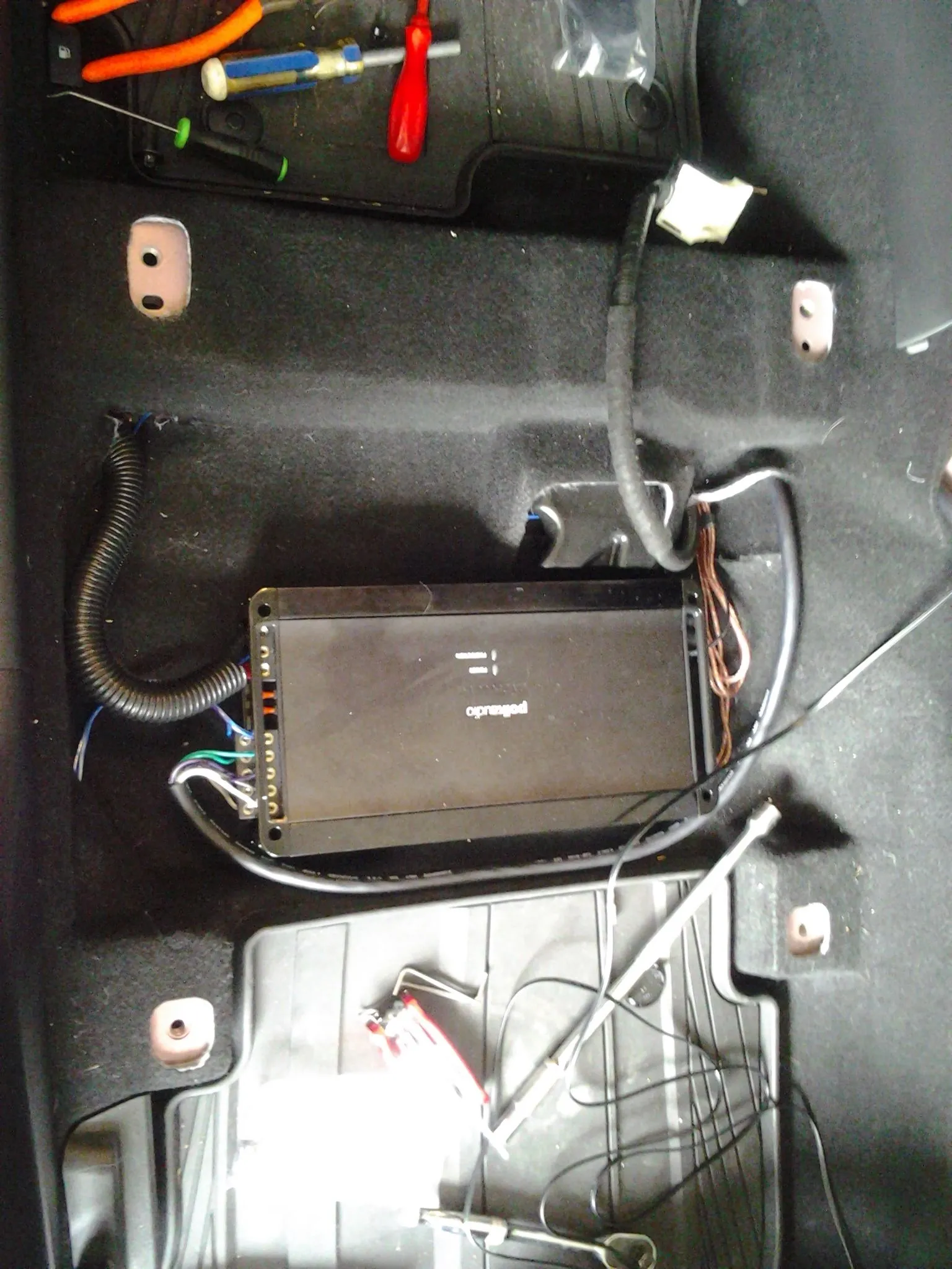

Amp wired and mounted under driver's seat. Instead of using screws I mounted the amp and LOC to the carpet with velcro tape so I can move them to adjust without removing the seats. The hook side is stuck to the amp and it grips the carpet like it was made for it.
attachment.php

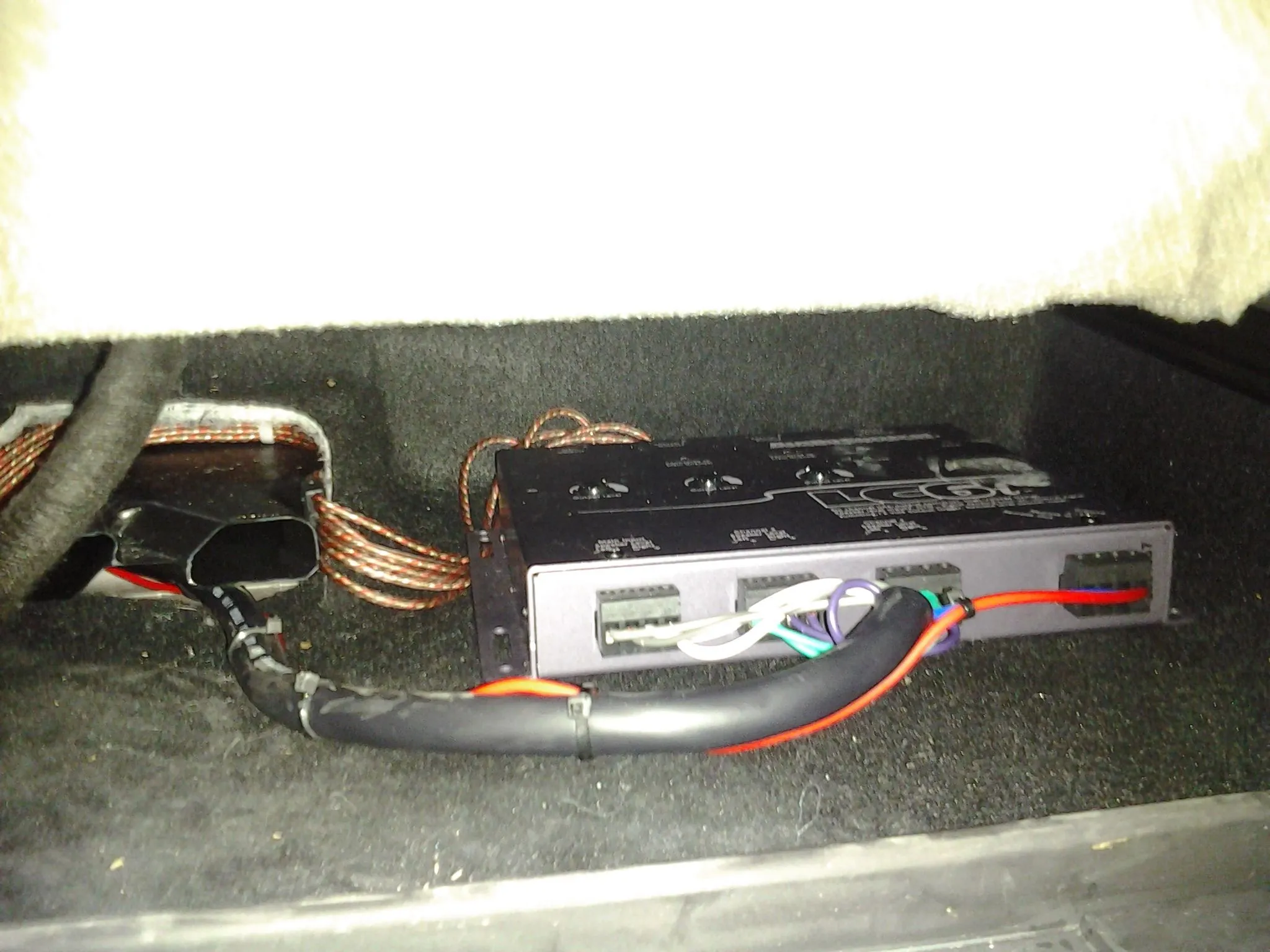

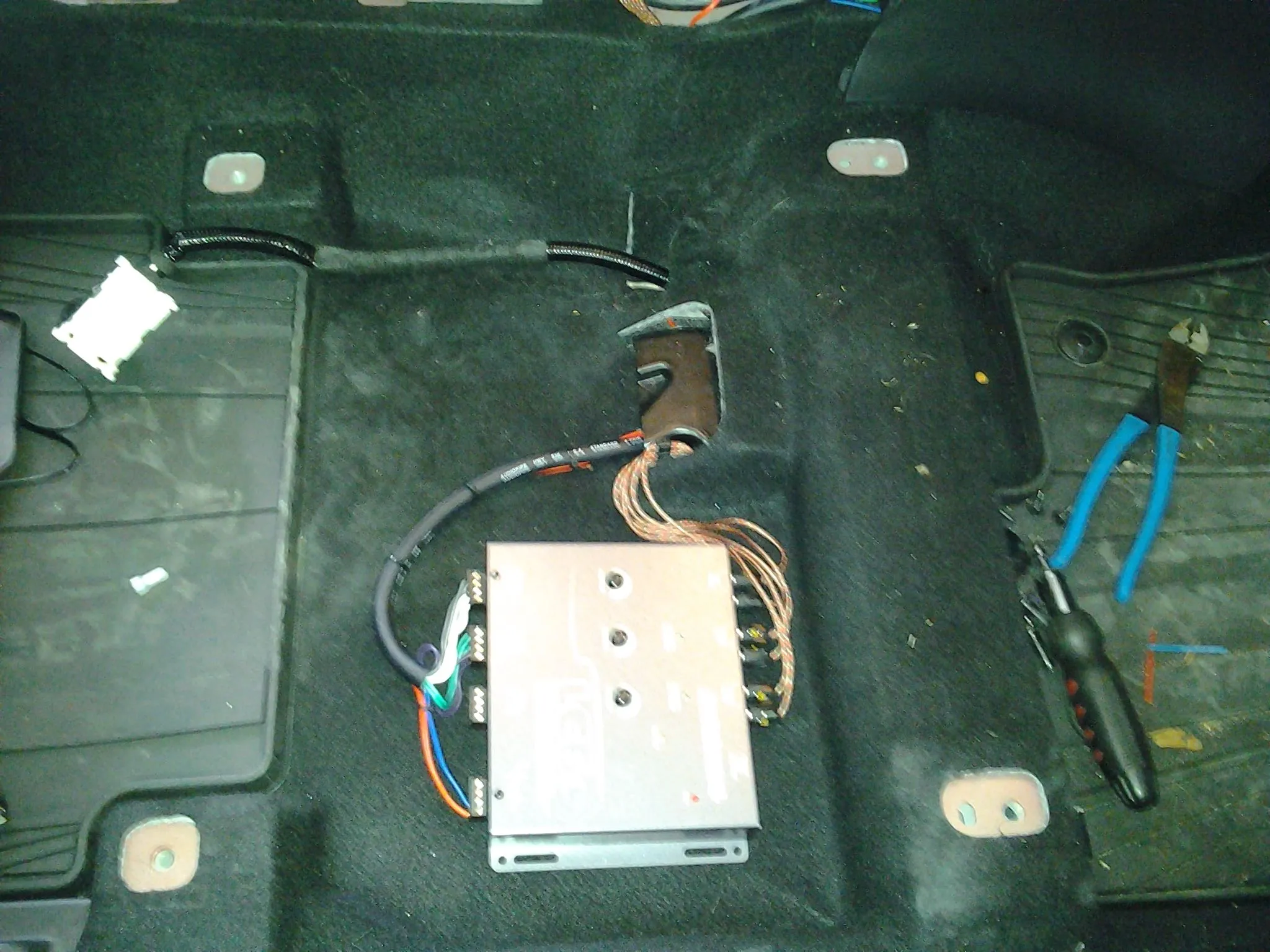

Line output converter hooked up under the passenger seat and mounted with velcro
attachment.php

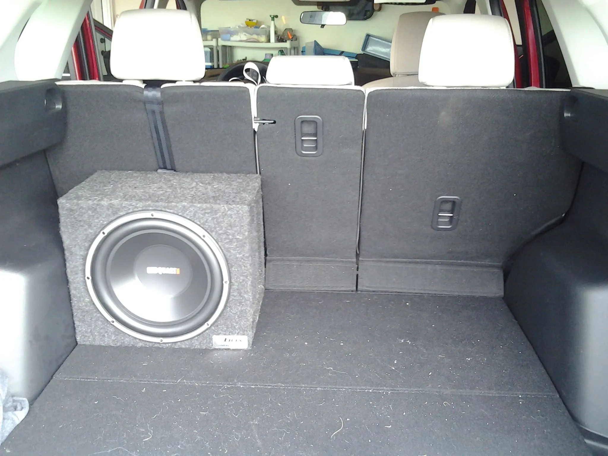

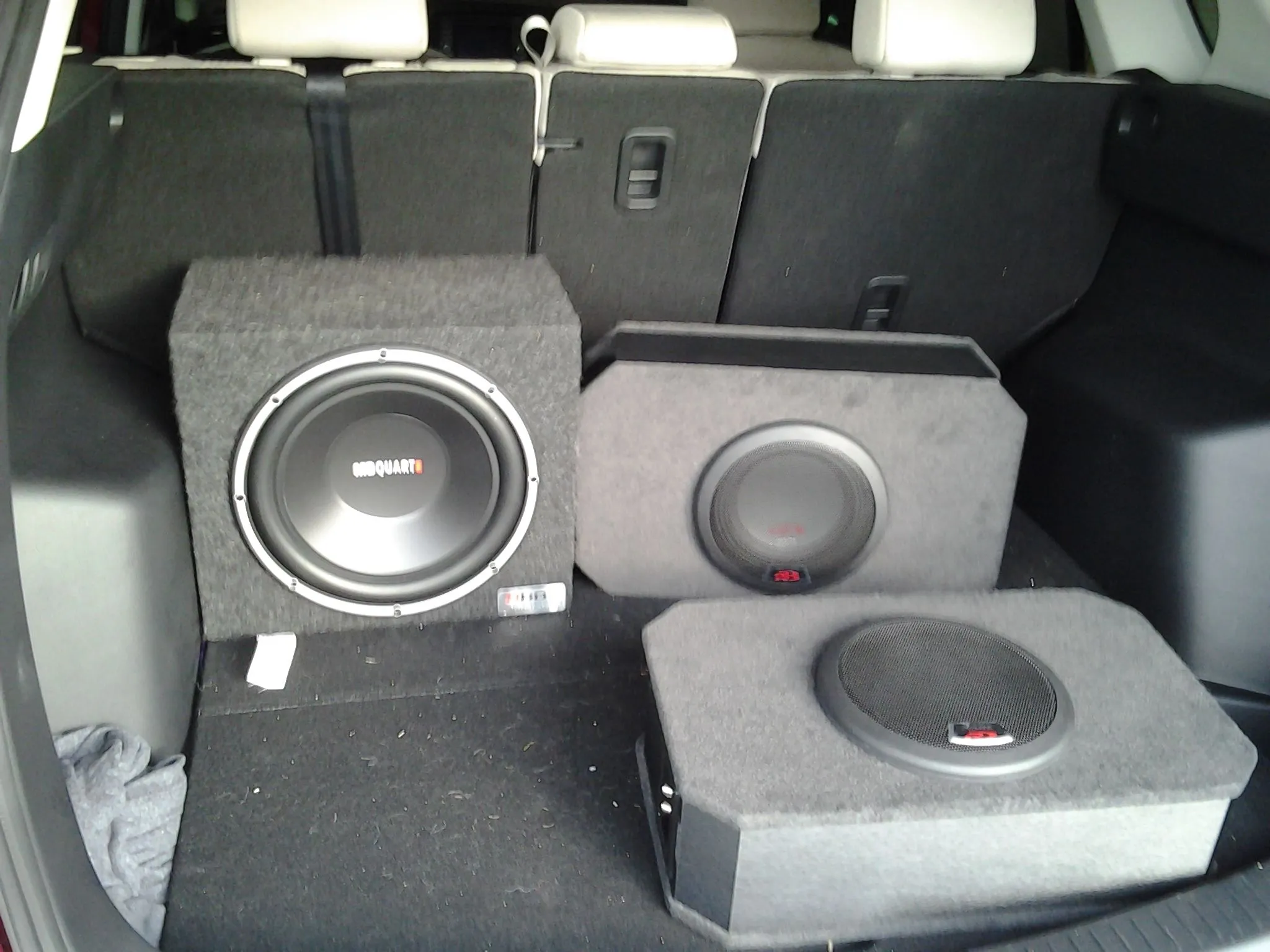

Subwoofer in the trunk, MB Quart dual 2ohm voice coil running at 1ohm
attachment.php
LOC after the seat was put back in (view from backseat)
attachment.php
amp viewed from back seat after seat was reinstalled
attachment.php

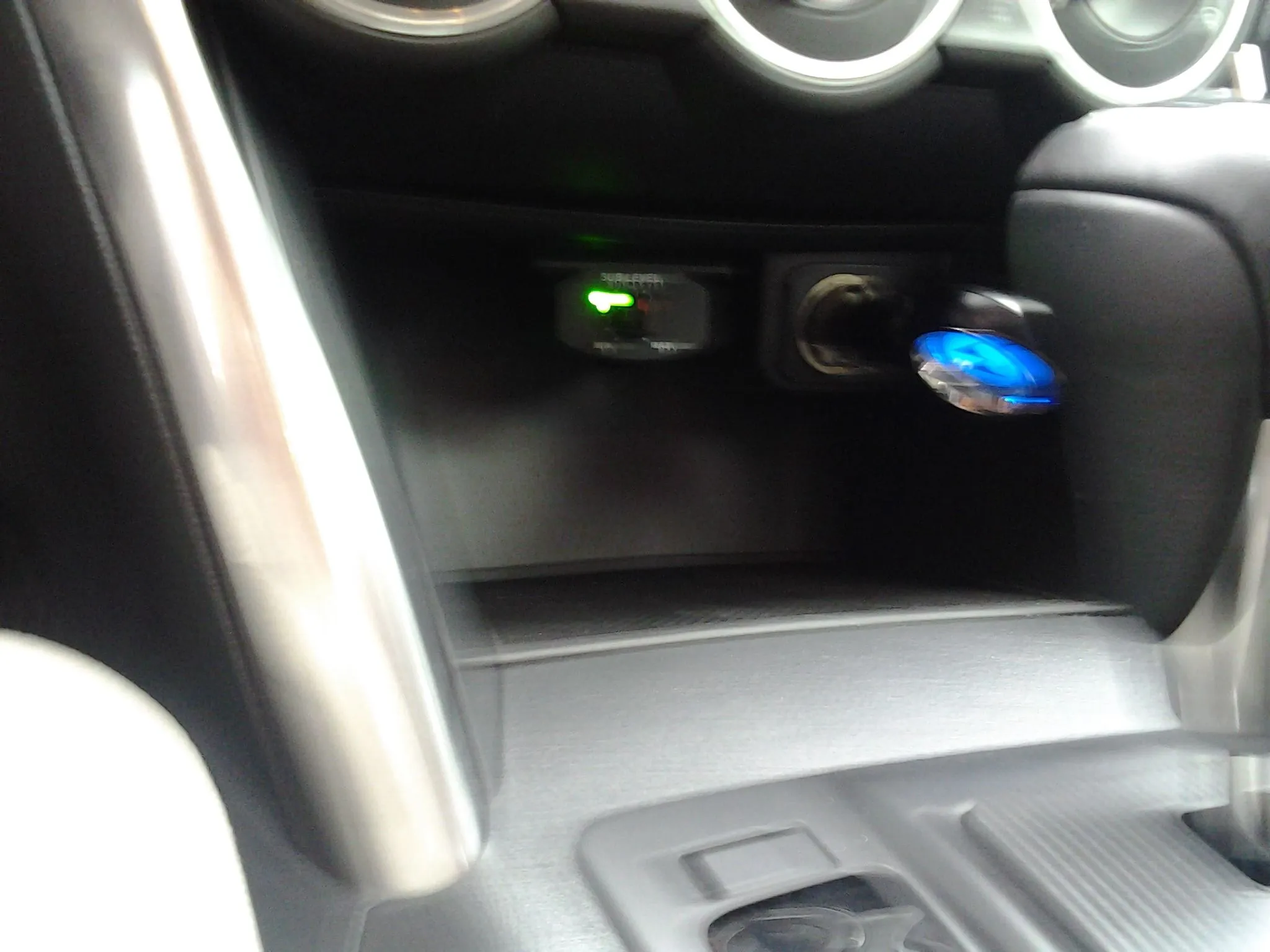

Remote gain knob mounted in cubby
attachment.php

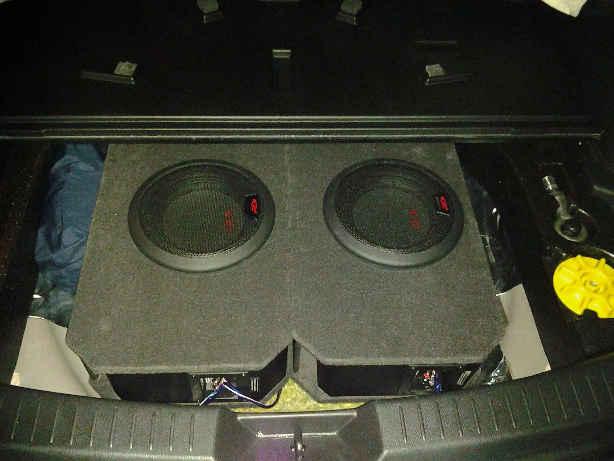

So my subs, focals, and RAAMMAT came in today. I won't have time to change the speakers or put on the sound deadener until this weekend. For now I put in the subs, they fit perfectly. Here are a few pictures, I will pull them out tomorrow and put RAAMMAT all over the floor under them. Sound wise the 2 ported 8" subs are louder than the sealed 12" but don't go as low. The alpines are 300w RMS and 2ohms each. My amp puts out 500w at 1ohm so each sub is getting 250w. I will do more tuning after everything is in and report more on sound.
Old sub compared to the new subs
attachment.php

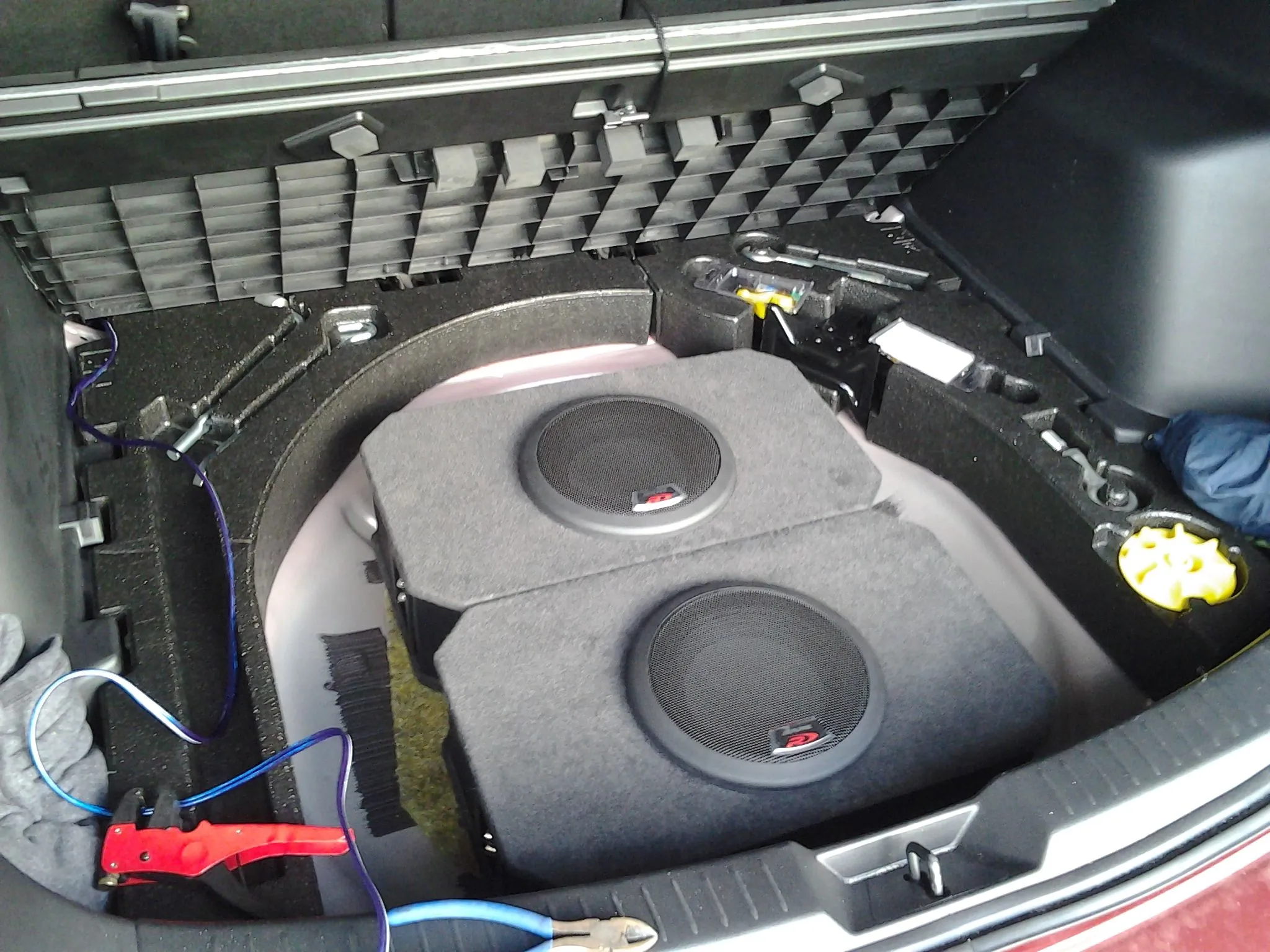

New subs where the spare should be, they fit perfectly and there is about 1/2" of space between them and the floor. Still room in the well for the air compressor and tire plug kit I have in case of a flat. Mazda built a hook into the plastic floor that hooks onto the back of the seat and holds it all up, very nice.
attachment.php

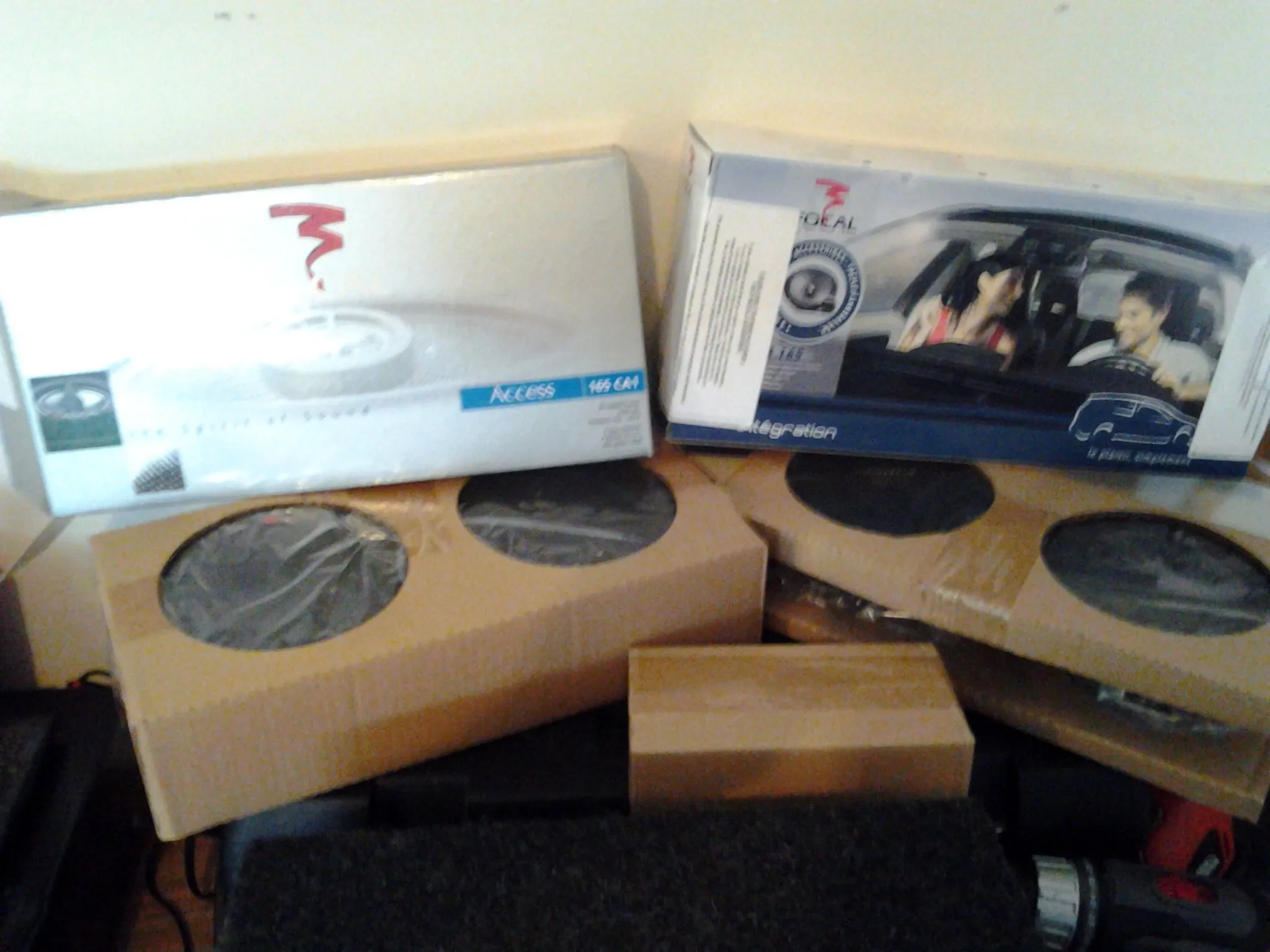

2 pairs of focals waiting to be put in

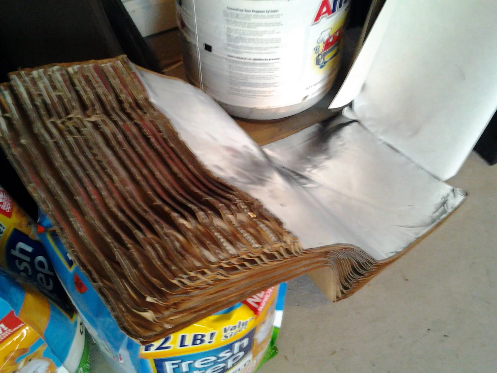

RAAMMAT waiting to be put in. Quality seems comparable to DYNAMAT, paid around 120 shipped for enough to do the whole car and some of their ensolite foam for the doors

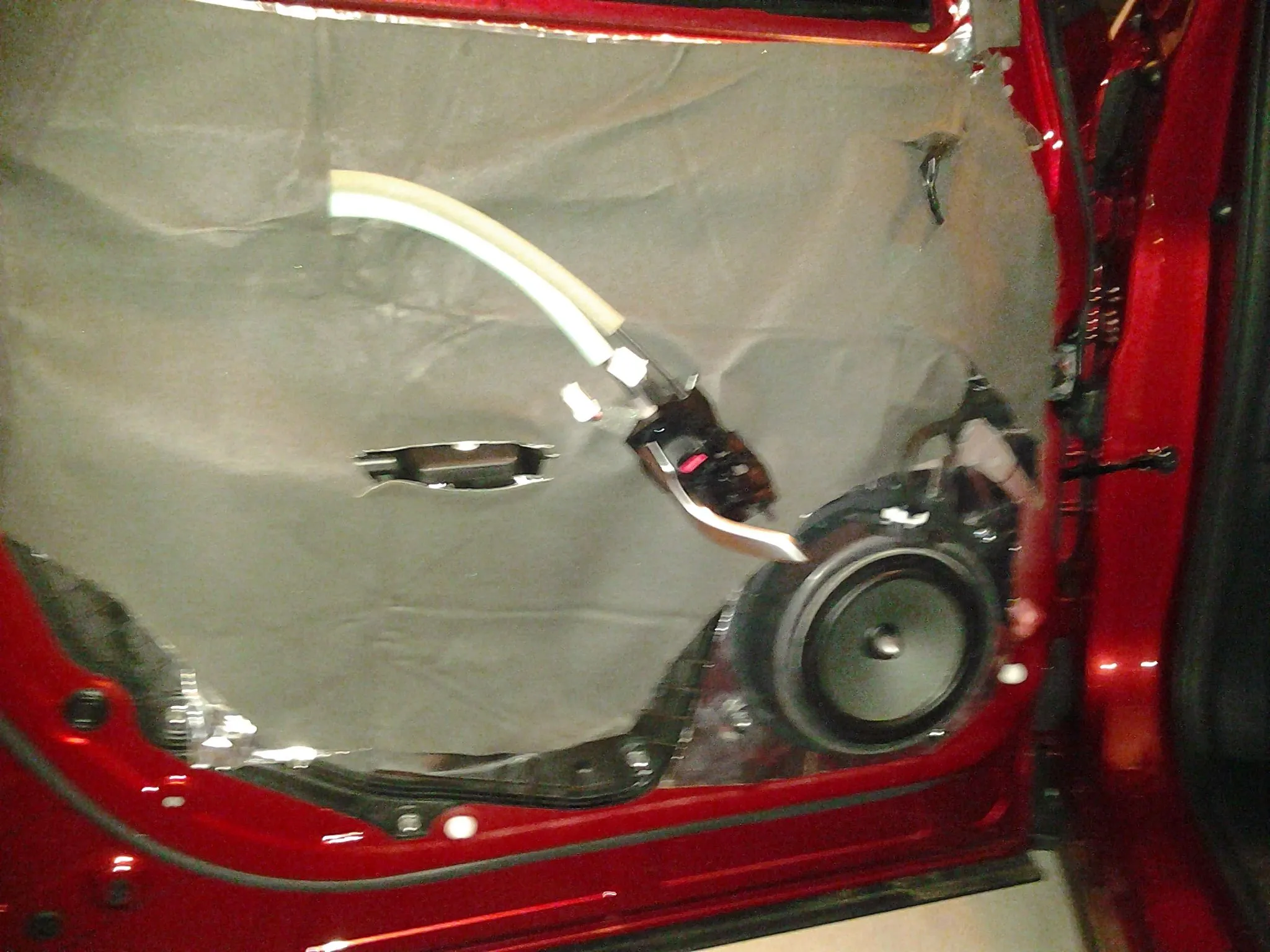

Ok so after about 8 hours and a case of beer I got everything else installed. I did the RAAMMAT on the front and rear doors, hatch and floor in the cargo area. I put the focals in the rear with screws and used the factory brackets in the front. I put the tweeters in the factory locations, and FYI if you have a touring without bose you have tweeters in the dash not 3.5" speakers. The imaging is great even with the woofers in the doors and tweeters in the dash. Overall it sounds great, I listened to 3 or 4 cd's in my driveway and am definitely impressed. NIN, Metallica, Tool, Foo Fighters all sounded superb and these are all entry level focals. The 8" subs don't hit quite as low as 12" speakers I'm used to but the 8's are very crisp and clean especially with rock music and I have all my cargo space. Can't comment on sound deadening yet since I haven't driven on the freeway but I will update when I can.

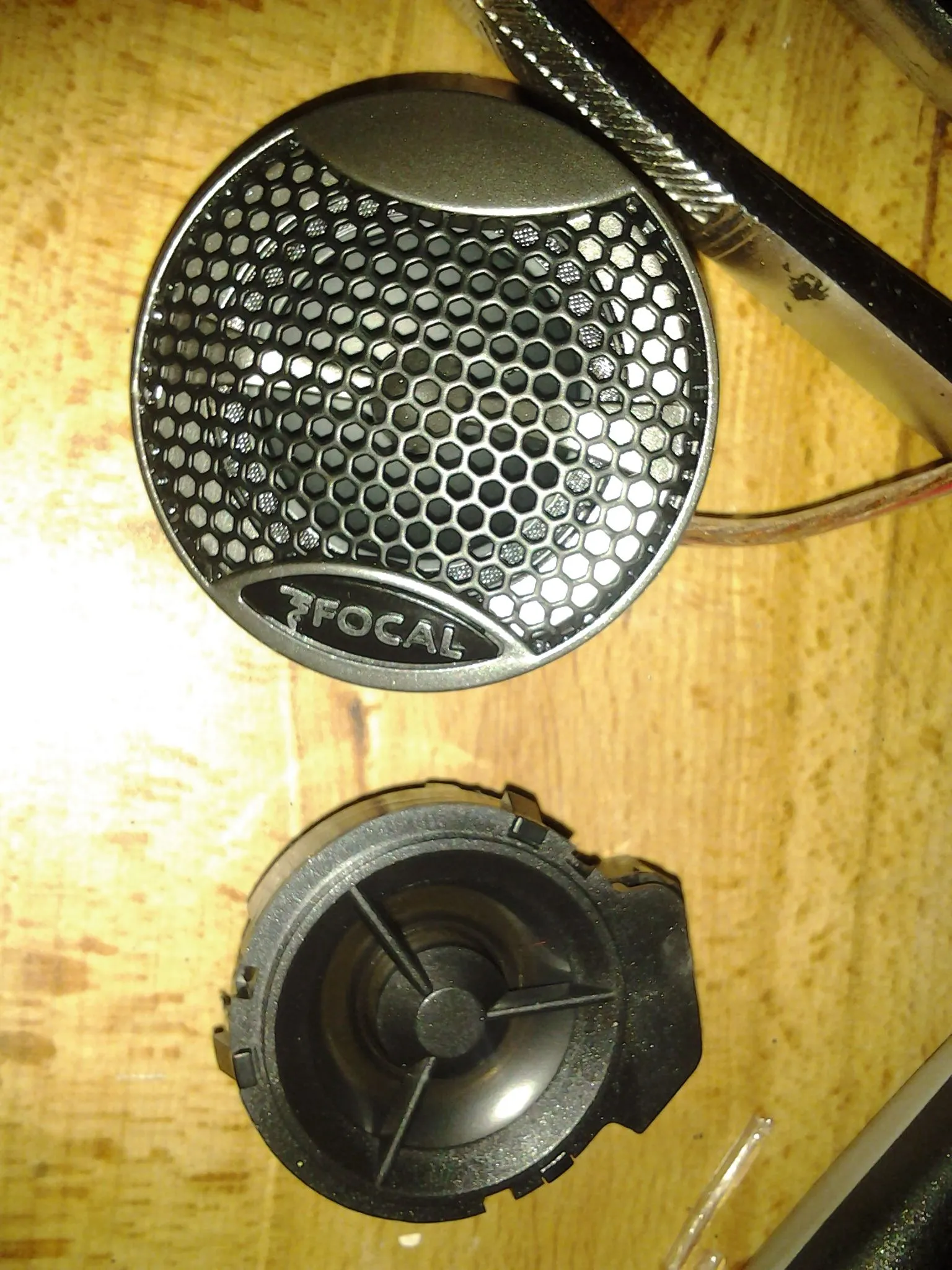

Factory tweeter vs Focal tweeter
attachment.php

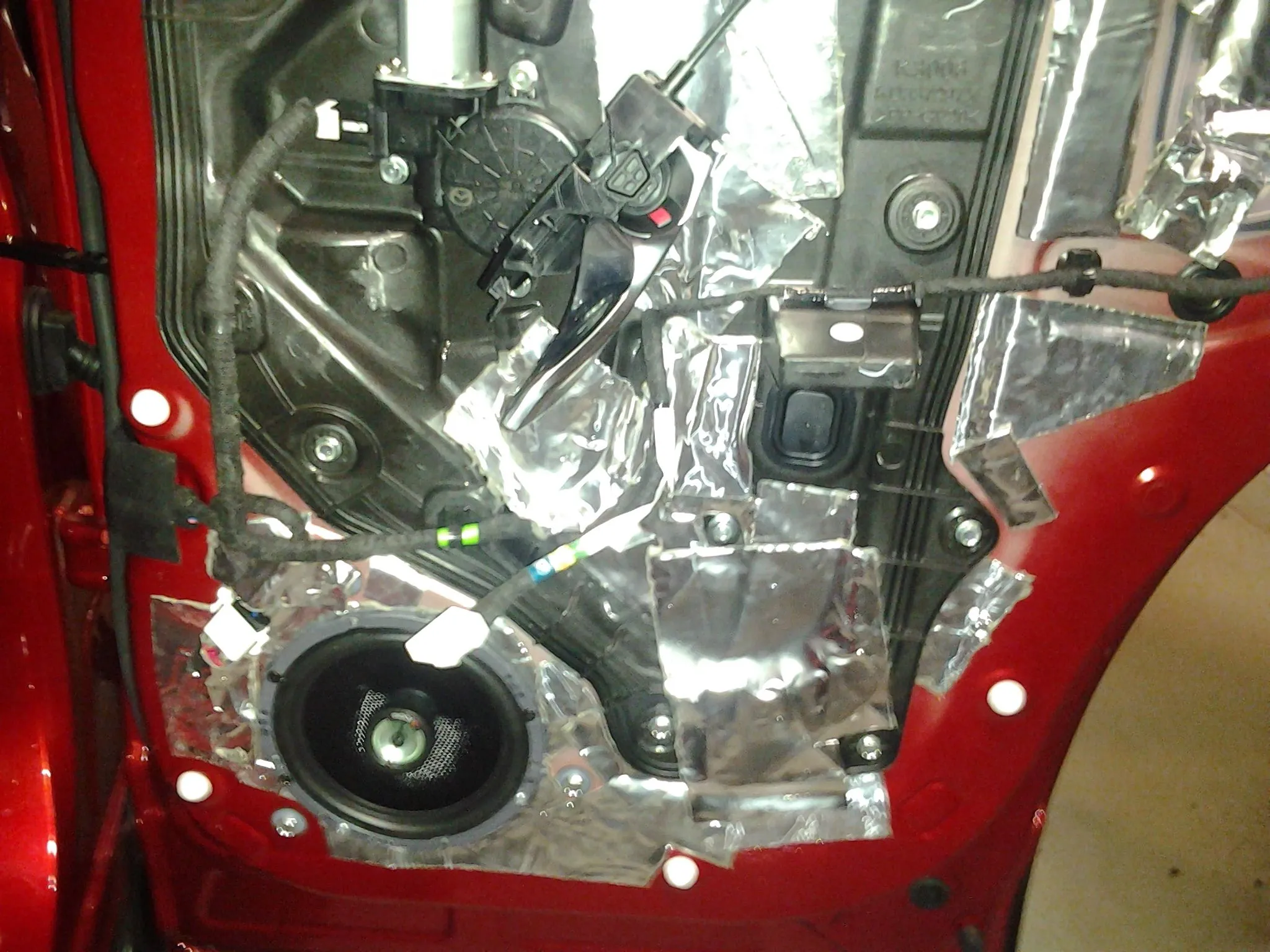

Front door speaker with RAAMMAT and Ensolite
attachment.php
attachment.php
[/QUOTE]
What's the quality like on raamat? I have hushmat on my trunk lid, rear deck, rear quarter panels, and the spare wheel well. It cost about $100 I think. I'm trying to find a cheaper alternative that has comparable results. I want enough to cover all four of my doors and maybe some for the panels themselves. Thanks in advance.
