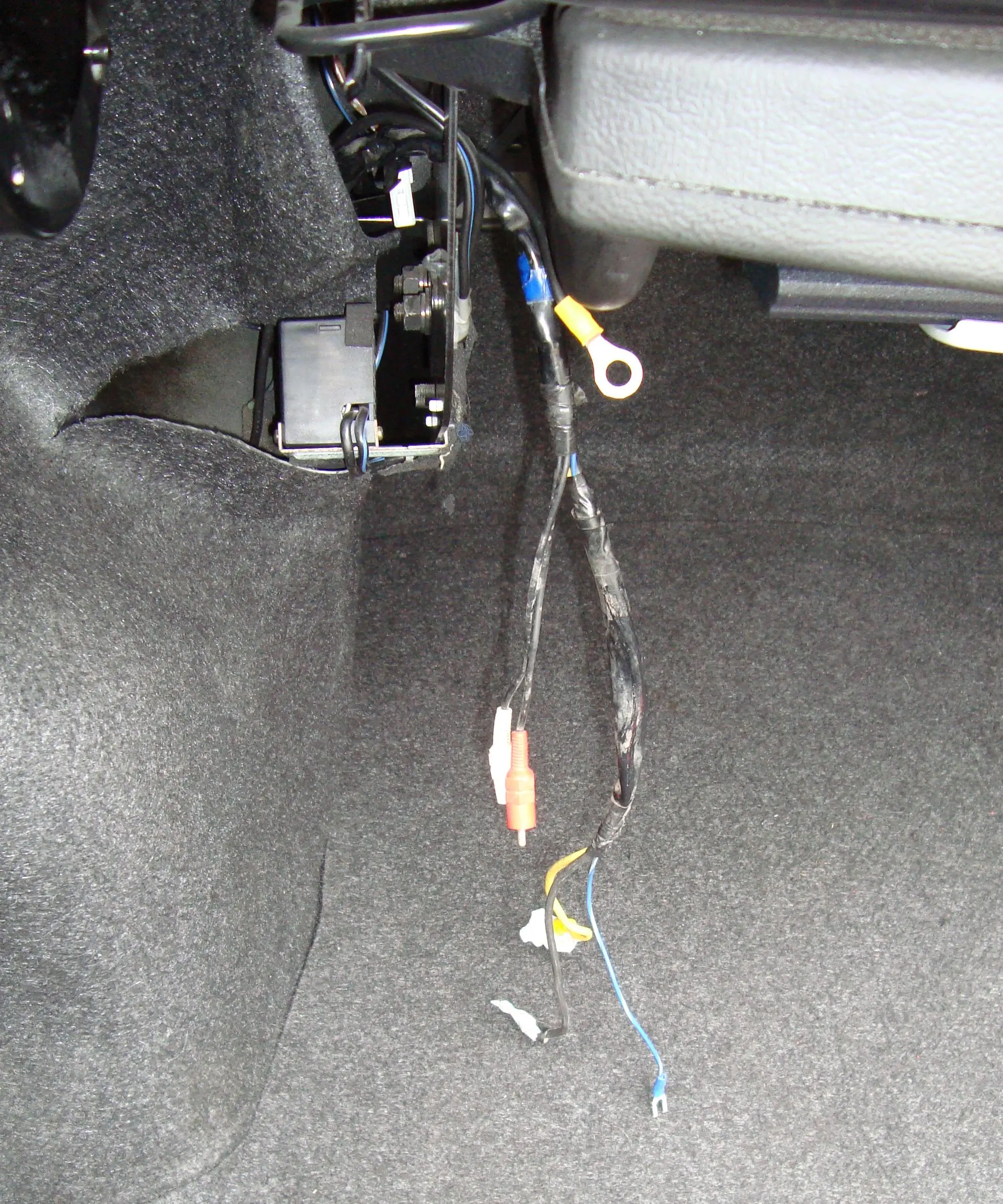

hi, anyone know what it everyone of this amp wires.

yeah those are the amp wires. there will be a power, a ground, a wire to turn the amp on (probably blue in color). And there are the two RCA cables for sound
i suppose the yellow is power, black ground and blue it's to turn the amp on like you said, and the one that is in the top with the round conector?
that's normally used to ground as well. Maybe the other end of the ground wire at amp end of wiring mess?

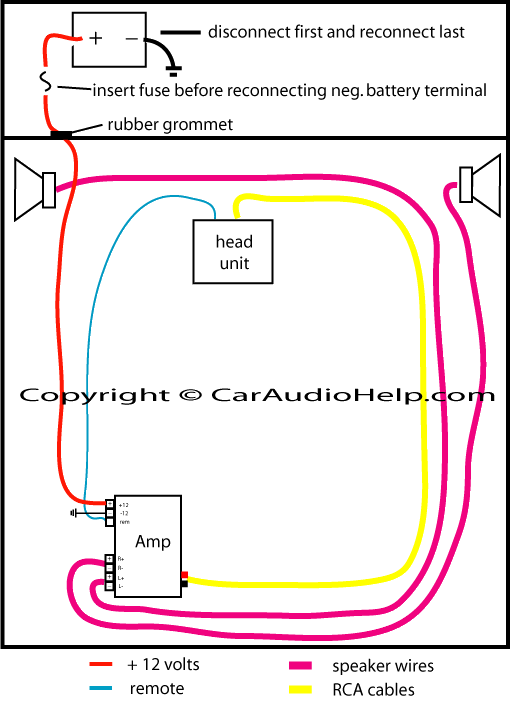

Right idea here but colors are wrong. in your case the blue wire would be correct on this but your yellow wire is more than likely the + lead off battery(red in this image) and the yellow leads in this picture are actually the 2 audio plugs in your picture. Man, I hope this makes sense. If you lived close to me I woulda been more than happy to drop by and help explain to you in person.
