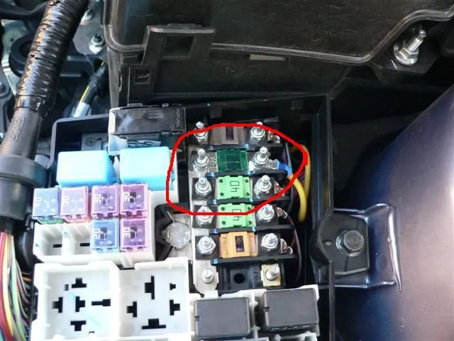

Here's a picture of the install I did for my air horns using this place.
