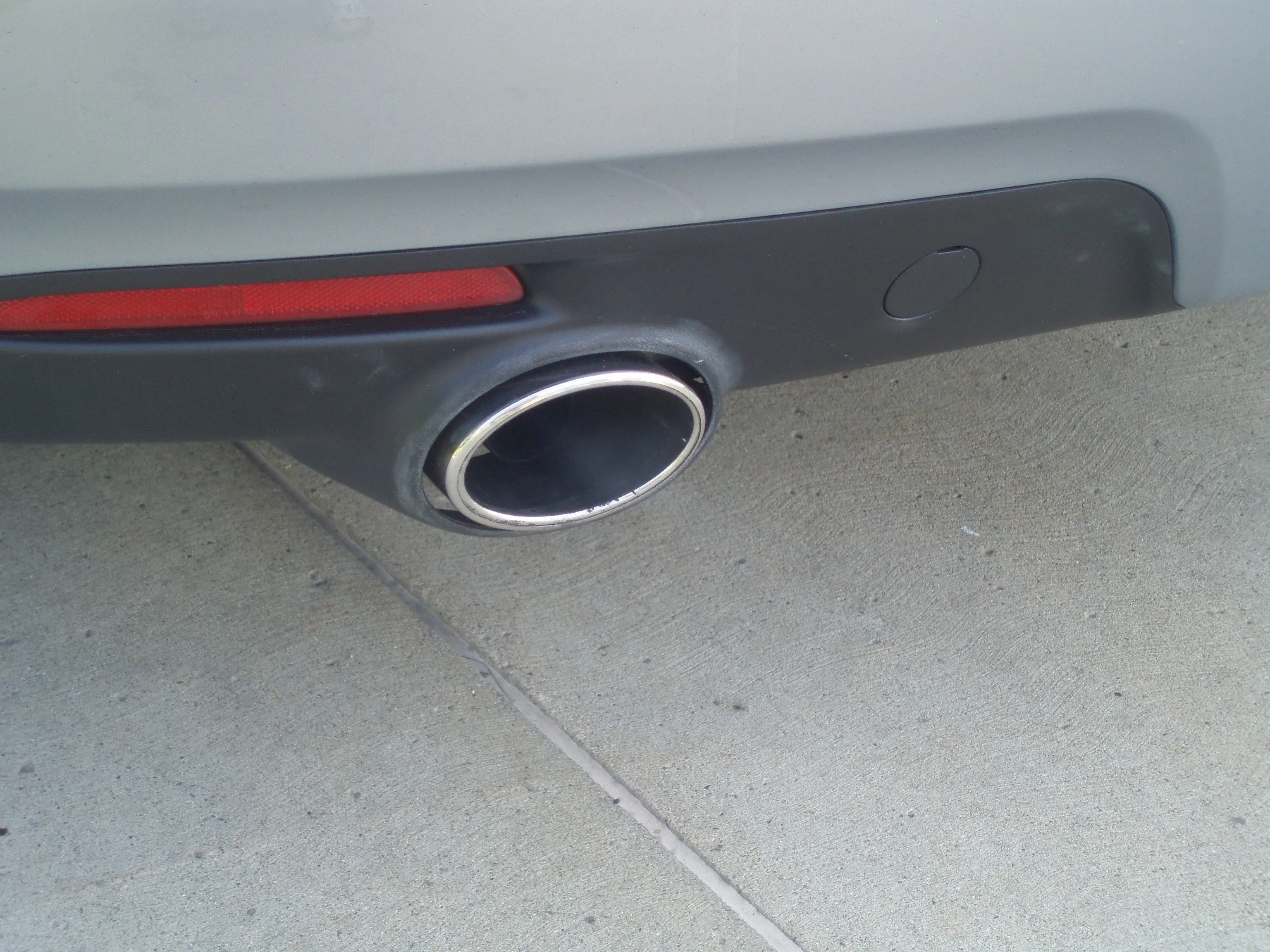

Back to stock for me today, tried to take pics of the smoking, but haven't uploaded them yet. I'll post them later hopefully. After 10 minutes doing the 'M-tip' test, it started smoking.

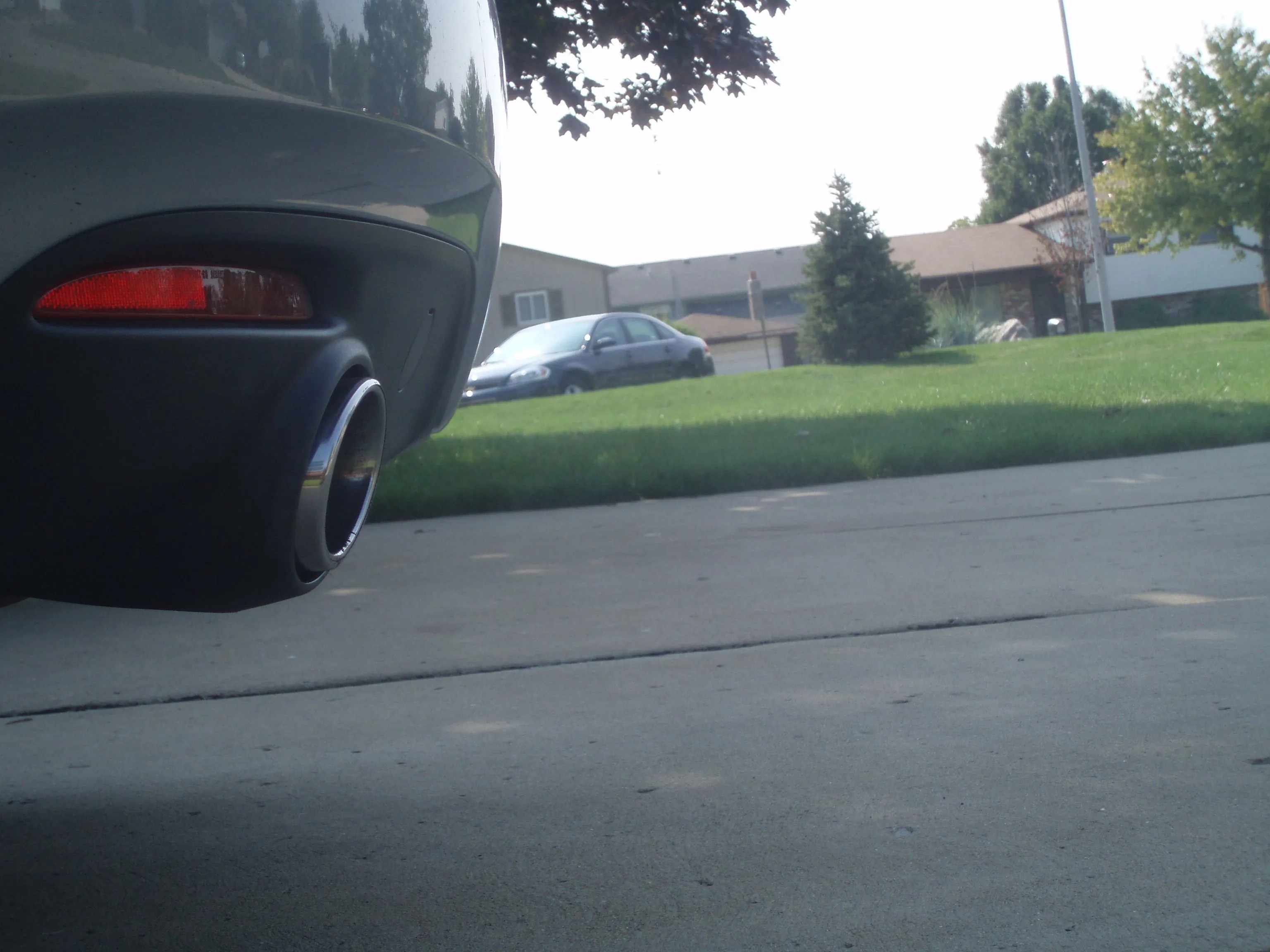

You have the exact same scenario I have. If I drive it while its smoking, it goes away, but if you let it sit, it's just faint enough to see. Here is all the info I can try and provide, it's not much, but its what I've got:
(for some reason it won't let me upload the movie)
