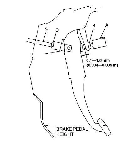

adjust the paddles?
Brake Pedal Height Adjustment
1. Disconnect the brake switch connector.
2. Loosen locknut B and turn switch A until it does
not contact the pedal.
3. Loosen locknut D and turn rod C to adjust the
height.
4. Tighten the bolt with locknut B so that clearance
between the bolt for brake light switch A and
pedal stopper is within the specification.
Specification
0.11.0 mm {0.0040.039 in}
Tightening torque
13.817.6 Nm {140180 kgfcm, 122156
inlbf}
5. Connect the brake switch connector.
6. After adjustment, inspect the pedal play and the
brake light operation.
that's the section of the service manual i found..
also, can anyone tell me how do I take the gas pedal off? What's the thing that holds it onto the bar?

I messed with clutch pedal height on some RX-7s and 626s, mainly to get the engagement point to a more comfortable level. But yeah, the brake pedals in general seem a little too high, maybe a little more on the P5. I'll see how far that rod is threaded and drop mine if possible. Thanks.

Well...hmmm. My brake pedal is already as far down as it will go. It would take "modification" to drop it more, and the safety aspects of doing that. (I may yet mess with this) However, I did drop my clutch pedal. It's now roughly level with the brake. Looking at Nomad's, above, his clutch looks to be a good bit lower than the brake? Or higher - I can't tell for sure. I'm thinking that I do have to clutch far more times than brake, so at least I did accomplish something.
IF YOU DO THIS: remember to keep free play in the clutch lest you wear out the throw out bearing from constant slight pressure. And as the clutch wears, play gets taken up. So better a little more play than too little (observe the play before you adjust it to get a rough idea of what I'm saying). The hydraulic master cylinder may make this a bit of a moot point if you think about it? Also, there's a switch, I think for the cruise, that might be influenced by dropping it enough - so keep that in mind. You can pull the connector and meter it for continuity, or just wait and road test it. Lastly, it might be possible to drop it so far that full and reliable clutch engagement isn't possible. So, if shifts start clashing...
