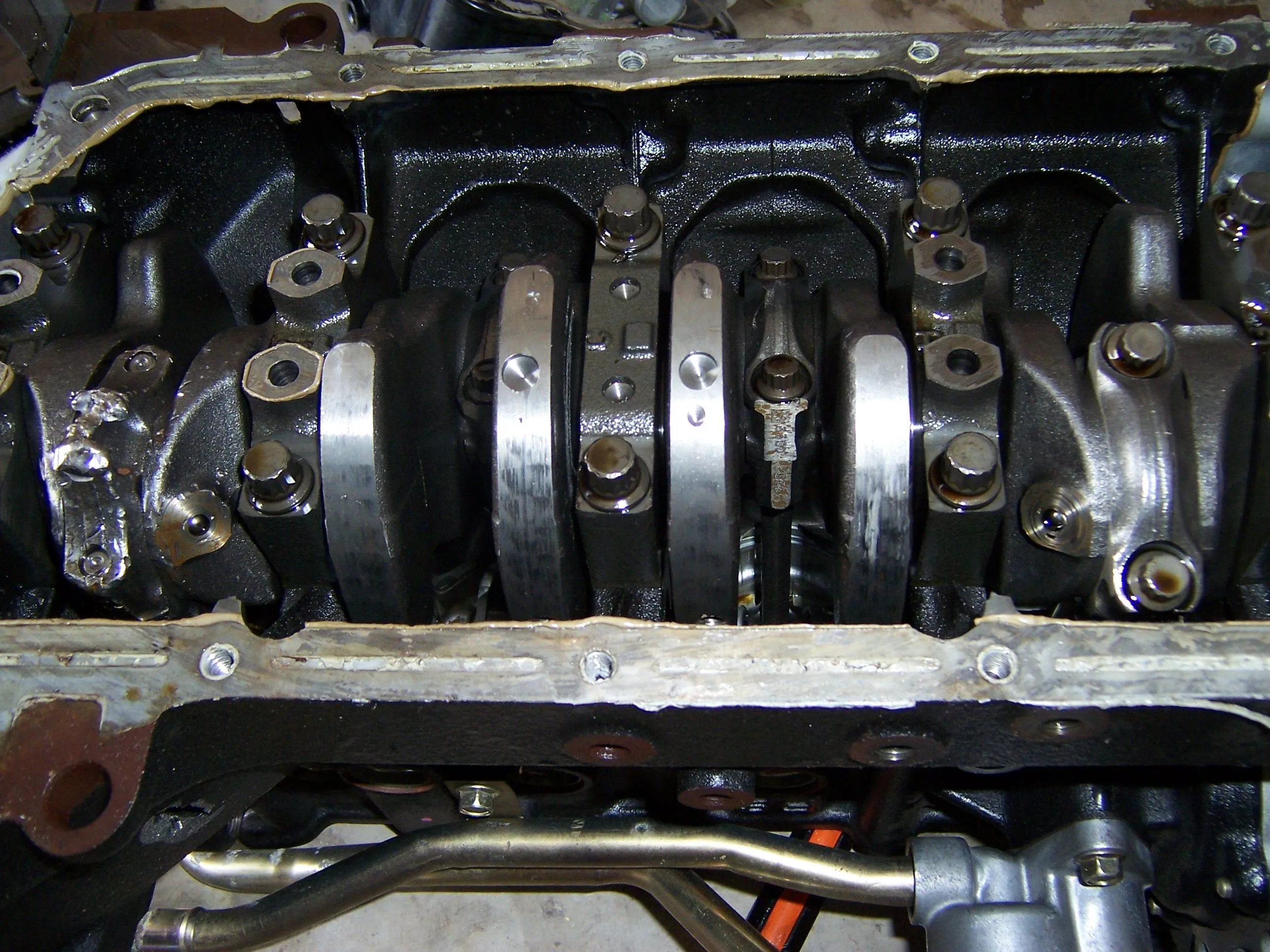

My car was running pretty good with the Mpi and extra injectors. Sam tuned it several times and i caught on and tuned it alittle more for that 13.9 103.88 run . I overpowered a rod though .
This was at 11 psi on street tires and a dam 2.3 60 ft . I coul dhavbe gone 13.5 or lower with slicks .
