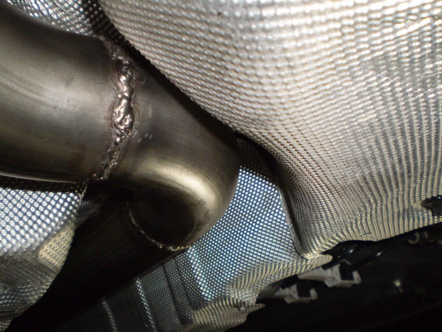

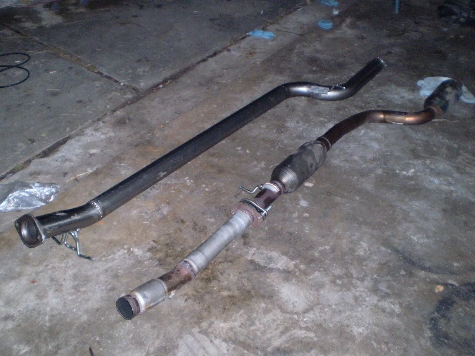

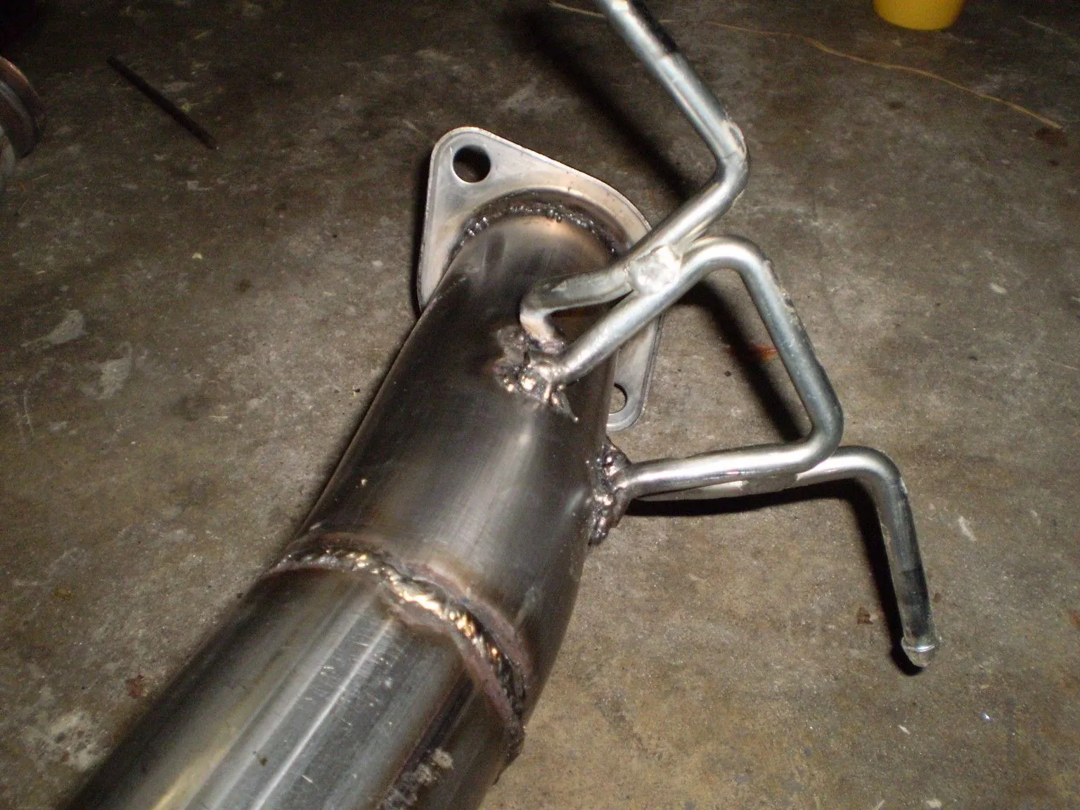

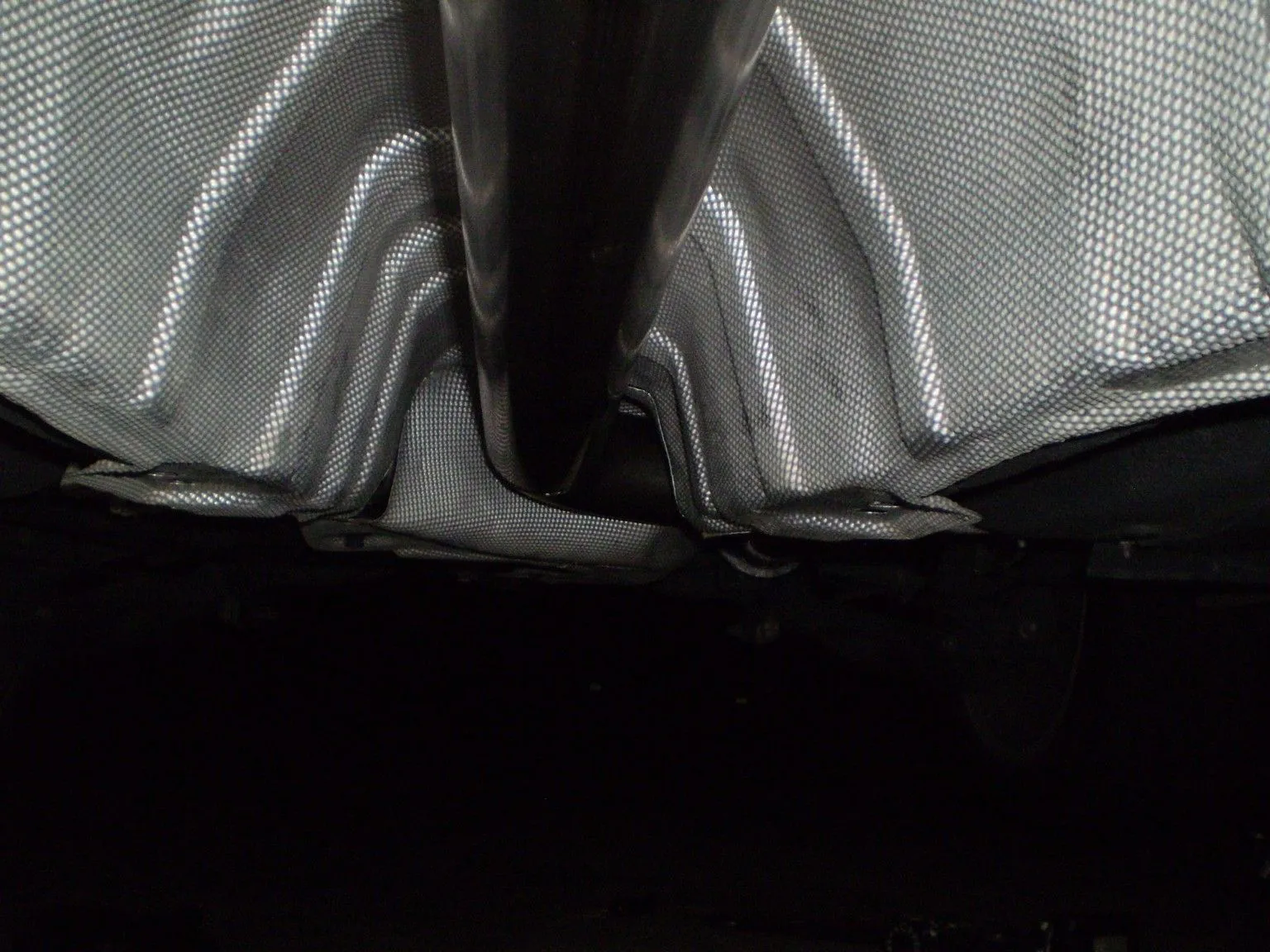

Ok here is what i made today, took me around 5 hours from start to finish, and i did this with jack and jack stands LOL... anyways dont make fun of my welding, i used these new stainless steel small rods and they were harder to weld with than usual. The exhaust is beautiful and line up perfectly with the stock rear muffler section. BTW you cant even take the exhaust off the car unless you cut it in half first, So I guess it was a perfect time to add the flange in the rear right before the rear suspension. I havent really had time to test it out other than a short ride down the street, really didnt seem much faster and its definatly louder. I can hear the turbo threw the exhaust now. I think i will eventually add a muffler somewhere in the mid section like the stock set up, so thats its alittle quieter. Also do you think i should reset my cobb ecu because it felt kinda weird when i drove it that short distance like it didnt spool as fast. I will drive it more tomorrow i think once the ecu learns the extra flow it should run great!

thats really good work man, even busted out he testpipe 2nd cat section too I see, very nice work man very lucky you have the tools for all that, turned out pretty nice! Hope it sounds sweet for you!
haha sorry but i cant keep myself from laughing at the welds its ok though what you should do in the future is practice with your materials(rods and piping and settings of your welder) before you do the real deal. what did you use to weld it all up?
looks like mig welds. i think that you did pretty good for your first exhaust. they may be a little gorilla, but they are still pretty clean.

I used a stick welder, which is the most difficult and most time consuming way to weld something like this. All the materials cost me around $110. It was fun and plus i saved tons of money and actually got a decent quality exhaust system, much better than any muffler shop could do.
