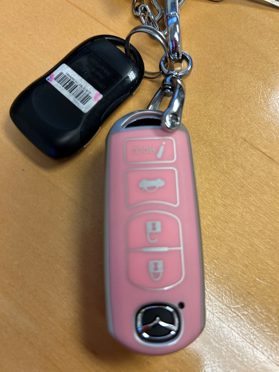

I have exactly the same thing happening with my 2019 CX-5 except that I’ve now changed batteries twice, after I bought the car.
Message that battery weak, after which I changed the battery about 4 weeks ago
Using CR2025s
Attached a photo of the key fob.
Got a message again yesterday (after about 6 weeks) that my battery was low and that I should hold the fob close to the Start button.
The remote lock/open key fob stopped working.
I then held my key fob close to Start and that worked.
I used the spare key fob yesterday, and that worked!
That would appear to be a battery problem with my key fob, except that I'd changed the battery just 4 weeks ago!
Should I use CR2032s instead of CR2025s
The separate remote starter (black) works fine.
Thanks.

Idunno about the new fobs but for our 2016.5 and 2019 (older fobs) would get that message until I switched to the CR2032 battery. The little round cover inside won't snap back on but the fob itself will snap back together.
I suggest going to CR2032
The difference between 2032 and 2025 is the thickness.
20 (first 2 digits): diameter = 20mm = 2cm
32 (last 2 digits): 3.2 mm
25 (last 2 digits): 2.5 mm.
If you can fit in a 2032 w/o breaking it... it will last longer...
Same voltage = 3V.
