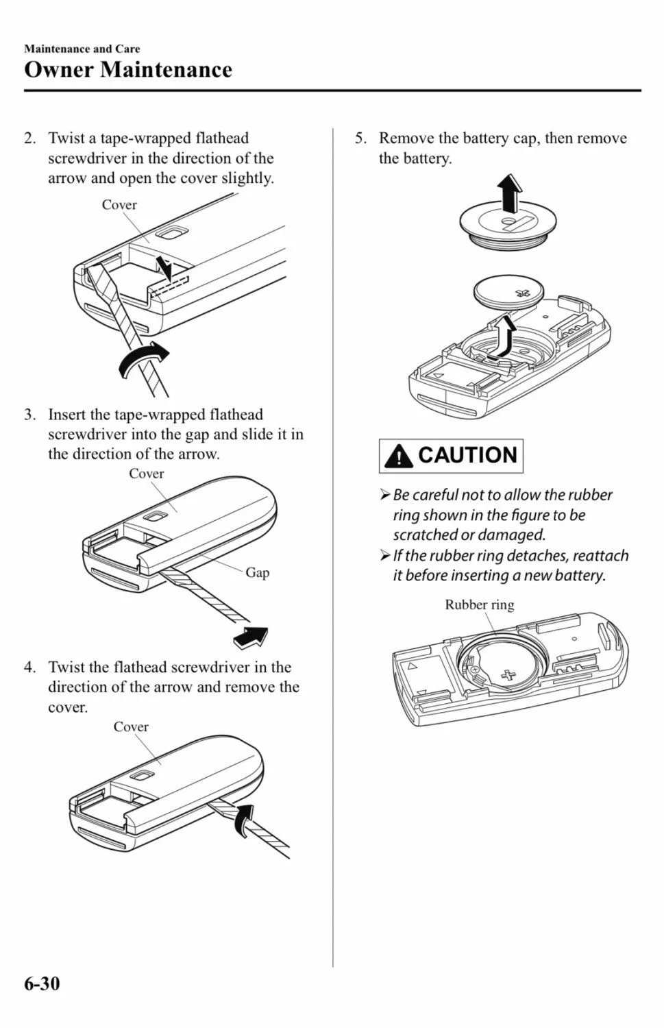

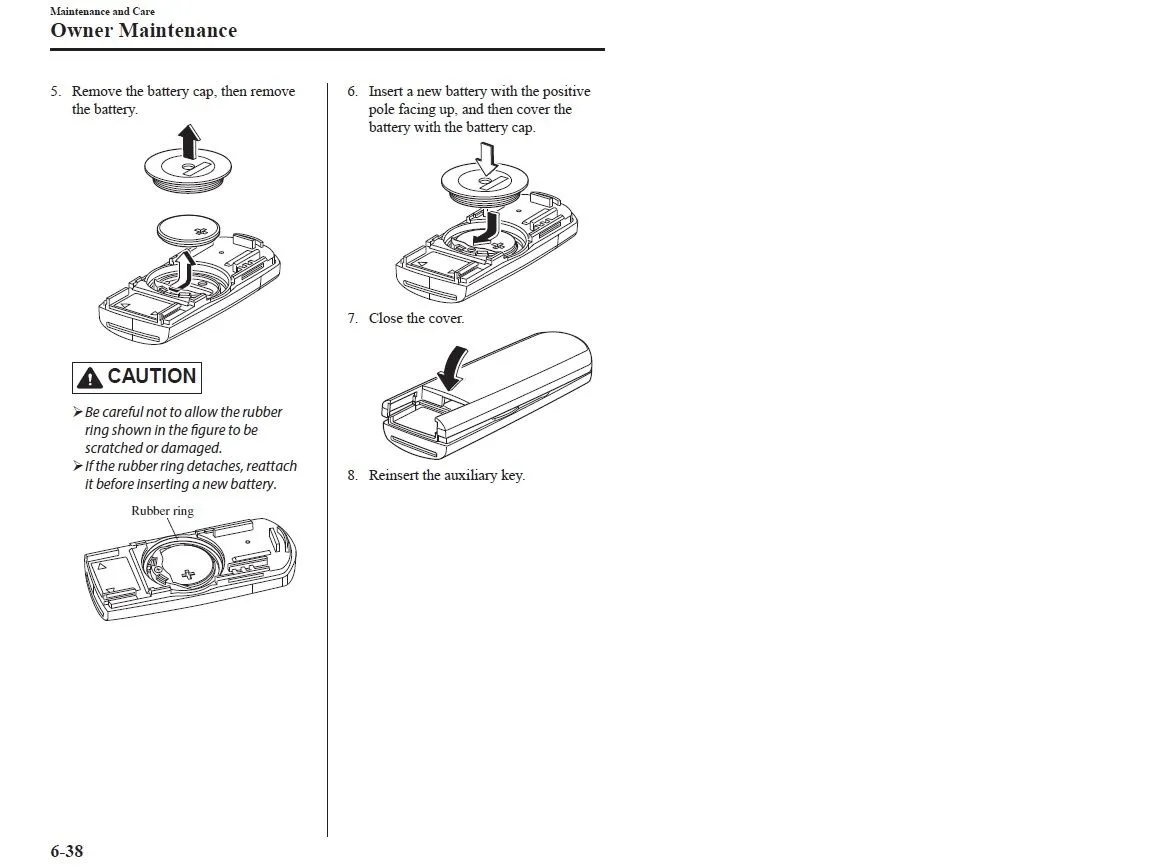

Taken from the manual:

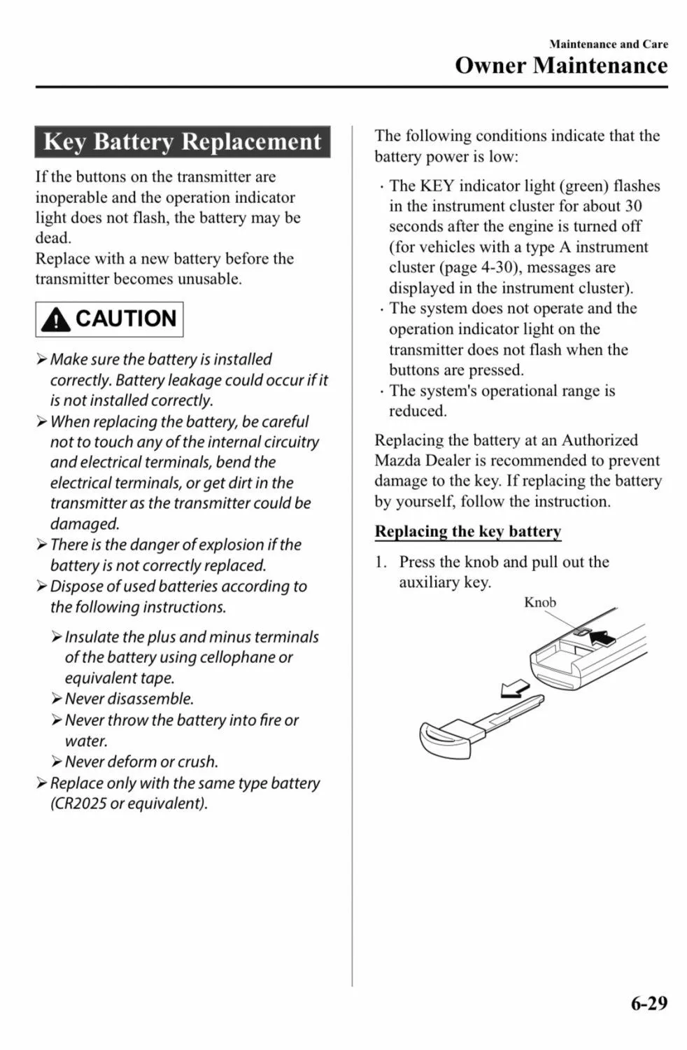

Here is Key Battery Replacement section starting on page 6-29 from 2018 CX-5 owner’s manual:

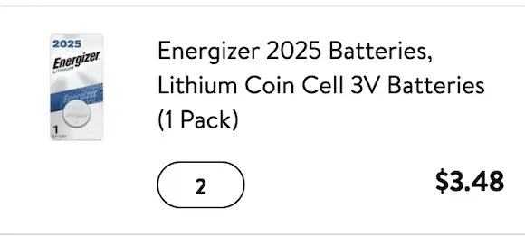

I buy them at WalMart near the checkout. I stick with the C2025 and changed both in March for $3.48. I change all the fob batteries every 12 months. Not a big deal considering I paid around $35,000 for the 2019 CX-5. I figure not worth messing with a C2032 to get a few more months service. And, I don't want my wife calling with "The car won't start". It is cheap insurance to just
change on car anniversary.

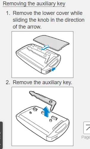

Hello @Cooter Boy, the info you're looking for is in your owner's manual. I'm not sure if you received a hard copy, but I've found that the online version (or the PDF version) can be easier to navigate when using the "Search" function.
Here's a direct link to the section regarding the keyfob:
And here's a direct link to the section describing the Hold function:
