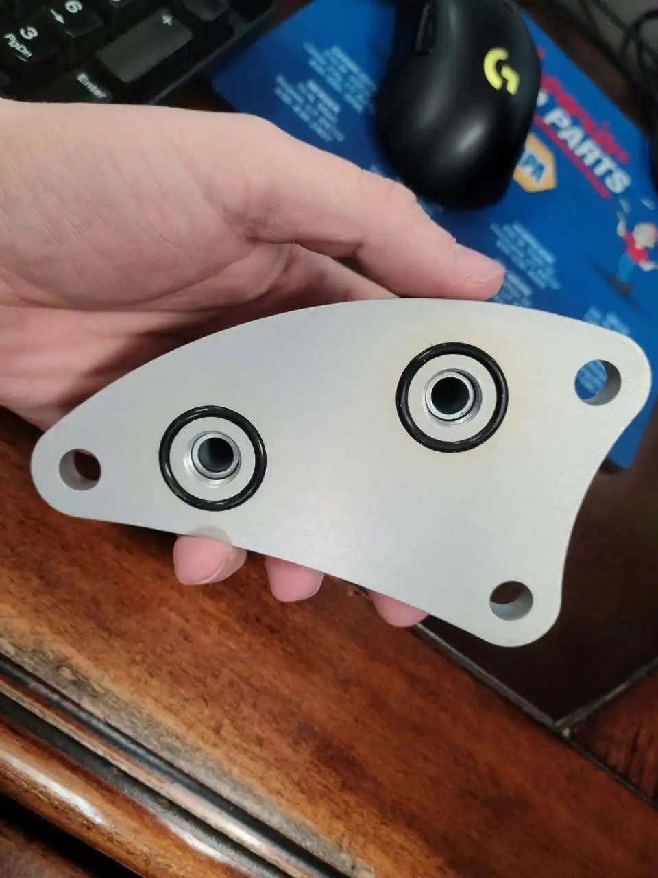

Is your CX5 your personal Mazda? If so, where and how did you attach a cooler? Where did you get it? Please post some pics.
You run an adapter in place of the OEM 2014-2020 CX5 models with 2.5 (FZ21-19-9F3)

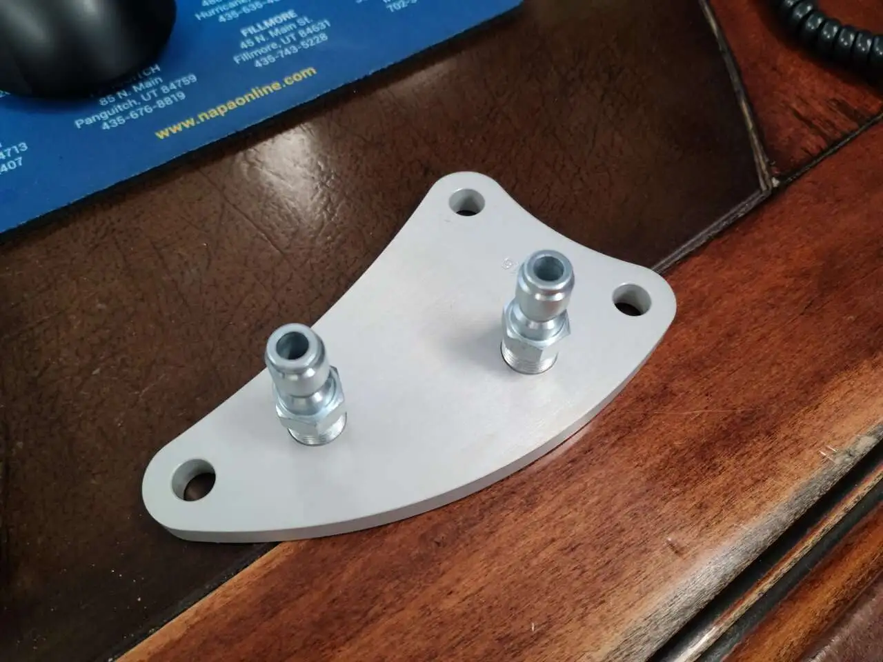

Automatic Transmission oil cooler. I bypassed the cooler (removed it completely) and ran my own lines also replacing the OEM hoses. Once the adapter is in place you can run a cooler or combination fan/cooler in many locations under the body. The transmission oil pump is well capable to pump full pressure even if you decide to run a cooler all the way to rear underbody.
There is no actual adapter to do this mod currently available but you can modify a Transmission service adapter ($30-$55) or easily make your own. Mazda TF832116QC If you can use a jig saw then you can cut 1/4 aluminum, drill and tap holes.
Sorry I can not show pictures as mine is the proto-type (*forum guidelines vendor )and should be upcoming kit offered from a well known MAZDA aftermarket parts *vendor that should be released this summer?

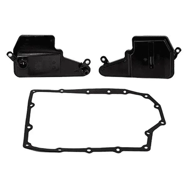

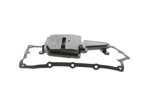

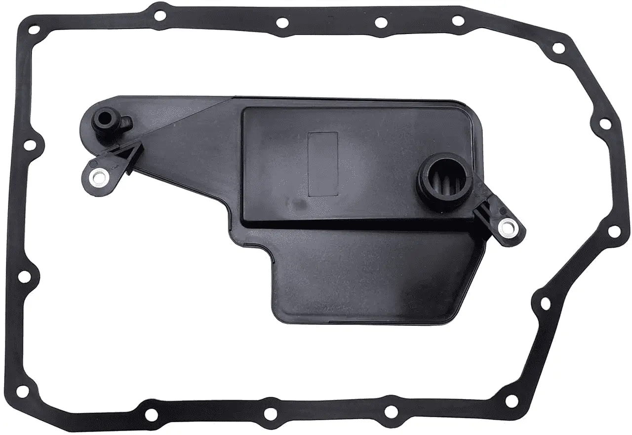

Has anyone tried either the WIX WL10379, BECK/ARNLEY 0440399 or VAICO V320220 on RockAuto? Looks like BECK/ARNLEY uses a rubber gasket but for WIX/VAICO, they do not specify the material being used. Just curious if there have been any issues with leaking ATF fluid from the gasket. I would like to not have to use RTV again on my next transmission pan drop if possible.
BECK/ARNLEY 0440399
Beck/Arnley parts meet foreign nameplate OE specifications for form, fit and function. Their product specialists work with a network of global sourcing partners so you can install the right part with confidence.
Features & Benefits:
  • Includes o-rings and/or gaskets that are required for complete filter installation
  • A premium made rubber pan gasket is included if applicable
  • Be sure to use the specific ATF formulated for this transmission
WIX WL10379
WIX transmission filters protect transmissions against contaminants in the transmission fluid system. Proper filtration helps improve transmission life by minimizing wear and preventing sticking and scoring of sensitive shift control valves. In the event of a part failure, the filter also guards against secondary damage to other parts, helping to minimize repair costs.
Features:
  • Filter is matched to OE filtration effectiveness, fluid flow rate, fluid pressure and material
  • Reliable construction ensures no unfiltered fluid can bypass the filtration media
  • Lock seamed and sealed filter assembly with application specific sealing components ensures complete filtration
  • Includes sealing gaskets specifically designed for use with today's sophisticated transmission fluids
VAICO V320220
Filter + Gasket Combo (Official Website)
Gasket (Official Website): No indication of the gasket material.
VAICO is a division of Vierol - a German auto parts manufacturer. Vaico products are made using high-quality materials and undergo strict quality tests to ensure OE fit, form, and function.
BECK/ARNLEY 0440399
WIX WL10379
VAICO V320220
Not that brand in particular, but years ago I had a 97 Plymouth Voyager that I used to do a fluid/filter change, originally had RTV sealant on the pan. Eventually some one came out with a reusable gasket with a silicone inlay. It worked pretty damn good.
That is the exact filter I use on my 2013 with the 2.0. it comes with a rubber gasket.

I do a drain and fill every 30k, drop the pan and change the filter every 60. I'm almost at 105 now, so my second filter change is coming up soon.
No leaks, either. Just remember that it's a gasket, not RTV, so don't kill the bolts tightening them down. You want to snug them, then go a bit more, all the way around several times. If you crank them down, you'll squish the gasket too much, and then it will leak!

That is good information to know, I'm at 98k at this moment and plan to do my transmission pan drop at around 130k (last one was about 65k). Do you follow up with a torque wrench and then torque the bolts to spec afterwards or do you just snug them up? Not sure if torqueing the bolts to spec will destroy the gasket or not.
I can understand not wanting to do new RTV. It was one of the easier tasks though in my opinion. Removing the pan and the old RTV was a bigger undertaking. I bought an oil pan separator off Amazon and Motorcraft silicone gasket remover off EBay. That helped me get get pan off quickly and remove all of the old RTV with a brass brush in under an hour. You’ll want the pan and the transmission housing as clean and grease free as possible RTV or silicone gasket.
I can’t remember the torque specs for the pan bolts, but it’s pretty low. We’re talking inch pounds/hand tight. Install the bolts in an alternating star pattern, doing each one on opposite sides. Torque them all to the required specifications in an opposing pattern, and go back and check them all again once you’ve tightened each one. That should do it. No leaks with my Mazda OEM gasket maker. The OEM torque spec should be fine for a pre made gasket.

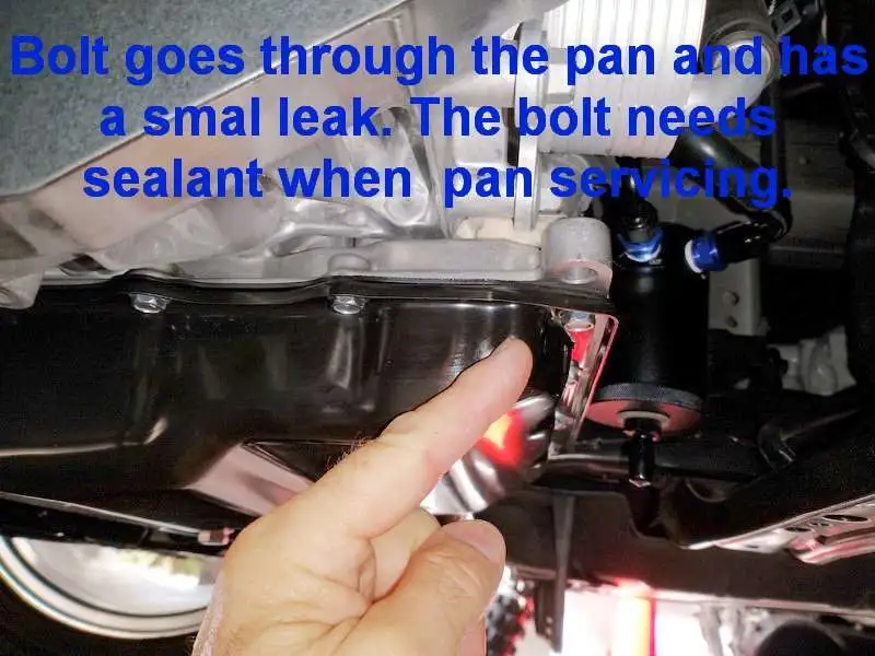

There is one bolt that needs to have seal applied. You may not get a leak but its better to take care of it now then later.

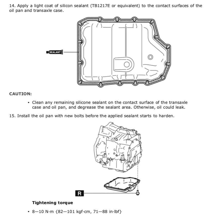

As was stated, the factory torque spec applies to RTV, not a gasket, so you can't go by that.
Use 1/4" drive hand tools, and just use your eyes and your feel to get the proper torque. A speed handle is the tool of the day for this job.
I've built one for my Mazda 3 Turbo. BG makes an adapter that makes it easy to bypass the factory warmer/cooler on the side of the transmission. I used this cooler 19 Row Series 10000 Stack Plate Transmission Cooler Kit. Use good quality lines and mount it up front. I live in a severe heat climate so I did not install an inline thermostat. Depending on the size of cooler you go with it is not a bad idea to put one inline. I've been inside multiple Skyactiv Drive units. They are built well but based on wear/torque converter friction shed in multiple versions of these transmissions for my own personal car I will be doing a filter and fluid every 30k Miles.

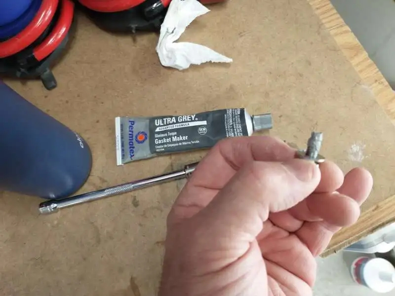

While I have not confirmed it this one bolt was slightly longer than all the rest of the pan bolts. The first time I did the filter service I had a small amount of oil about a drop every 100 miles accumulate on the top and surrounding area. So now I simply apply a little sealer and dry a bone until my next 5k filter service.
You can go slightly lower for sure, but as low the OEM specs are it’s splitting hairs imo. If you take your time and use a 1/4 inch drive torque wrench you can’t go wrong. Tribe did a better job explaining how thorough you need to be degreasing the mating surfaces.

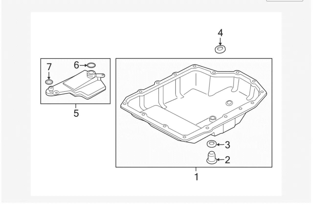

••Anyone using new bolts like FSM says? Pan bolt PN: 9YA0-10-615A
71-88 in-lbf
71-88 in-lbf

I used new bolts for grins and giggles. I also wanted some on hand in case I accidentally lost a bolt in the garage or something. I wouldnt mind using the old ones, but they will have some RTV on them that you’ll want to remove before reusing. Blooms had a good idea to hit them with a dremel and wire wheel, it’ll knock that crap right off. There is also location. I’m in the south with no road salt, so the bolts weren’t rusty. I’d be hesitant to reuse rusty bolts.
71-88 in-lbf

I bought brand new bolts for my last pan drop and I typically try to always buy new hardware since my area has road salt every year and I don't know when I'll need to chop off a bolt.
