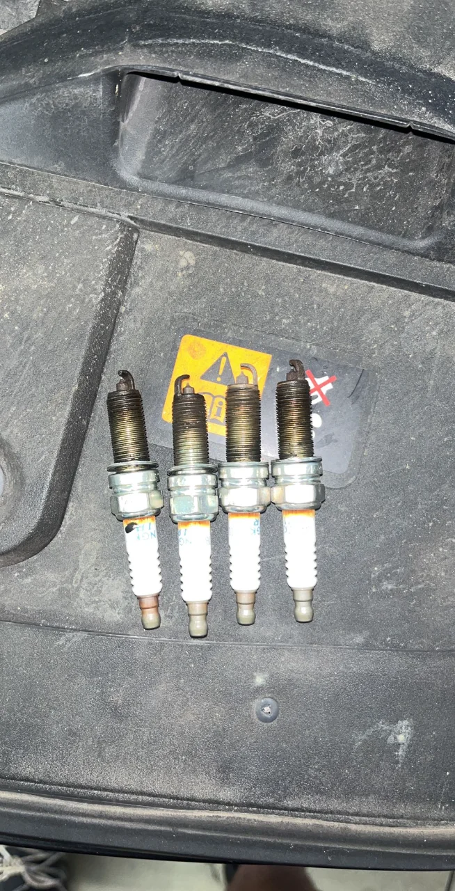

I actually found the email with the inspection results where you click on the link under spark plugs recommended and it shows the picture (attached). I doubt those plugs are mine. I had them changed out at 75k with the NGKs for Mazda.
No way are those the plugs you changed at 75k. I changed my plugs in the 2018, which were Mazda Branded, at 116,000km (close to 75k) and they were in better shape than those. Could have screwed up the coil packs or loosened a wire somewhere though you would expect a code.
