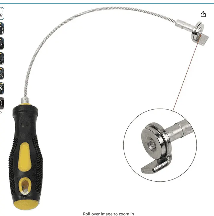

Oil drain plug magnetic removal tool (after first loosening), under $10, (won't work on a nonmagnetic stainless plug with a magnet pressed in to catch the wear bits):

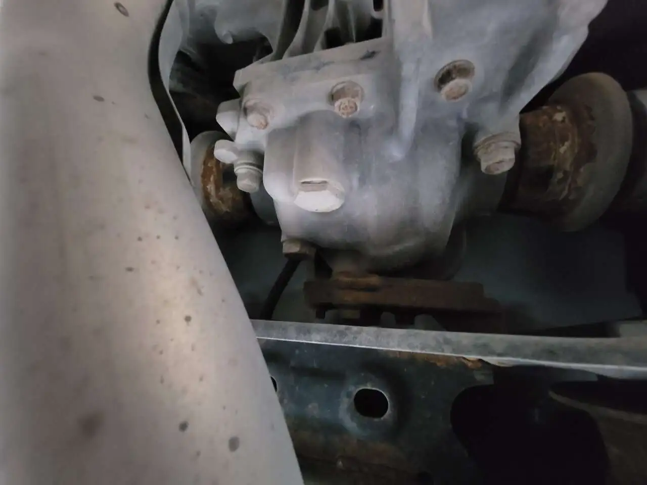

Ok, I'm having a hard time with the rear diff. Only because I can't seem to get my socket and ratchet to fit on the fill plug! I'm using what I think are shallow sockets, they're about 40mm tall. And a 1/2" ratchet as the only 23 and 24mm sockets I could find locally were all 1/2" drive. Are my sockets not actually shallow? Am I maybe using the wrong tools? I can't get the socket on the bolt because the crossmember is in the way.
I feel stupid lol. I'm about to return these sockets and buy a couple of 23mm and 24mm wrenches instead. Hopefully those will work. Pic attached below.
Pic of the rear diff

If necessary a socket can be ground down so it has less length, just enough to engage the hex head, and you have more clearance.
