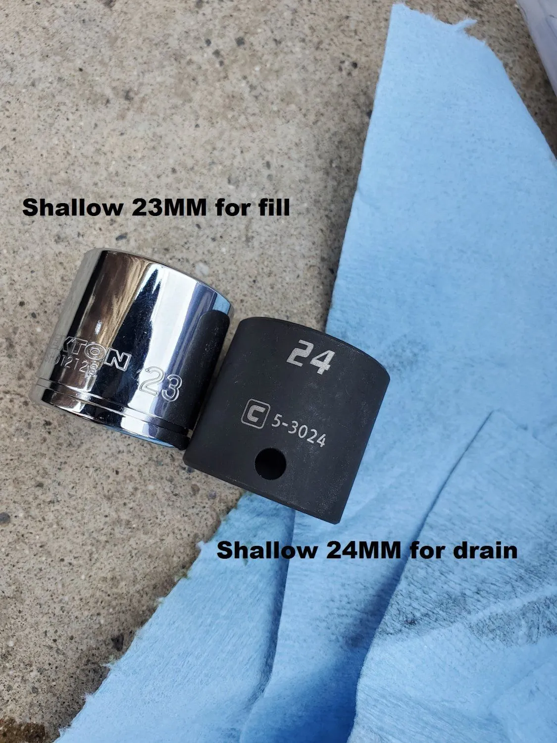

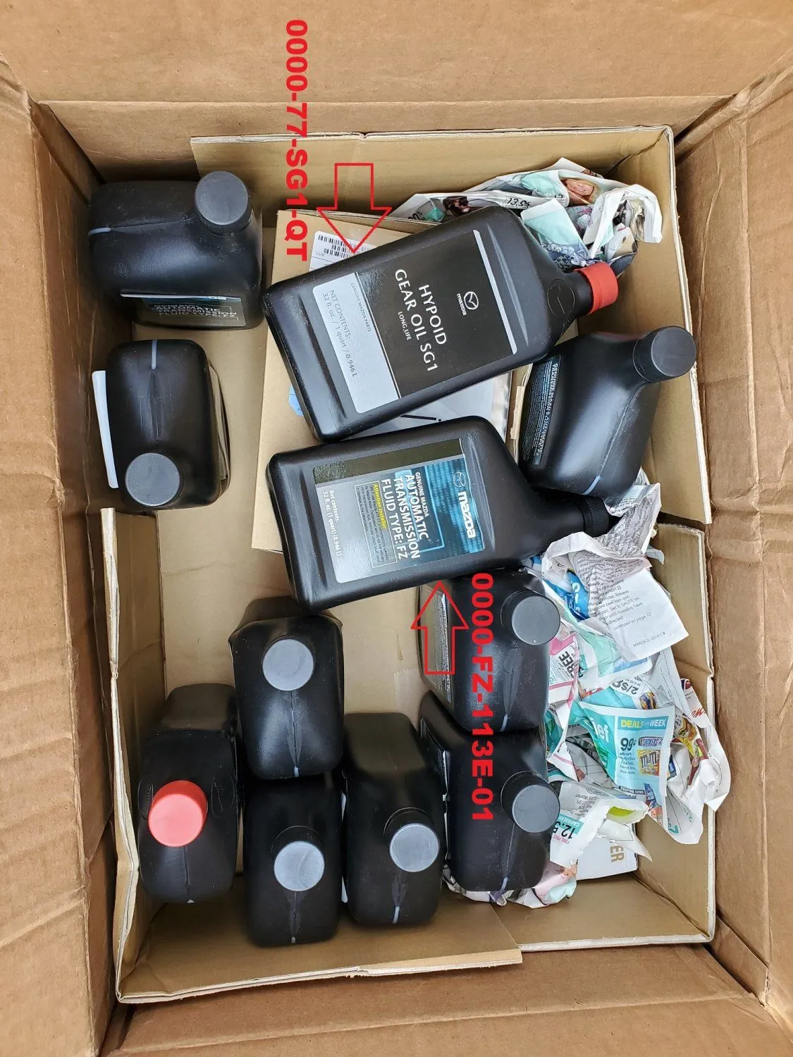

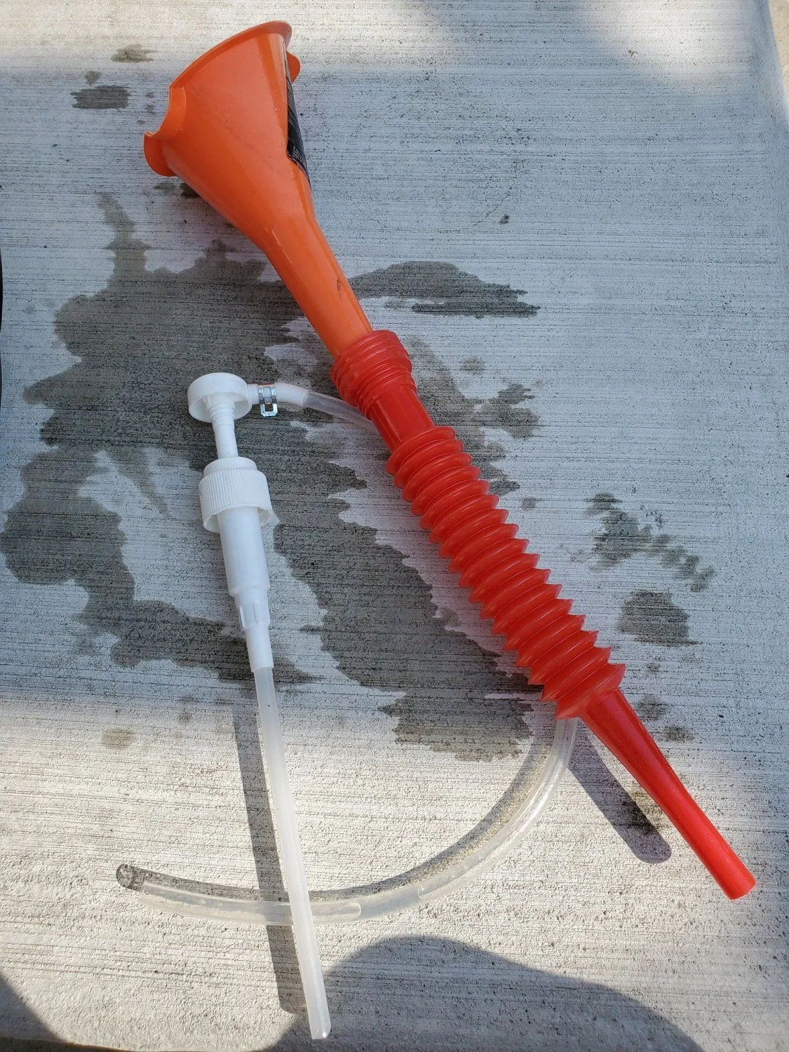

Items needed:
1) 2 quarts of LONG LIFE HYPOID GEAR OIL - SG1 - Mazda (0000-77-SG1-QT)
2) 23MM shallow socket for fill plug
3) 24MM shallow socket for drain plug

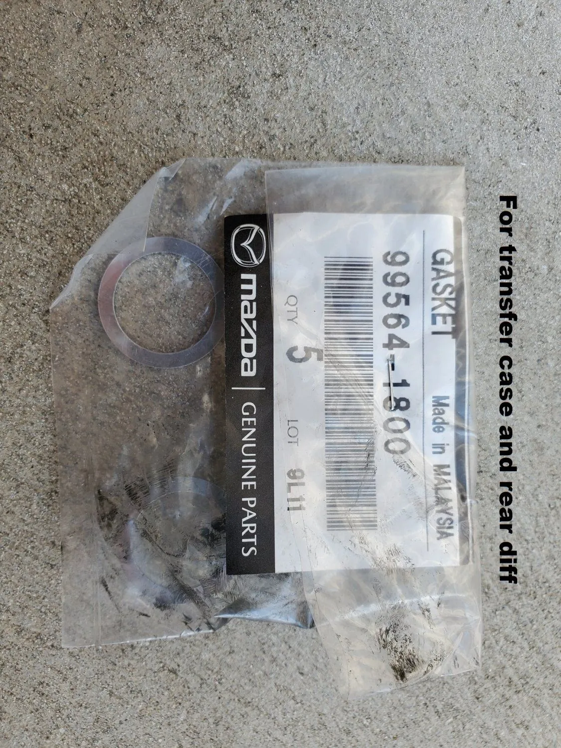

4) 4 pieces of drain plug gasket (9956-41-800)
5) Fluid pump

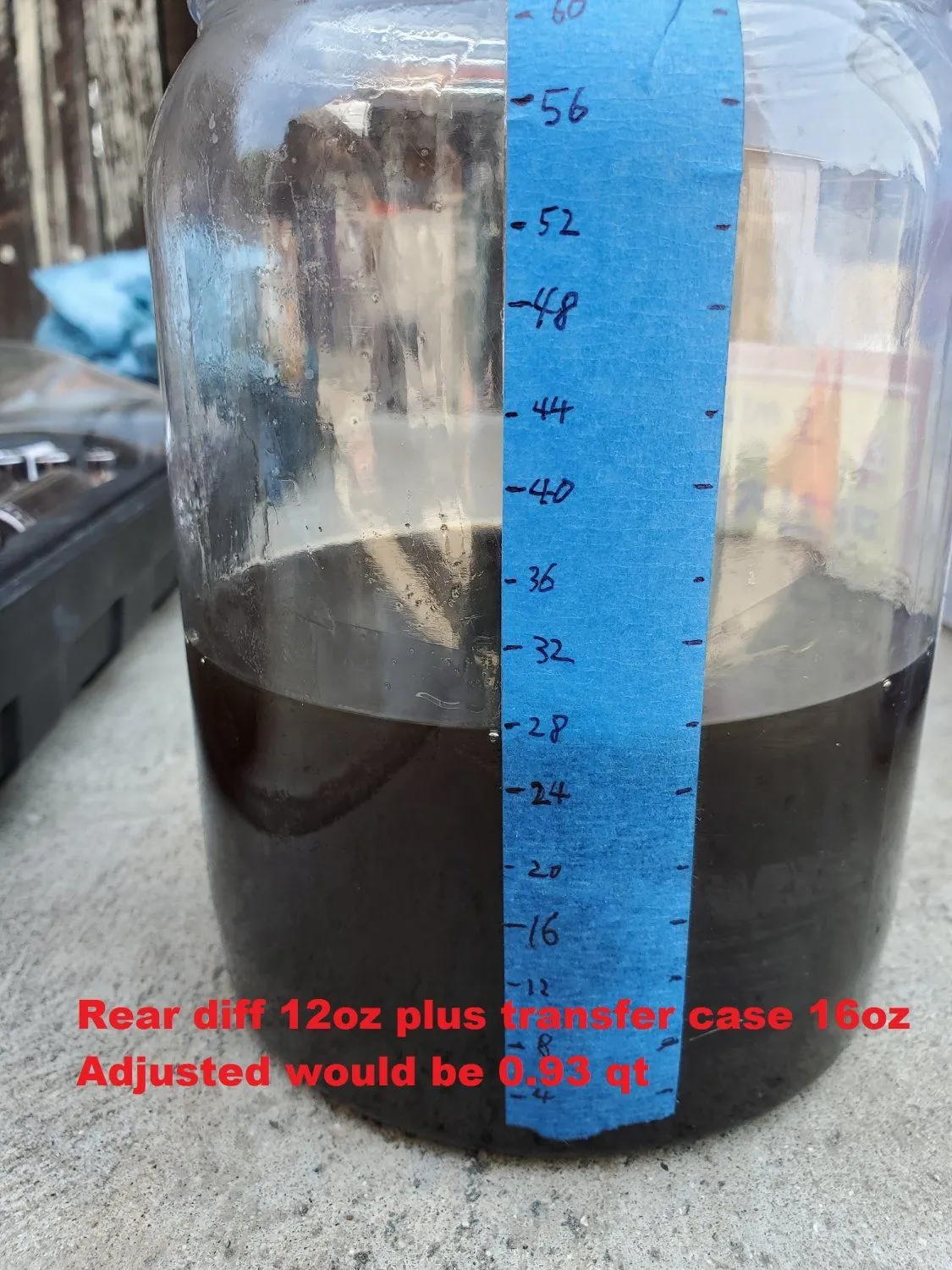

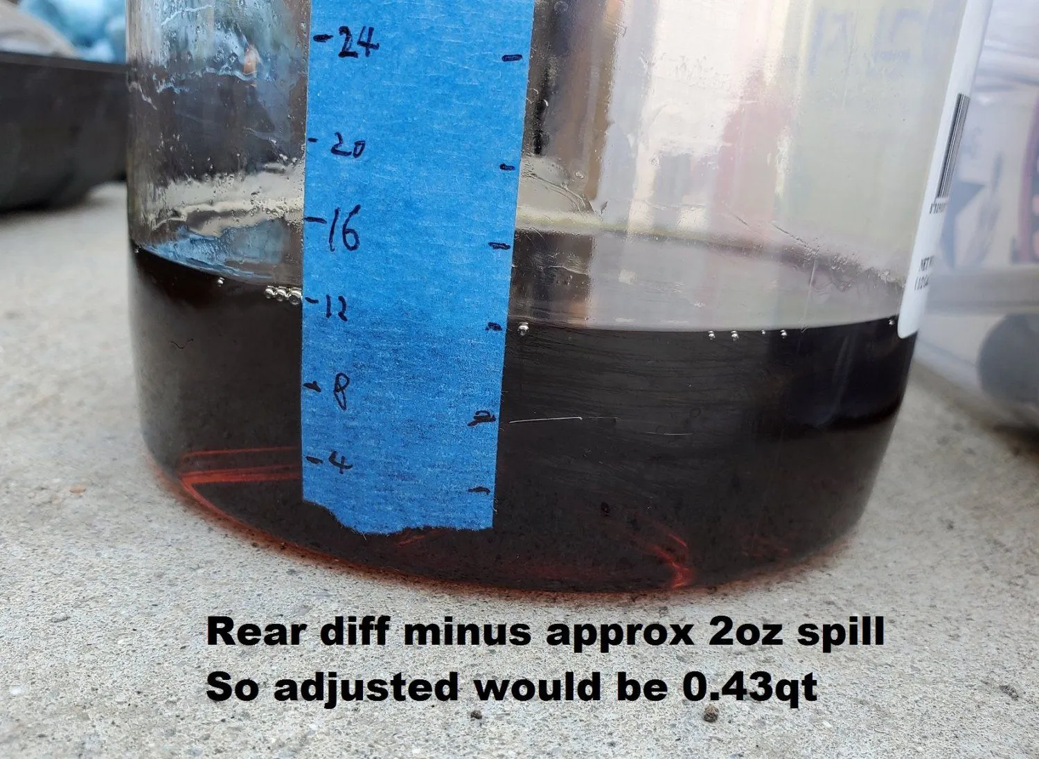

Please note owner's manual states approx 0.45qt (15oz) for transfer case and approx 0.45qt (15oz) for rear diff. However, do pick up 2qt of oil because rear diff was under-filled quite a bit.
Always crack open the fill plug before draining the fluid. Replace all washers. Torque them 35ft/lb. 1 quart = 32oz
I drained 14oz from rear diff and filled approx 22oz
I drained 16oz from transfer case and filled approx 18oz

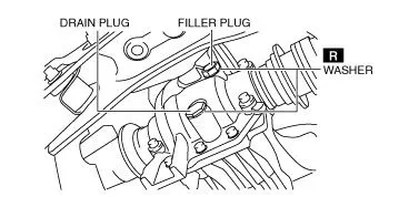

I have yet to tackle this, my bathroom renovation took some interesting twists so I'm behind on what I wanted to complete and write up. I would like to add some snapshots from the manual for drain and fill locations for those who will use this guide.
Transfer case Drain bolt location: to get to these locations you need to remove the large undercover.
both torque settings are 30-42 ft/lbs (40-58 Nm)
Transfer case fill location:
Differential drain and fill locations: both torque settings are 30-39 ft/lbs. (40-53 Nm)
I plan on replacing both fluids this fall, I have to get done with my remodel project and make room.

Thanks for the info, but Did you fill until it comes out of the fill hole?
Dumb question here, but for the transfer case do you fill it until fluid comes out the fill hole or is there some other procedure for determining the proper fluid level? Reason I ask is I filled it until it leaked out but the axle seal is lower than the fill hole and I'd hate to put too much in and cause that axle seal to leak. If anyone can let me know so I can drain as needed I'd appreciate it. I can't find any info anywhere else on the subject.
Edit: I see 2 posts above says it should be filled to the top but want to confirm 100% you are talking about the transfer case too. Replacing that seal will be a b***h if it pukes.
Yes, fill to the fill hole in the picture I posted in post #5.
Drain using the fill hole and fill using the fill hole until it weeps out. If you're so inclined you can also replace the drain plugs with magnetic drain plugs for additional fluid cleanliness since there are no filters for the diff or transfer case. These two locations have a lot of metal on metal contact. A magnetic drain plug is just additional insurance.
