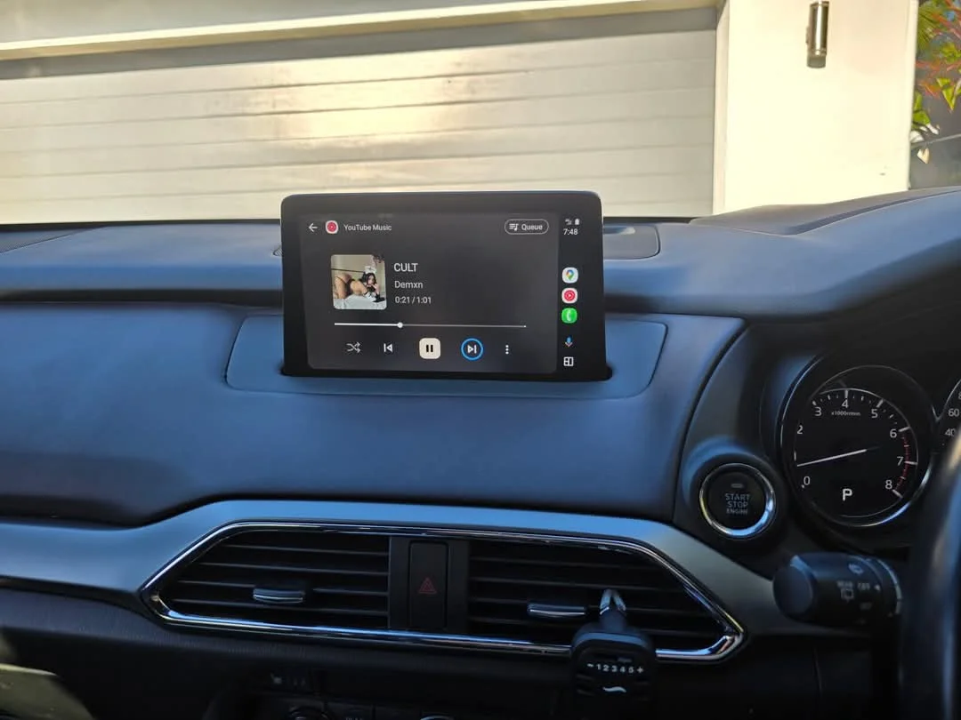

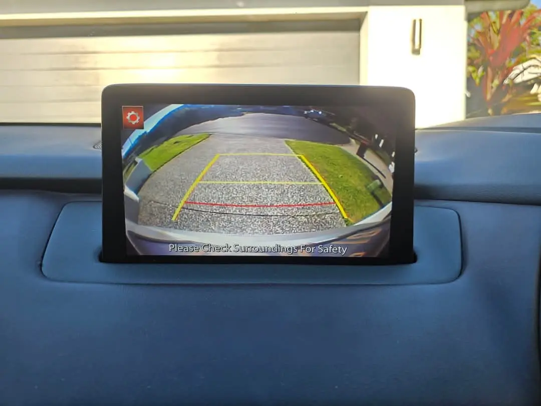

You can install the 9.0 screen and it will work perfectly. I replaced my 8" screen with the 9" and love it. No mods required.
No idea what yourI is on about as the 9 inch screen definitely isn't square...
I have a 2018 CX9 Azami (Australian model).
Squarer i guess. It seems like the base is the same width and the extra screen space is on the top.
But if you like it, definitely go for it.

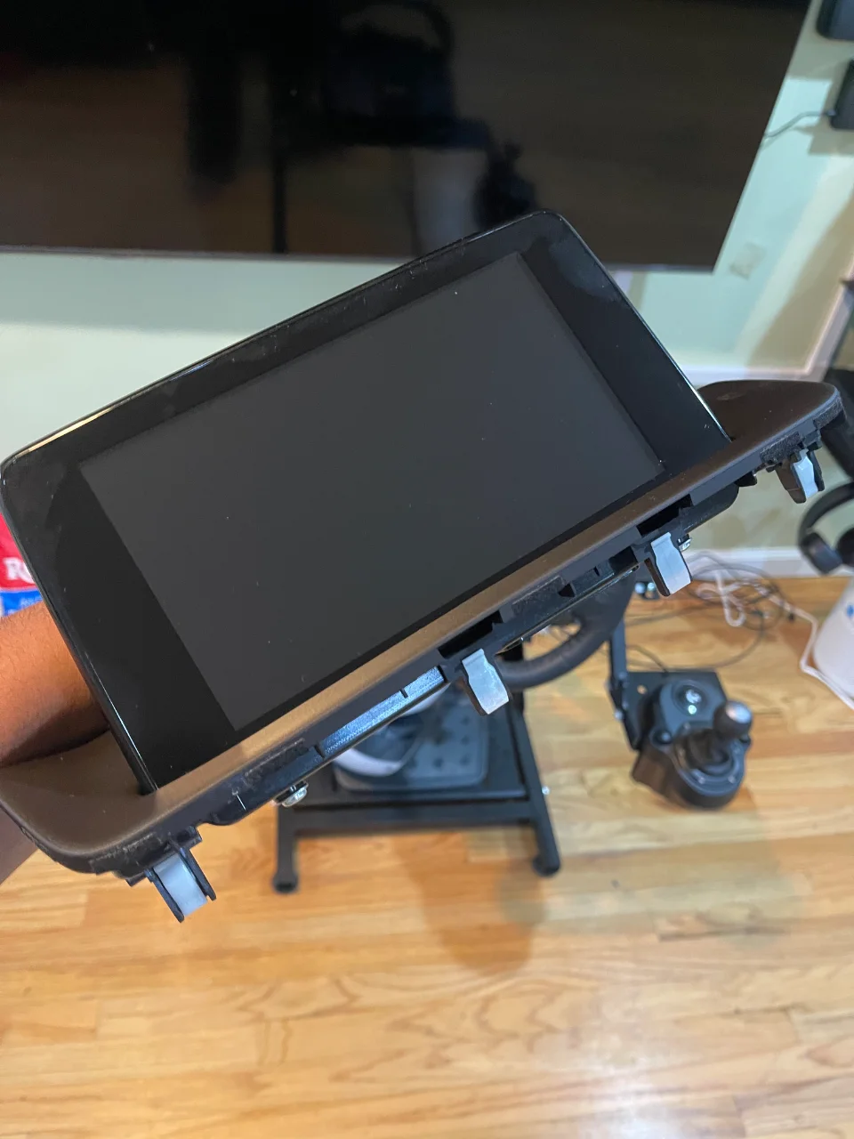

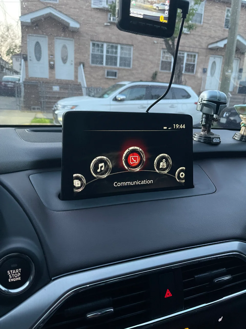

Just as you said, the 9-inch display screen fits perfectly in the 8-inch display screen slot. I didn’t have to do any modifications as the 9-inch screen came with the plastic base. Used a flathead screwdriver wrapped with painter’s tape to remove the screw cover in the back, then used a 10mm socket to remove the two 10mm bolts. Then using a plastic pry-tool, I removed the screen. Did not take more than 10 minutes.
Nice work, shawnee. Glad you gave it a go. It's a really great upgrade.
