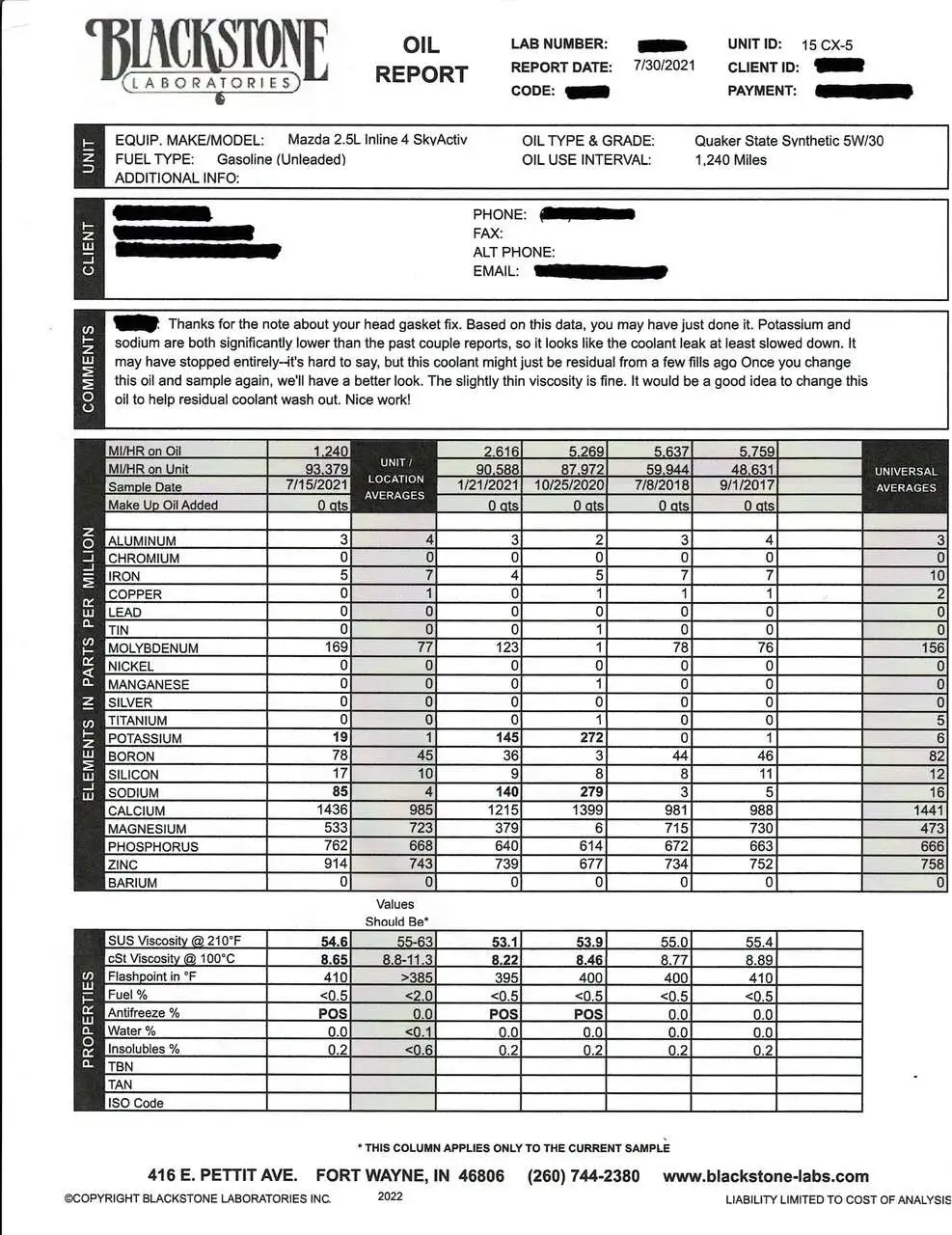

At 88k miles, Blackstone report suddenly shows 10x normal level of Sodium and nearly 100x Potassium - clearly, coolant in oil. I have searched the internet and cannot find any other mention of this situation in the 2.5 SkyActive engine. Of course, with 13:1 compression the first suspect is the head gasket. However, there are no bubbles emanating from the radiator and the chemical (block) test shows no evidence of combustion gases in the coolant. The next thought for any engine would be the oil cooler, but this engine doesn't have one. I'm familiar with the water pump issues from (completely different, Ford-sourced) Mazda engines but the exploded view in TSB01-022/19 (https://static.nhtsa.gov/odi/tsbs/2019/MC-10169537-0001.pdf) seems to make this pump an unlikely source for transfer into oil.

Blackstone report:

Well you certainly will want a confirmation of the report, because anyone, Blackstone included, can make a mistake. But if the next report comes back looking the same, then you should do a compression and leak down test, in order to find out what's actually happening with you vehicle's engine and how bad the problem currently is. Then, depending on those test results, you'll need to decide what to do next.

The second test showed exactly half the amount of K and Na, at half the change interval. For me, this is confirmation that both test are accurate. For the record, I have complete confidence in Blackstone. I know lots of people who rely on them for aircraft and automotive/diesel engine monitoring and have never heard of them producing bad test results, ever. I also switched oils from SpecialTec AA to MolyGen to prove that it was not a problem with the oil. I'll post the Blackstone report on the UOA thread, along with some interesting Qs and As from Blackstone.
For now, the car is going in for a compression test (thanks, Edmaz) and a cooling system pressure check (Blackstone's rec). I'll report those results ASAP.

Given that you described the coolant loss as 'minimal', I recommend asking the shop to do a leak down test along with the compression and pressure tests. IMO it's likely the compression numbers will be fine, and will not indicate an issue. However, the leak down test may possibly provide a different perspective. With all the work already done to remove the plugs, they hopefully won't charge a huge extra amount to do the additional test.
That said, I'm totally mystified that Blackstone describes this as a 'fairly severe coolant leak', when you're not seeing anything close to that when checking the coolant level. 'Fairly severe' to me means adding make up coolant regularly, but perhaps their perspective about coolant in the oil is different than mine. This entire thing is very puzzling to me, and I'm definitely interested to see how the results of all the other testing turns out.

Sorry for the delay, here's how this situation has progressed:
A cylinder leak-down test was done because I wanted to determine the viability of the engine (weather it is worth spending $ on). The tests showed Zero leak-down at both cold and at normal operating temperature. To me, this suggests that the leak is either minuscule or elsewhere. The next suspect would be an oil/coolant heat exchanger (oil cooler) but, from what I can determine, this engine doesn't have one.
Next, I decided to use Bar's Leaks Cylinder Head Fix. As expected, the heater core degraded to approx. 50% efficiency. After 500 miles, a chemical flush was used to remove the excess Bars Leaks sealer (Prestone makes a good chemical flush). After 100 additional miles, the cooling system was flushed with new coolant to remove the chemical flush. The heater is now about 80% effective, compared to new. An oil/filter change was done (but not analyzed) as a clean-out prior to further testing.
After 1240 miles, another oil/filter change was completed and the oil was sent for analysis. The report indicated a major reduction in Potassium and a significant reduction in Sodium. The report is attached.
Currently, another 2500 miles have passed and I'm ready to change/analyze the oil again. This should be the final answer as to weather the problem has been fixed. I'll post that Blackstone sheet as soon as I receive it.
