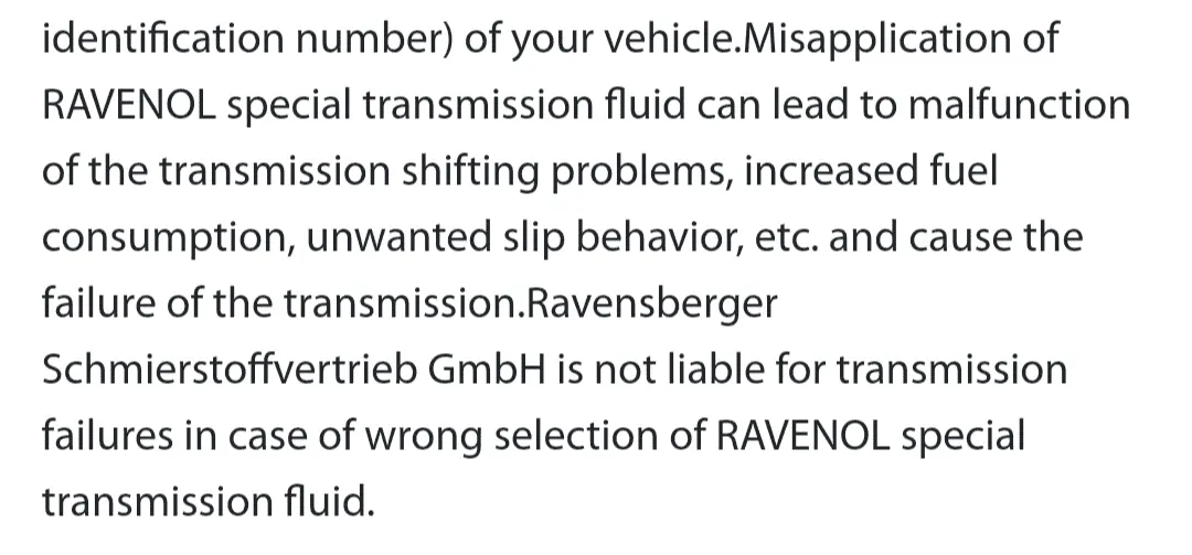

Eh. The price is almost identical between the Mazda ATF and Ravenol. And, right on Ravenol's site, it says this:
I'll stick to the Mazda stuff.
Stop with the FUD.
It's a basic disclaimer like any other company will usually say. It just basically says if you use the wrong fluid, you can burn up the trans. It's that simple and is common sense.
Like I said, already Ravenol is the ONLY known 3rd party that makes ATF Type-FZ, which is what the Skyactive trans uses. It is blue. It is synthetic. It is way better than the Mazda branded fluid because it's synthetic. Did I already say it's Type-FZ, which is the right stuff and what it needs?
So go on and waste your money on non-synthetic fluid from Mazda just to feel safe. It's your car, and your money.
But stop spreading FUD about it, because you didn't even reading the product page, except just instantly focusing your eyes to the disclaimer, because you already had a prejudiced mindset. If you even knew a thing about our transmissions, you'd already know what the actual designation code is, instead of freaking out over it.
And if you even looked further, plenty of people on other forums recommend it and there's no problems. A 5 minute Google search found it. I'm not doing it again for you.

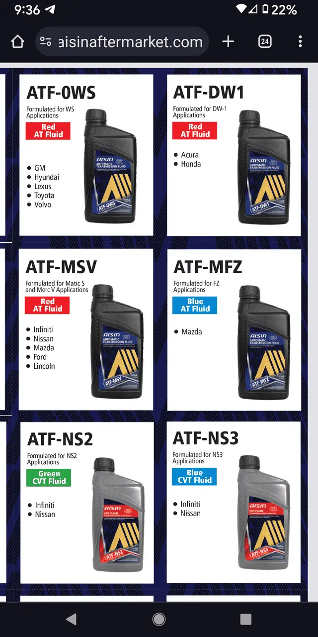

EDIT: Aisin sells ATF FZ also, so that makes that 2 aftermarket choices, which are both synthetic. Aisin's fluid is also half the price of Ravenol, but Ravenol might be better because European definition of "synthetic" is stricter than American one
The link expired, but found the replacement: https://aisinaftermarket.com/assets/blog/post/69dfe9dc362c247623f49d442d1e7f79.pdf
