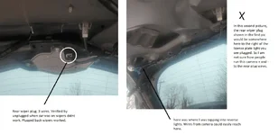

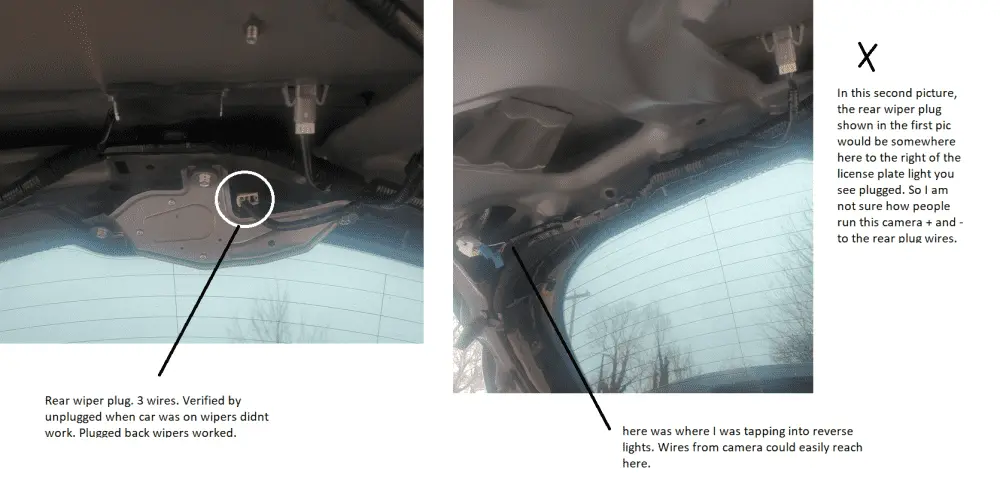

Hi, where exactly did you tap into the rear wiper power? See my attached picture that I had previously made, Can you circle the area where you tapped? My issue is that my cameras red power wire is short, it cannot reach all the way across to the middle of the trunk where the rear wiper harness is. I'm guess you connected to a side area that somehow wired to rear wiper?

Actually, looking at these pics I may have tapped in to the power wire at the rear wiper plug. My power cable on my cam was long enough to reach there, and I would have cut the cable sheathing back to get room to work with. I would have grounded the camera wire to the door itself and not to the ground wire for the rear wiper.
Sorry, I’m working from memory having done this years ago. If your cam wire is too short I’d extend it with some wire to get there.
So you grounded it to the trunk frame you mean? ? like one of the metal pieces sticking out in my pic? By wrapping it around and around? I am not an expert in this. We have the same car so whatever you did I will do. Just need to be sure I do the exact same.

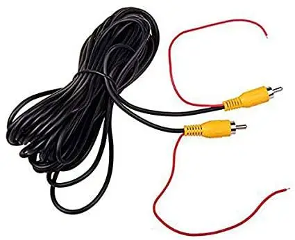

My camera positive red wire is wired to the red wire attached to the yellow RCA cord. It is safe to run an extension red wire to TWO joined red wires? Basically 2 red wires join into extension > to rear wiper power wire?
Can you post a picture of that? I’m not much of an expert on this either, but that might be able to generate more help.
That red wire on the RCA cable is usually used to 1) trigger an aftermarket head unit, or 2) to provide power from the front of the car. I saw that second method on another YouTube video, but you shouldn’t have to do that. My gut is thinking you can undo the camera positive wire and tap into the rear wiper, but I don’t know why it’s attached to the red wire on the RCA cable right now.

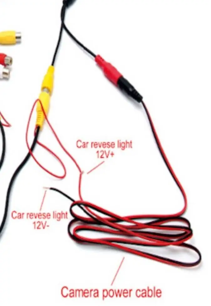

No no. Not talking about the red wire at head unit. On the opposite side at the trunk the manuals require you to tap that red wire to the red wire from camera. Then the ground. Currently I joined the two red and used a t tap to tap into reverse light wire. Since I need an extension I assume it would be no issue to tap the two into an extension by crimping then to the rear wiper power.
Look at the picture here. See the two positive wires joined? Those are the two joined wires I need to have the extension joined to reach rear wiper.

Undo the “Camera Power Cable” from the red wire on the RCA cable. I’m fairly certain it’s not doing anything how it’s currently hooked up. The red on the RCA cable will not be hooked up to anything on either end if I remember correctly. It’s not needed at all as the Mazda head unit doesn’t have a trigger wire, and you’re going to get power from the rear wiper.
Tap the red wire from the “Camera Power Cable” into the 12 volt rear wiper wire. It should be plenty long enough. I recommend using a “T-Tap” wire connector to tap into the rear wiper wire. If you don’t know which wire is the 12 volt on the rear wiper (I don’t remember the wire colors), you can find it with a multimeter or you might have to have an vehicle AV/shop do this for you : ) I’d hate for you to tap or splice into the wrong wire and your rear wiper no longer works.

Wait a minute. Those little red wires on those RCAs aren't required for us?? Are you serious? That was only Power for those needed trigger wire? How will the screen know to switch though if none get wired to anything? Anywho. If that's the case I may be able to reach it if it's not needed. Why do these instructions always tell us to do the wrong thing? I hope what you said works.
Yeah, I double checked my thought process.
The only reason you would need the red RCA wire done the way you have it pictured/described in the manual is if the head unit has a trigger wire. The manual wiring suggestion makes sense when hooking up to the reverse light. It would send 12 volts through the RCA red wire and up to the red wire on the opposite end of the RCA at the head unit trigger wire. That tells the head unit it’s in reverse and displays the cam.
However! Our CX-5 head unit somehow knows it’s in reverse without a trigger wire. It just doesn’t have one. Therefore, you don’t need to connect the red RCA wires at all. We’re not using the tail light, the camera is always going to be powered by the rear wiper. The head unit will display the camera when the transmission is in reverse, and I wish I knew how it did that lol but it does : )
