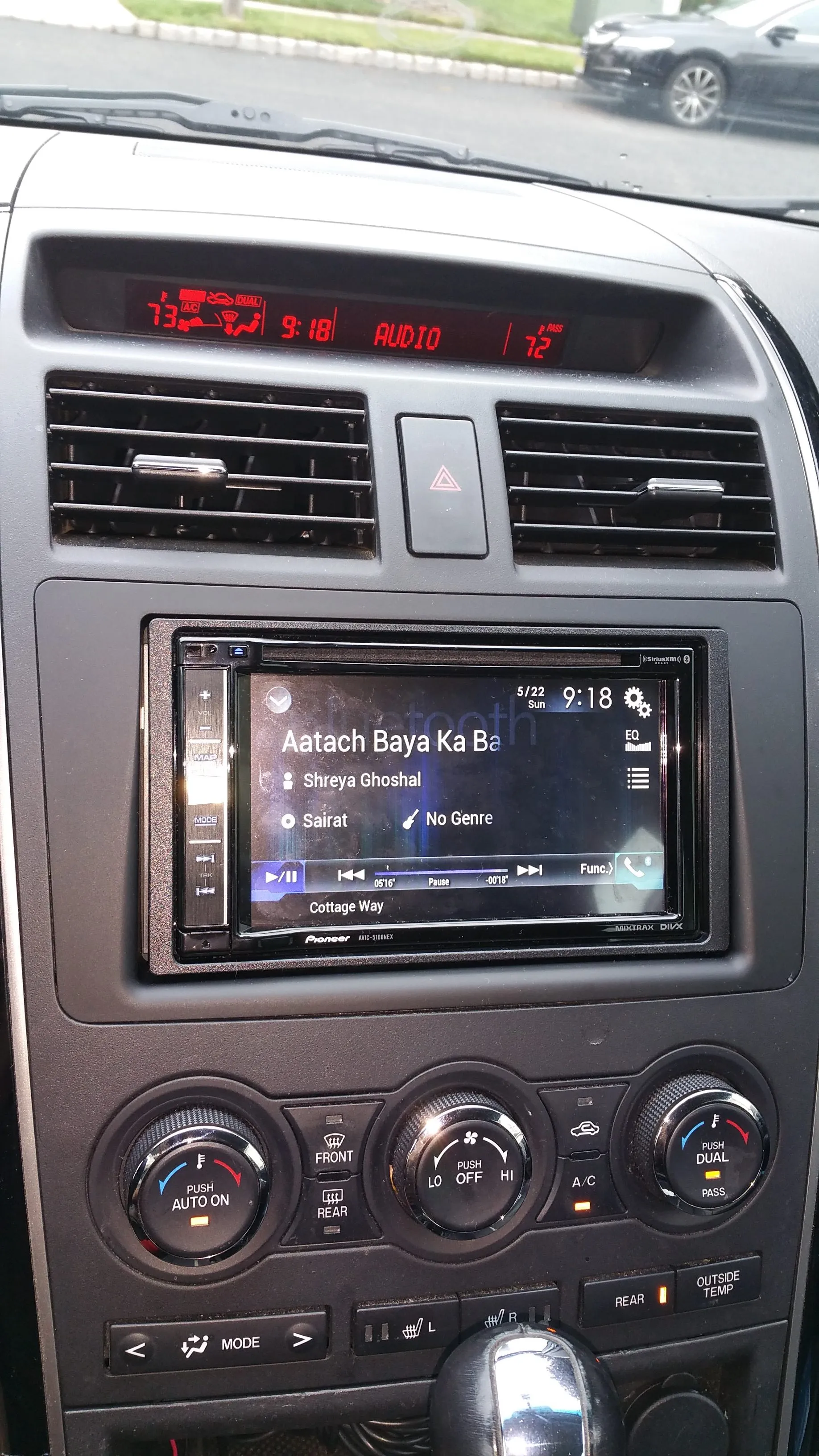

My 2012 Cx-9 Non-Bose doesn't have bluetooth audio. It only supports bluetooth phone calls. So I replaced my OEM stereo with Pioneer Nex 5100 .

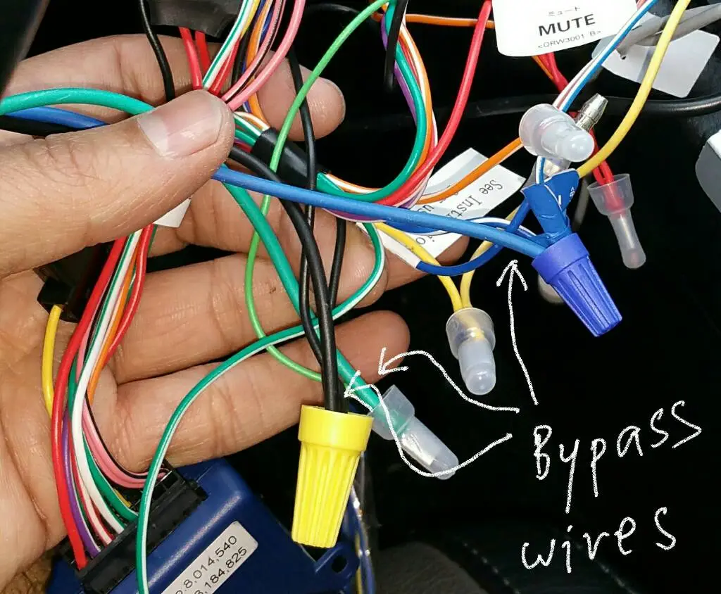

Light Green - Parking Brake >>> Red/White - Parking Brake Output OR parking brake bypass
Blue/White - System Remote Control >>> Blue/White - Amp Turn on Input OR to aftermarket amp OR UNUSED if head unit powering speakers

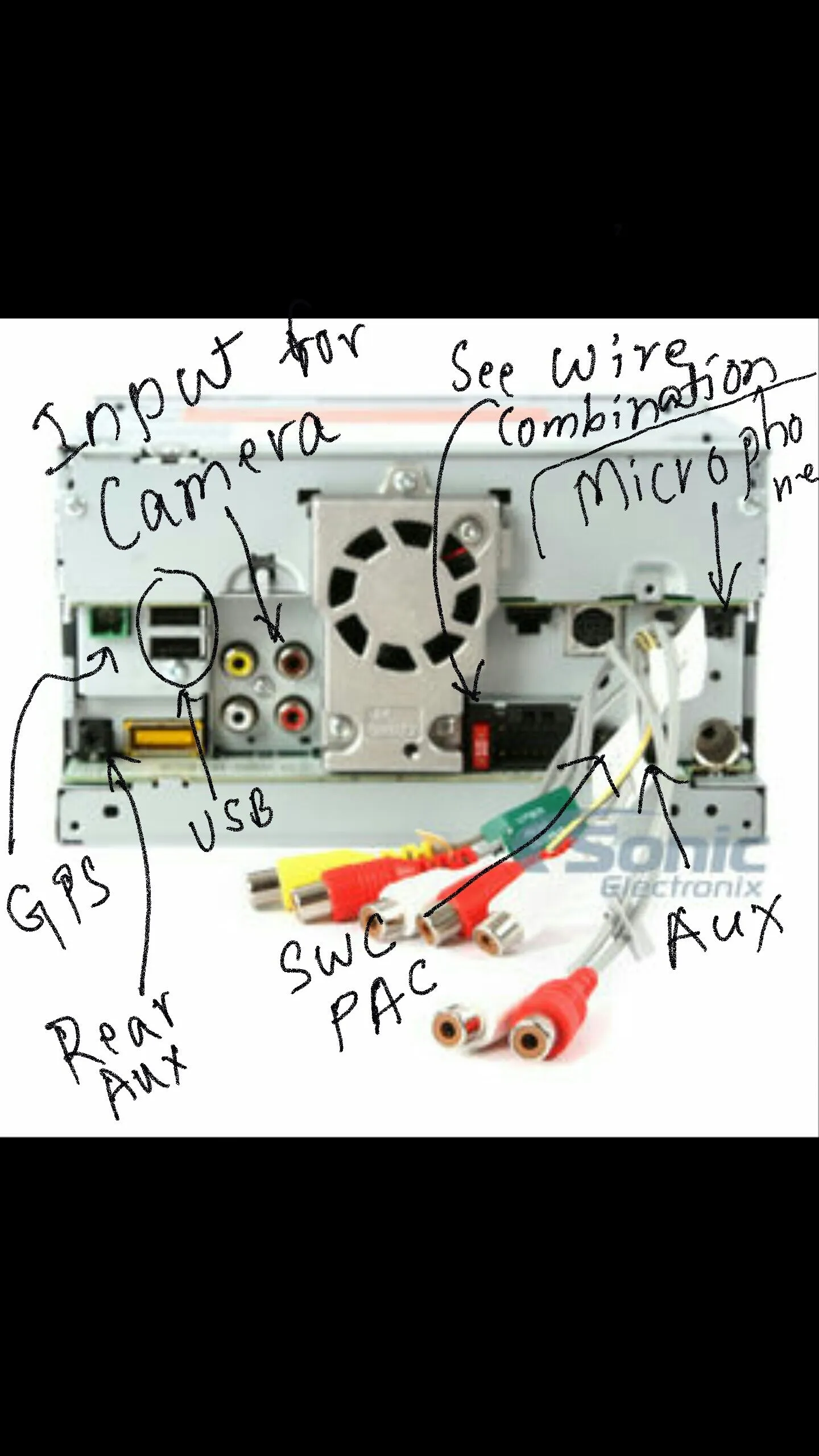

Very important Note - PAC RP4-MZ11 has RCA cables to receive audio from Pioneer nex 5100. Also, nex 5100 has rca audio cables to output audio. DO NOT USE these RCA cables from pioneer to connect to pac rp4-mz11. If you use these cables for audio then volume is extremely low even with full audio setting. Solution to this problem is - a) Either you have to use 3 power amplifiers ( 1 for front spears, 1 for rear and 1 for subwoofer - which will be additional cost) OR b) Cut the rca jackes from audio wires of PAC RP4-MZ11 ( as shown in attached screenshots ) and connect those to NEX 5100 connector ( also shown in attached screenshot) . Keep nex 5100 RCA audio output cables unused.
attachment.php
attachment.php

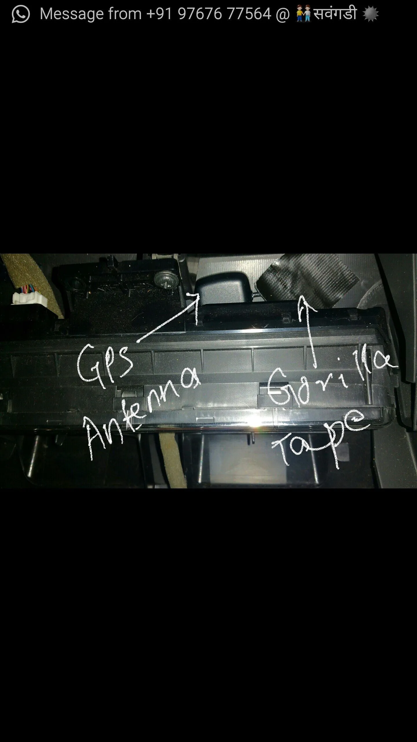

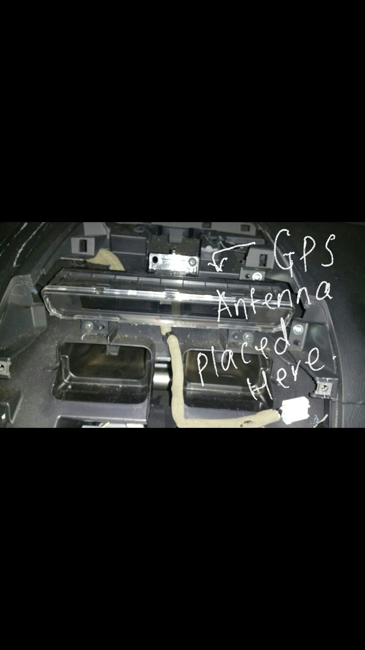

step d) I installed GPS antenna under the cd/dvd wrapper. See below pics to understand - what I mean :
attachment.php
attachment.php
That's all. See the final stage !!!

One question, how did you connect the parking brake bypass? I see three wires on the parking brake bypass and one parking brake wire from Pioneer harness.

Bypass has 3 wires - blue, green and black.
Black is for ground, which goes with pac and nex black ground cables.All 3 soldered together.
Blue goes to nex blue/white and pac blue/white. All 3 soldered together.
Green goes to nex light green ( very long cable which you can cut short ) only. Note - Green is the only cable not attached to pac anywhere.
