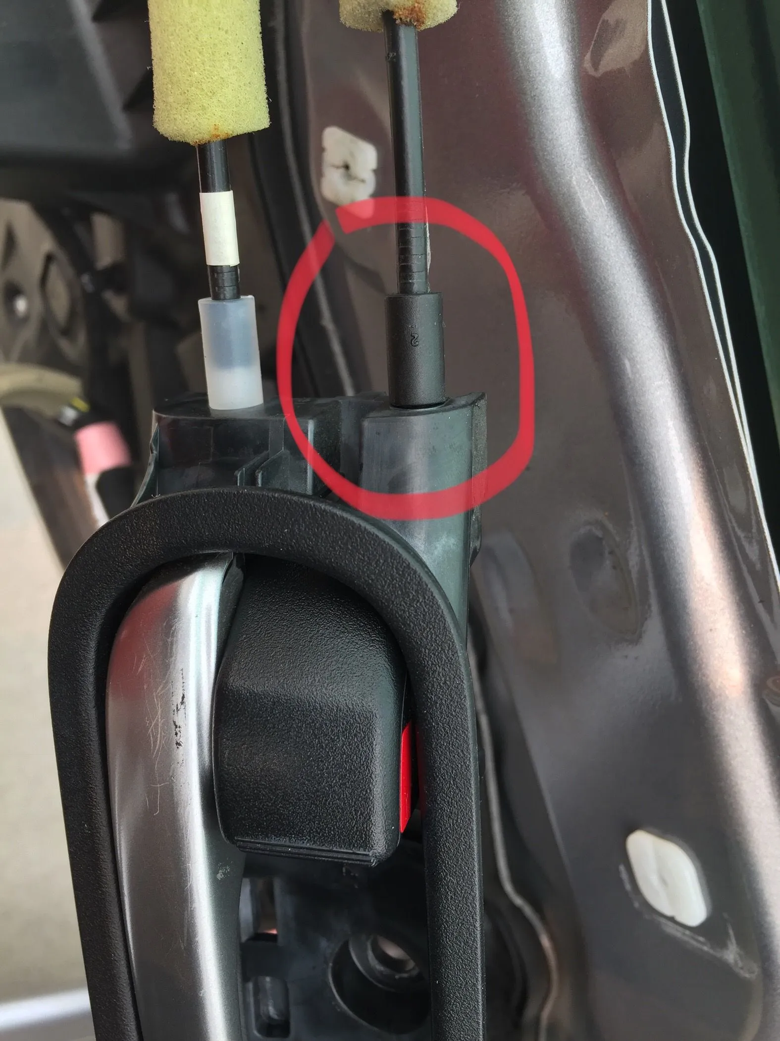

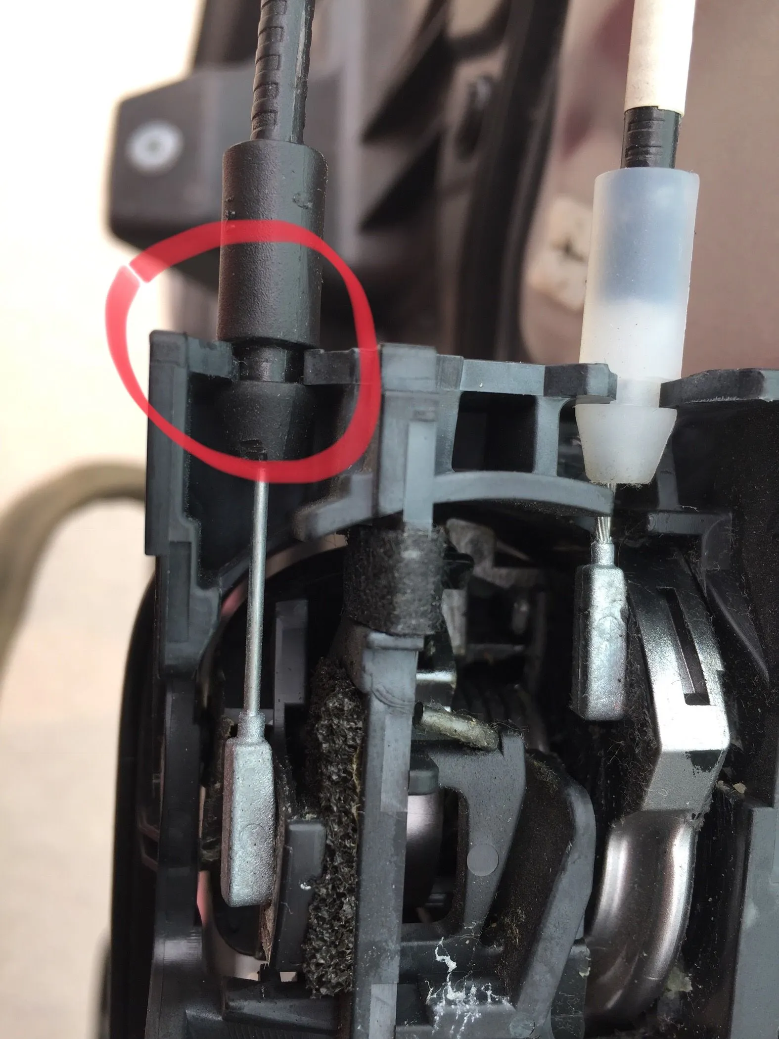

I know this is an old post, but someone might find this useful...
I too had the same problem of the horn not sounding when locking, after I replaced the factory front speakers on my 2010 Mazda3 GS 4dr sedan,. This was driving me nuts, because although it locked, it doesnt arm the alarm (or immobilizer??). The issue was the cable that goes to the lock switch right next to the door open lever. It wasnt seated in the clip on the back, that stops it from moving back and forth, and had obviously come out when taking the interior door panel off. Hope this helps someone.
See attached photos.
