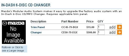

I just bought a 2008 Mazda5 sport. The dealership told me that the stock single disk CD player played MP3 disks. Well, it does not. It looks like things are modular and I found a deal on a BAP5-79-EGX. Will this fit? I want to keep the steering wheel functions and to keep everything stock. I know this is not the standard part number but it seems like the same unit. Any help is appreciated!
Just double check at MazdaUSA(dot)com (see thumbnail, the site shows the part numbers). The "console" itself the same for 06s, 07s and 08s I believe but the faceplate changes from aluminum finish to black gloss...
The dealer may have confused the Aux input (which you can use to connect an MP3 player of course) with the MP3 CD playing capability...

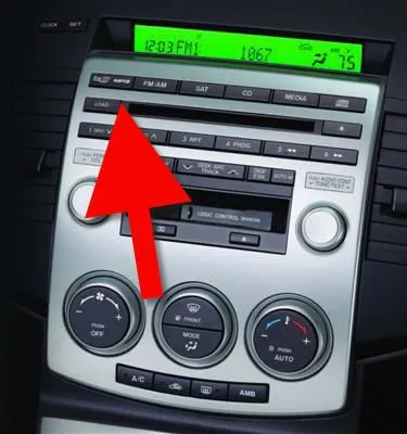

I have an 08 Sport with the 6CD changer (Popular Package), but it does not play MP3s, it has an aux input only. Unless the top left corner label of your stereo reads 6CD and MP3 or something like that (see pic attached with an example, thumbnail below) then chances are it won't play MP3s :(
