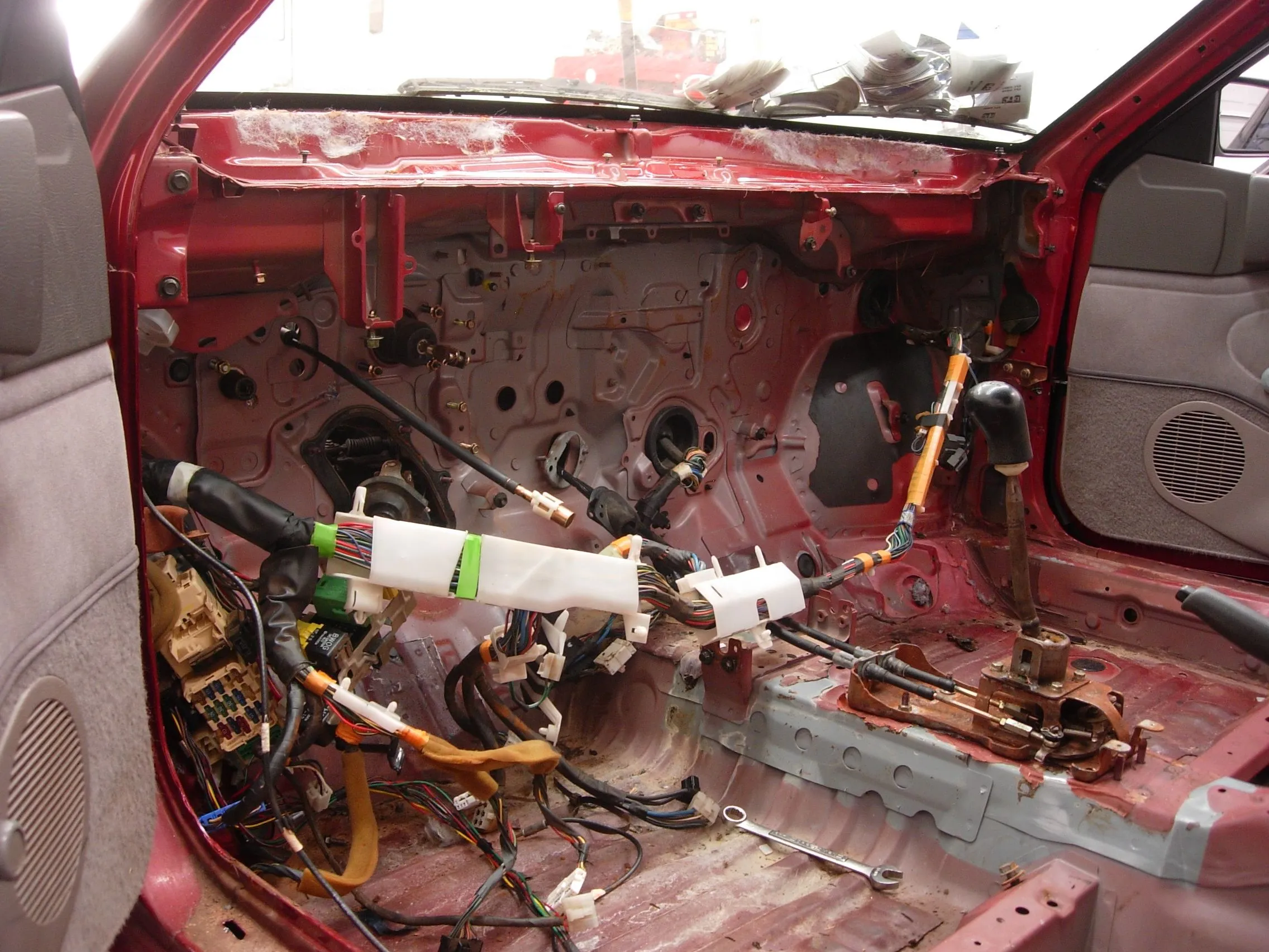

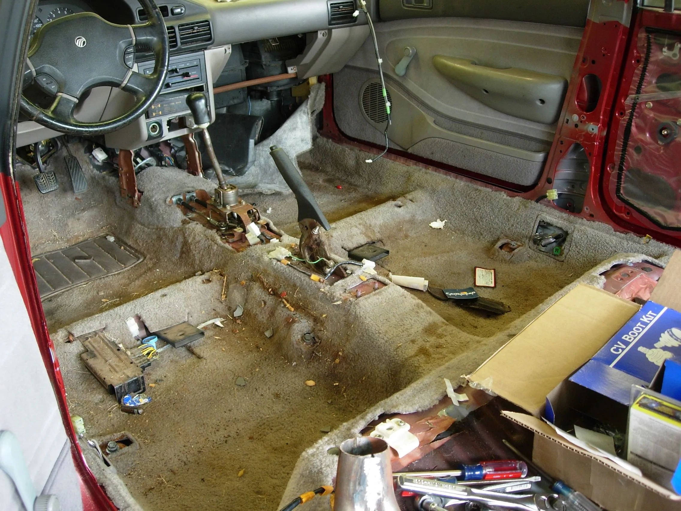

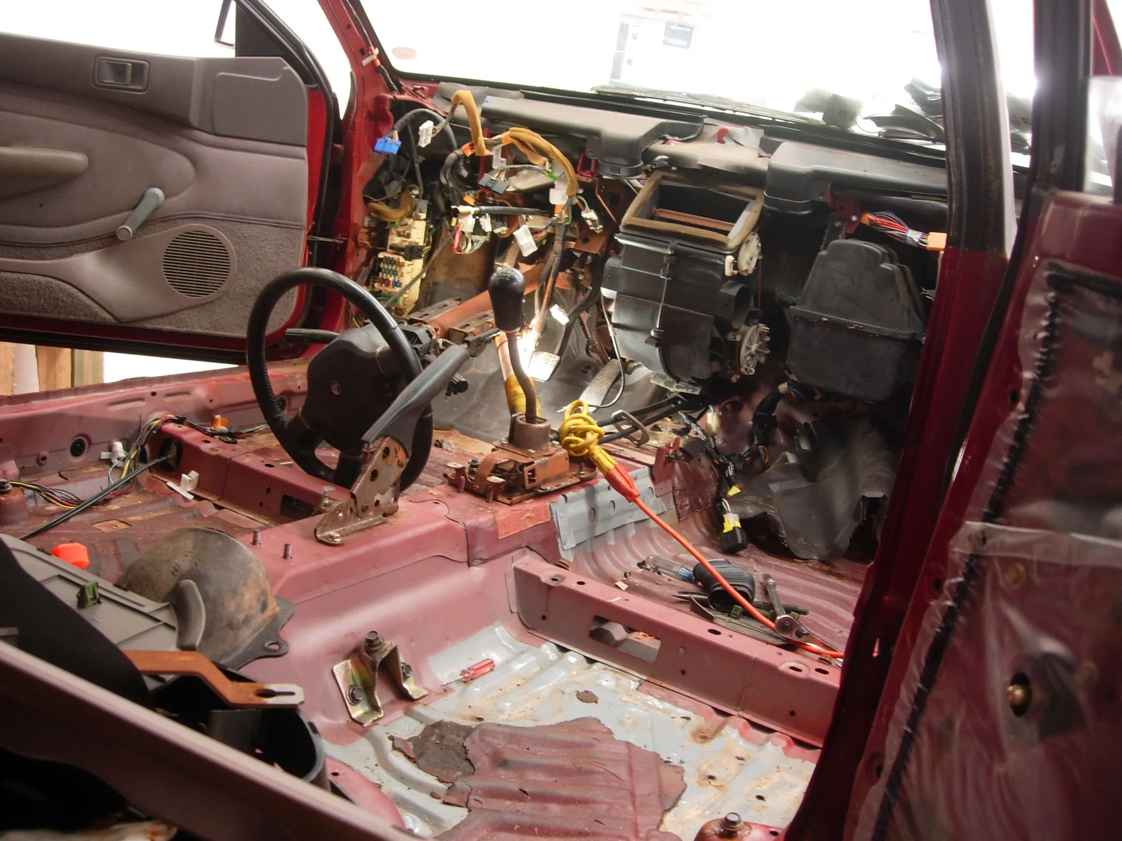

This weekend I've moved onto the interior of the car. This included removing anything from within that was bolted down, including the dashboard. The carpet was disgusting and I'm not at all unhappy to see that go. The dash will go back in, but it came out to remove sound deadening and prep for paint. I'll likely replace the dashboard as this one is quite cooked from years of sun beating down on it. It was already cracked and just the lightest pressure fractures the surface. Doh.

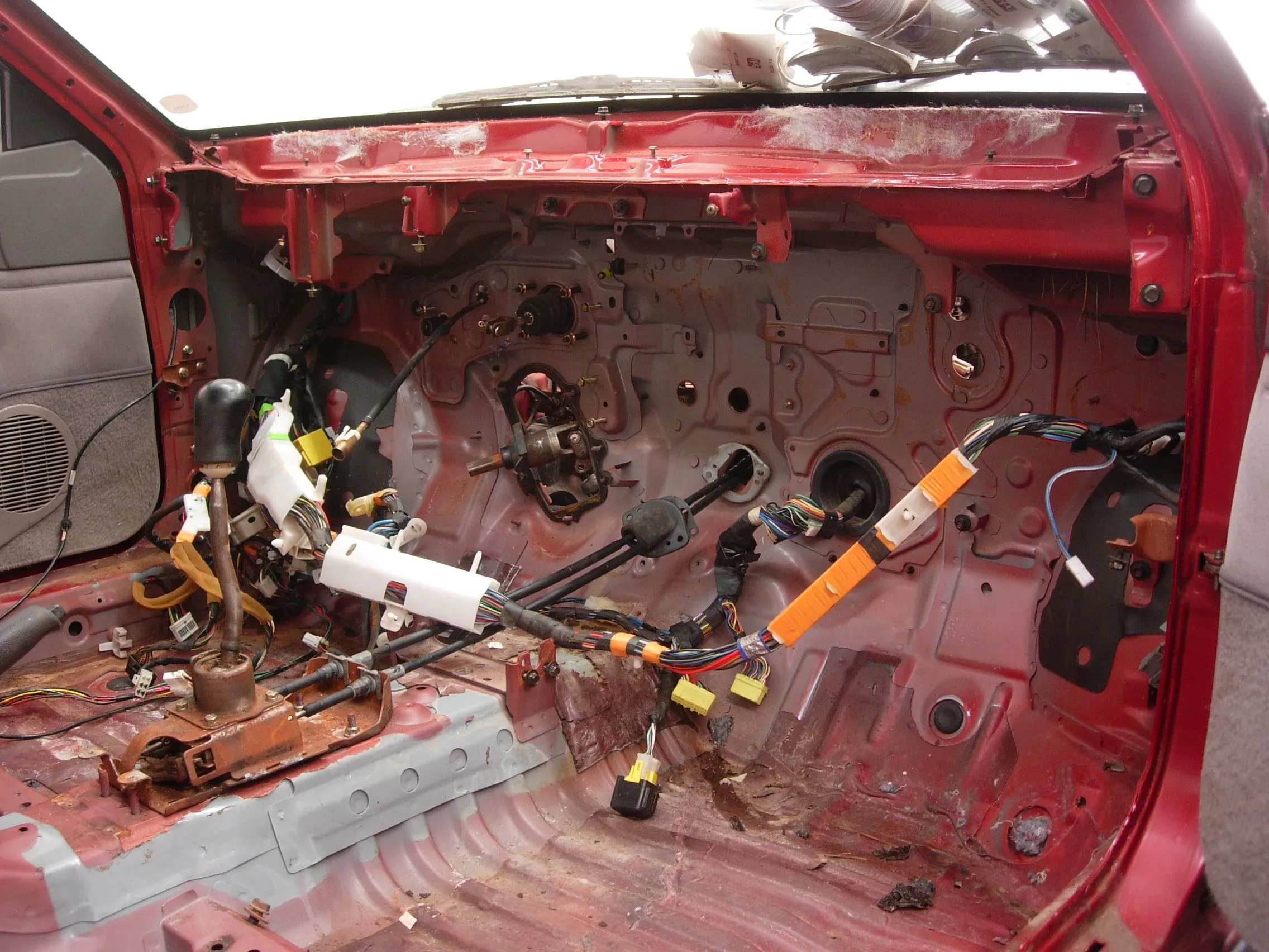

I removed all unneeded wiring from the cabin harness pertaining to the interior lighting, sound system, and automatic seat belts. This left a nifty pile of wire behind. I also got a jump on removing the tar-based sound deadening from the floors. Fortunately, it's coming up fairly easy, but still takes more time than I'm willing to devote to it. Lastly, the fuel pump within the fuel cell is now wired into a pluggable harness.
I have a 12x12x12 inch box that I have been throwing small items such as screws, brackets, clips, seat belts, trim, etc into. It's amazing how the small stuff adds up as the box now weighs in excess of 20 pounds.
In the middle of the tear down, I threw a battery in the car to make sure all of the aft lighting still worked after tearing into the cabin harness. For fun, I cranked the car (without fuel and ECU). It was rather nice hearing a bit of life come to the car after sitting for so long. The front wheels did turn as I had the tranny in gear. Cool.

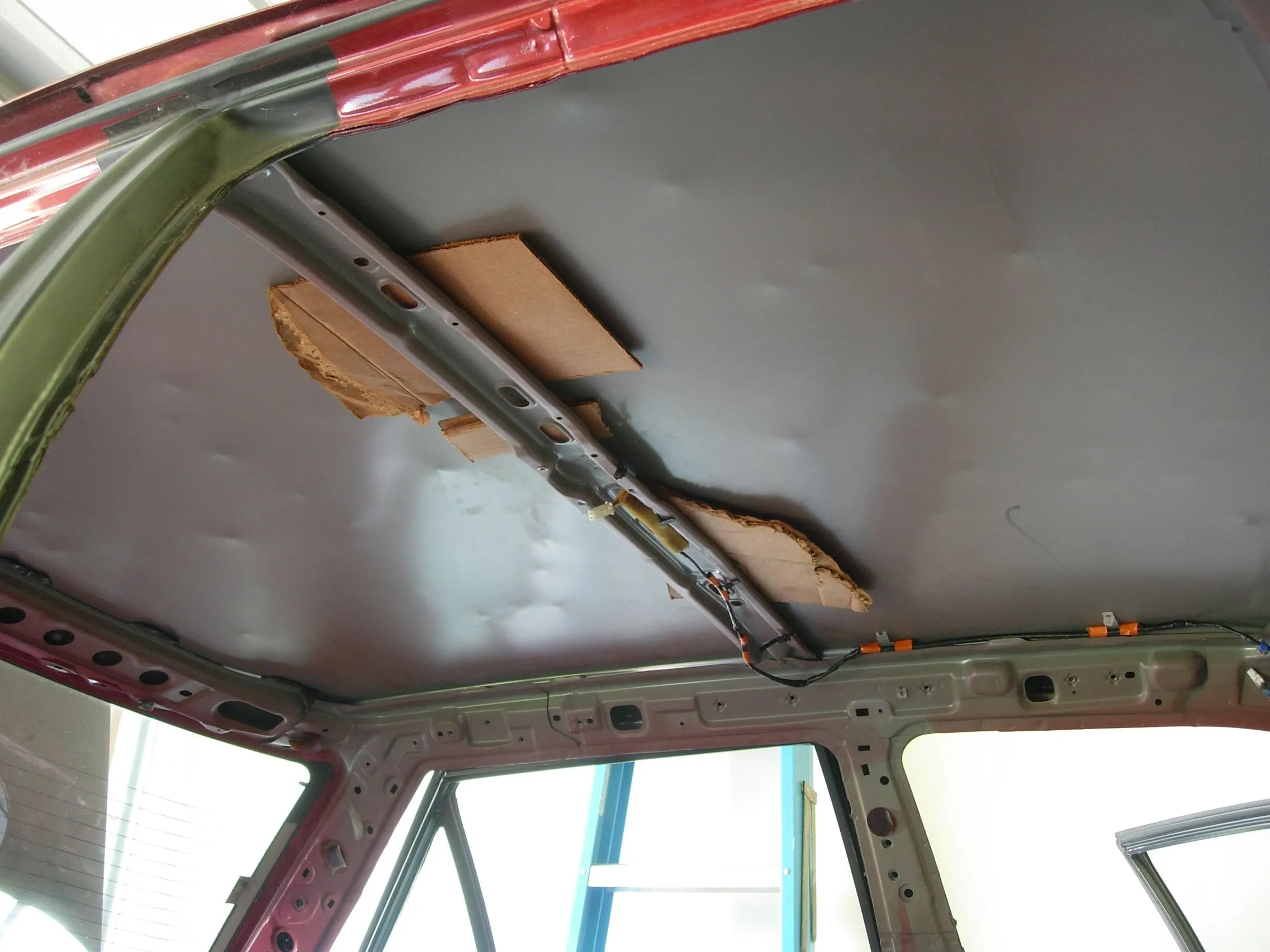

The second image shows how bad the hail damage is on this car. Who knows when it happened, but it had to be a pretty good storm. Furthermore, when I removed the head liner, I found cardboard shoved in between the roof and center support. It's pretty funny the things one finds when dismantling a car (I.E. Empty condom wrappers in the GTX).

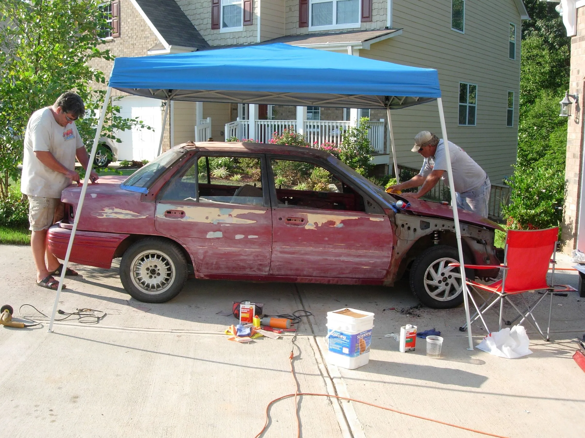

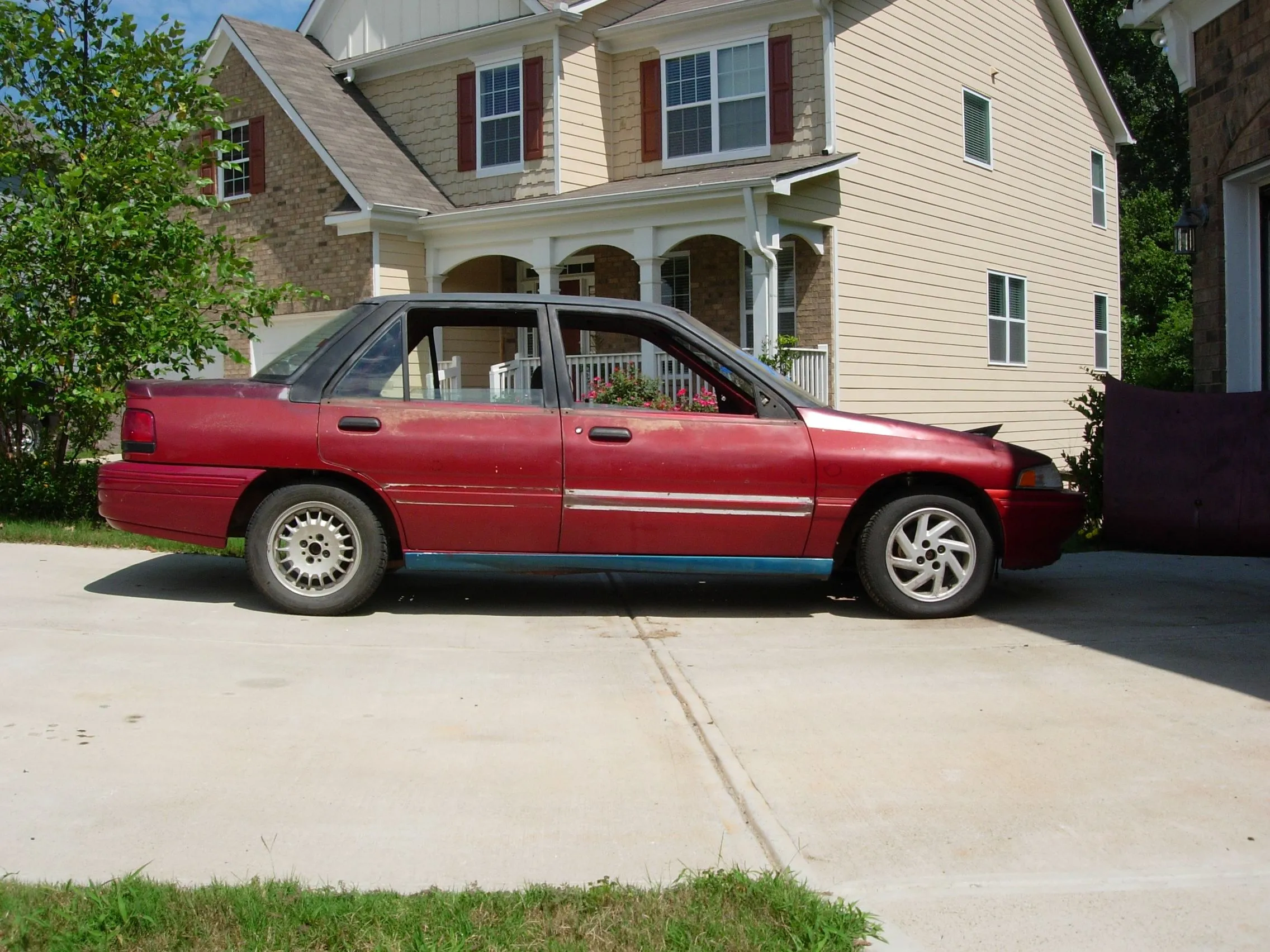

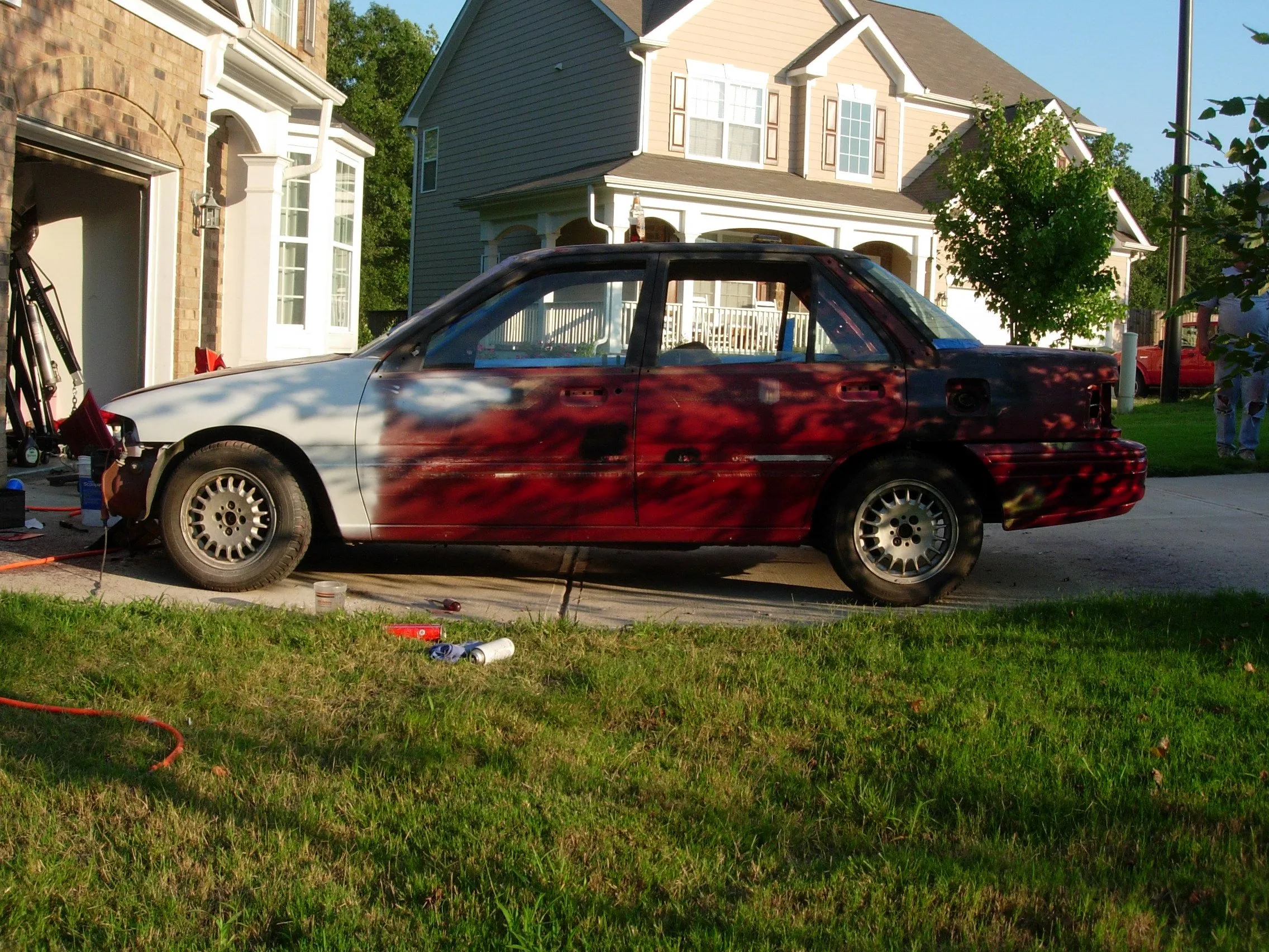

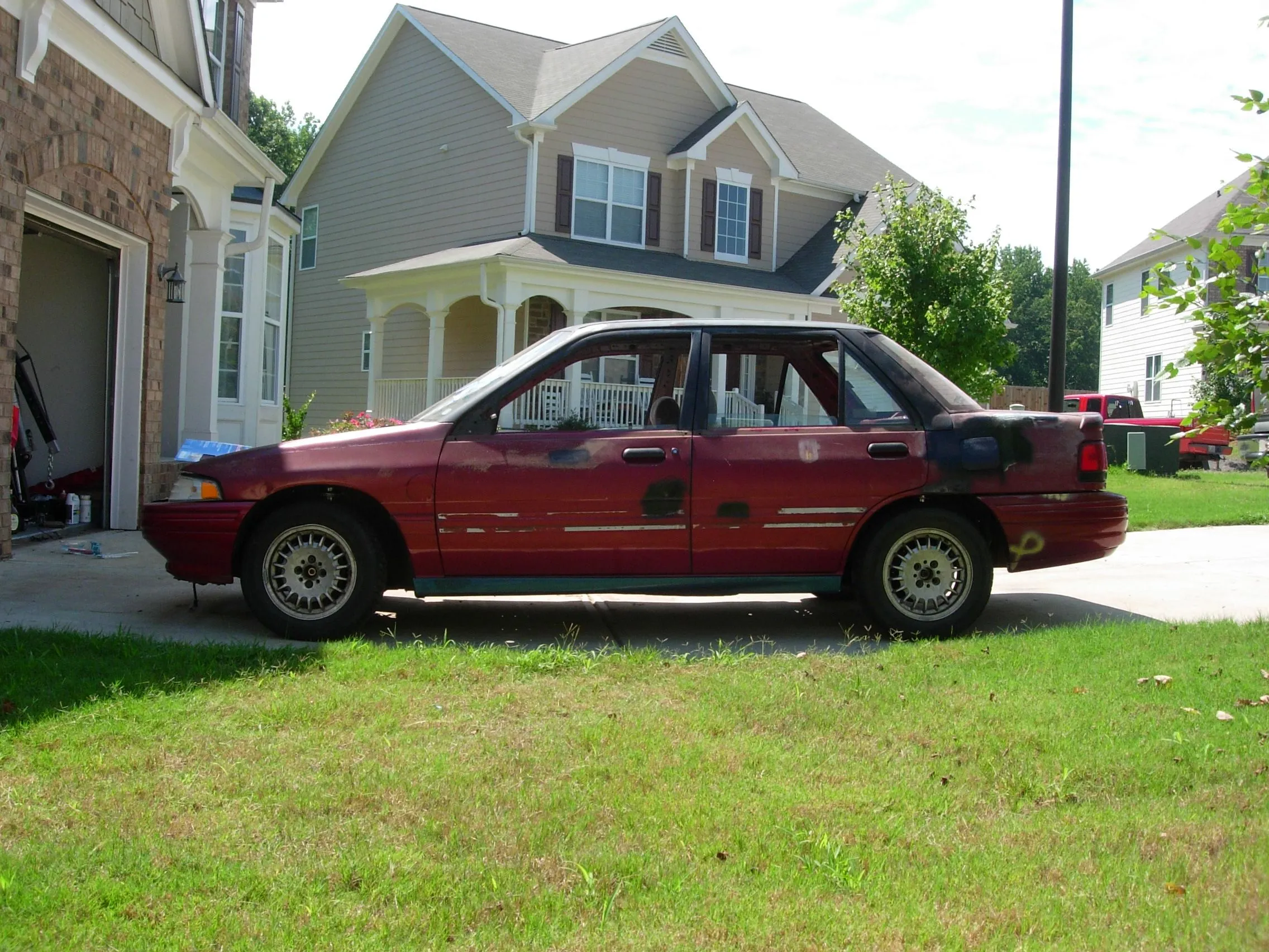

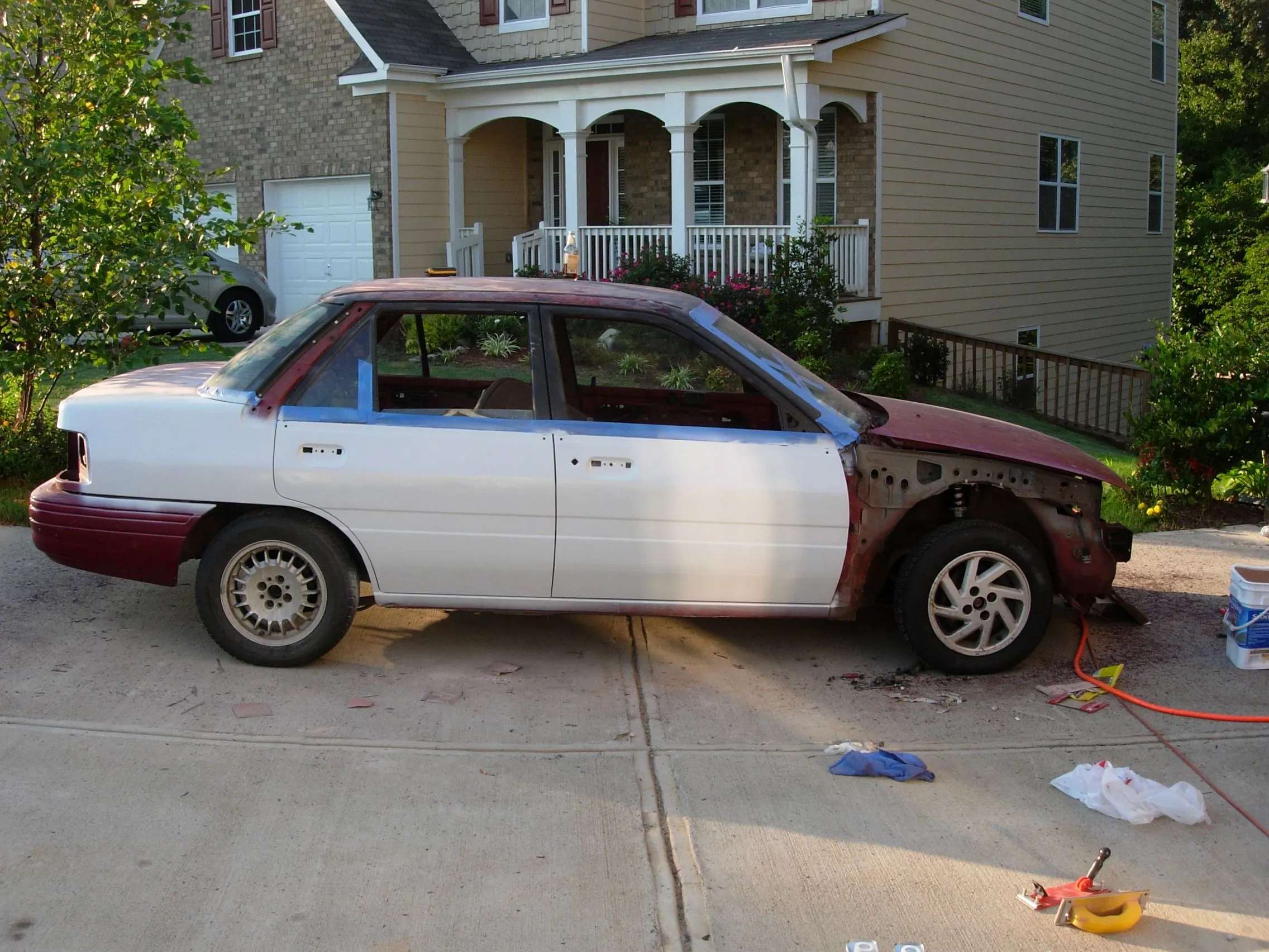

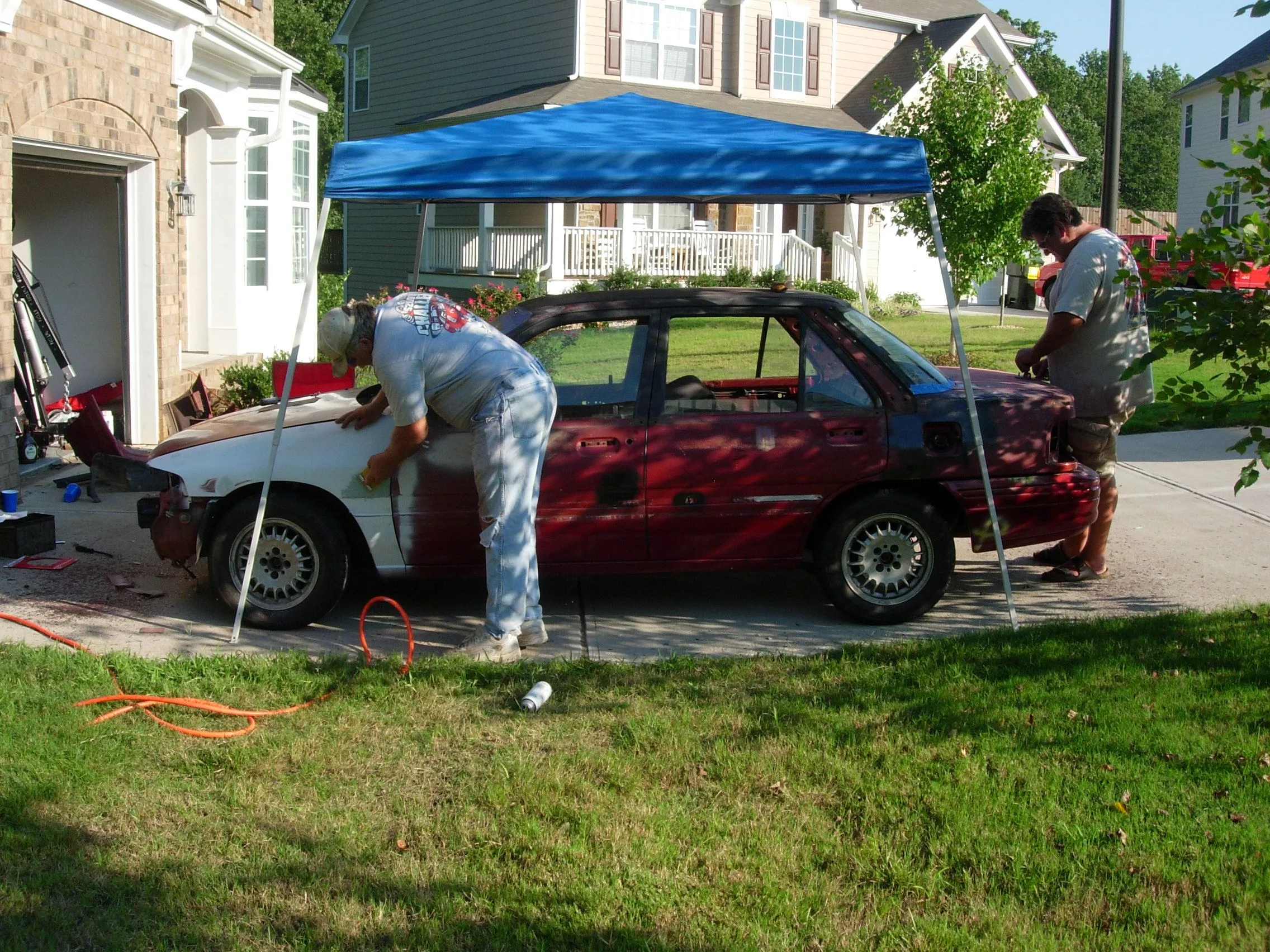

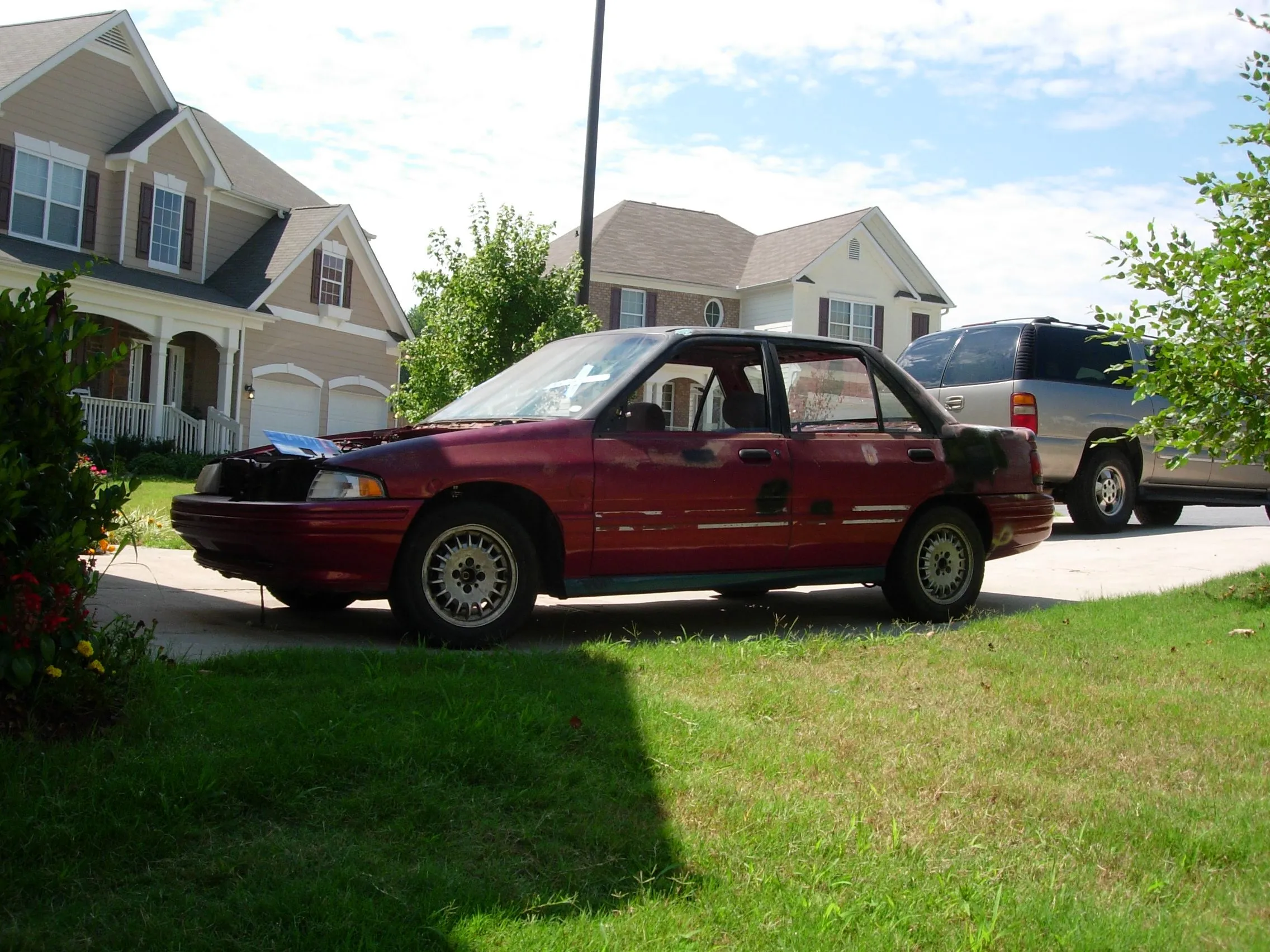

What a PITA. I hate bodywork. Today I moved on to making the car work for the concourse segment of the challenge. This meant wrangling a few of my beer drinking Hong Norr buddies and tackling the prep work for paint. Since the car will have no interior, this means painting just about every inch of metal exposed....we finished prep on about half of the exterior today, if that. Furthermore, it took all of about 8 hours to get there. I'm not liking where this is going, but I hope the end result will yield the fruit of the labor. I've said it during all three build segments of the Miata, and I'll say it here: I'd rather make a car fast than pretty (and I'm more skilled at the fast part than the pretty part). Enough bitching. :)

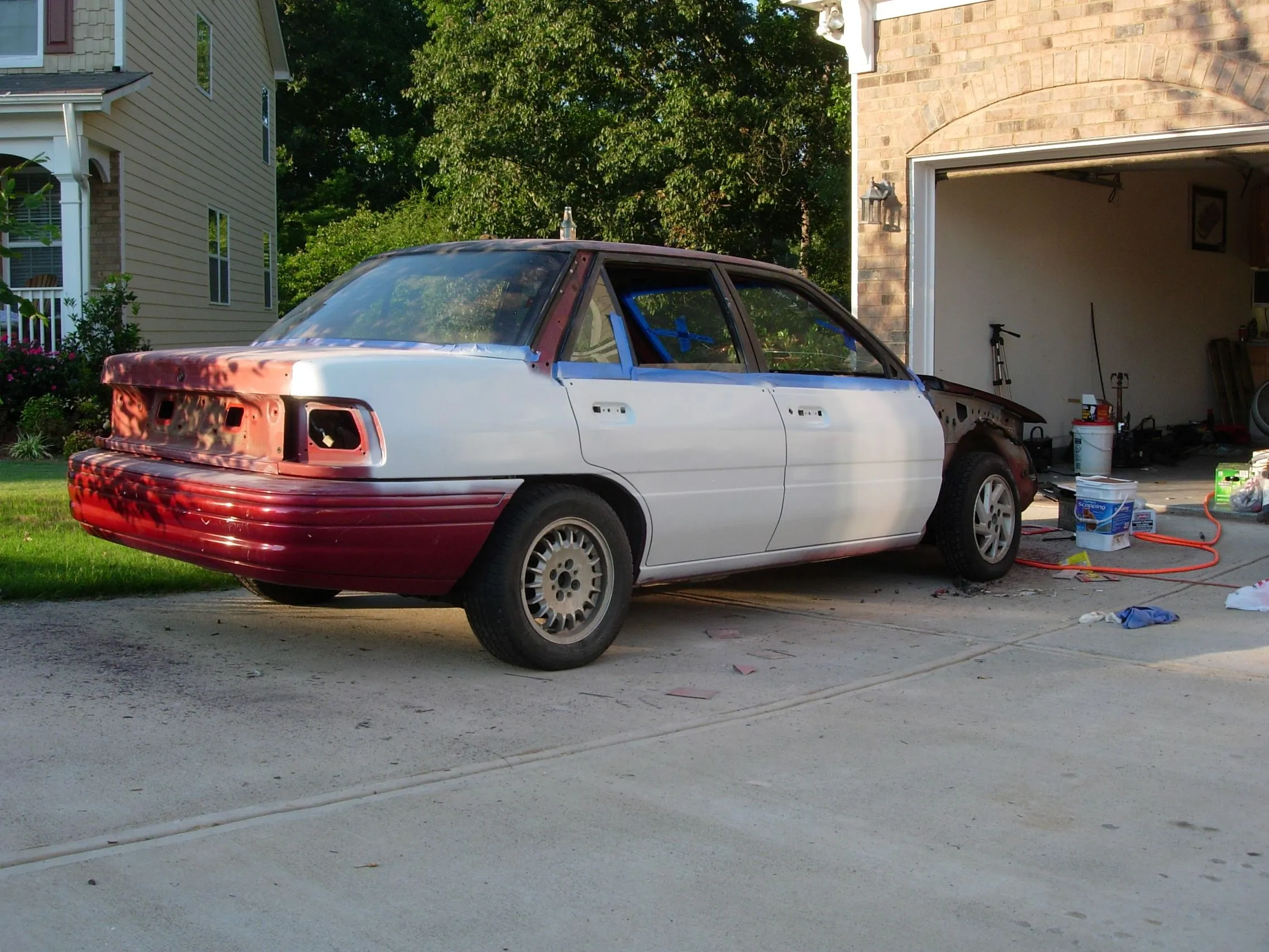

For the first time since I started this build, I sat the car on all 4 wheels. This pretty much gunned me up. Rolling it out into the driveway to minimize sanding dust in the garage, we sanded most of the exterior. The car is riddled with dents from various sources including hail, door dings, and general carelessness from the PO. This required body filling, in which none of us are skilled in that art. Fortunately, though, most of the larger holes were filled and sanded well. Of the 4 panels that were filled and sanded completely, a filling primer was applied. It's sorta cool to see parts of the car in another color (white). In the end, the car will be primarily metalic silver with blue accents.
Maybe I'm being ambitious, but I hope to have removable body panels in final paint next weekend, and the rest of the car painted the weekend after. If that pans out, that'll be a HUGE hurdle behind me.
Anyway, pictards:
