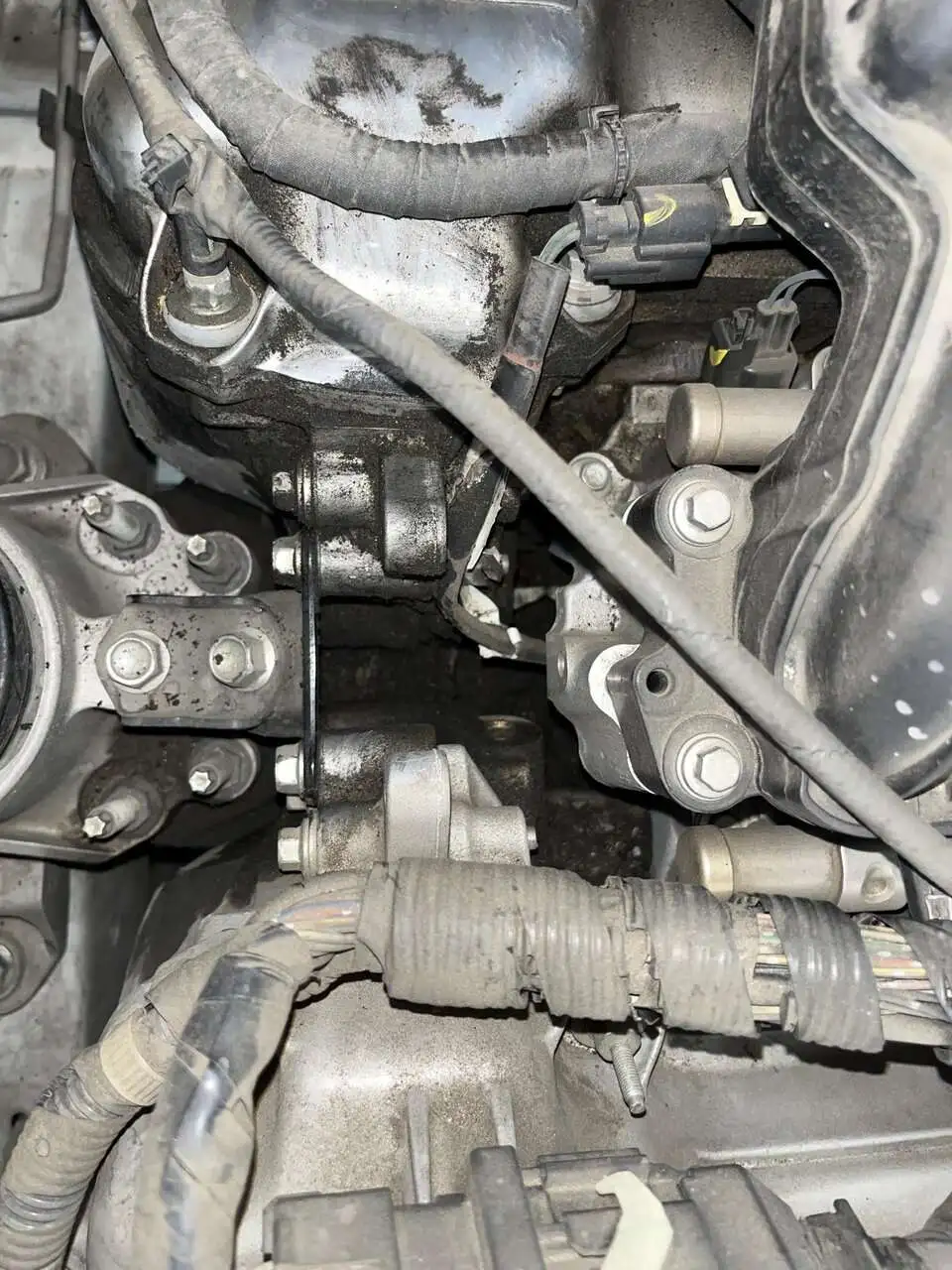

Do those accumulated dirt means oil is leaking from those parts?
I already replaced the engine air filter as well as the cabin air filter.
There are other tasks listed by priority on my list but want to make sure if I should bump to prioritize taking care of those shown in the pictures.

I would not use any engine additives particularly since you have gone this long without them. That oil you mentioned is European Spec if you're using it in a Q5 so again I'd just stick with what the original spec calls for.
Injector cleaner is a pretty good idea and I use it myself, Techron always gives me good results.
That accumulation does not look like leaks, just pretty normal.If it bugs you clean it up with some brake cleaner.
I agree with rowlands. If you don't have notable oil consumption and don't have oil drip spots of the floor where the car parks, don't worry. I also prefer Chevron Techron Concentrate as a fuel system cleaner. If cleaning is needed, this has done a good job for me. And, stick with the specified oil type and viscosity for each engine. About the Bardahl product, note this description from their web site, "The extra thick formula...." It is probably some very high viscosity oil that serves only to thicken your engine oil. If you want higher viscosity oil, buy higher viscosity, maybe 5W-30 oil for high mileage engines, if that's what you want. It costs the same as what you're using, not something extra for an additive. I wouldn't jump two viscosity grades. You don't list your location, but you really don't want oil 2 grades thicker in cold winter areas.

Southern California.
I'll try Techron next time.
I used my old ODBII scanner late afternoon today. No fault codes.
I don't know if the values on the "Data Streams" are within acceptable limit though. But no fault codes is great news to me.
