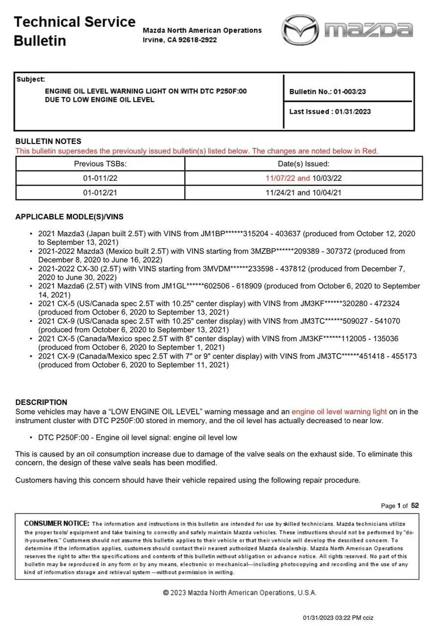

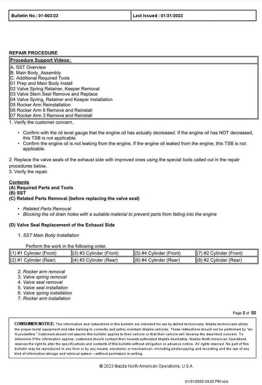

Here is the related TSB for oil consumption issue on 2021 CX-9 with 2.5T:
TSB No. 01-003/23: Engine Oil Level Warning Light On with DTC P250F:00 Due To Low Engine Oil Level

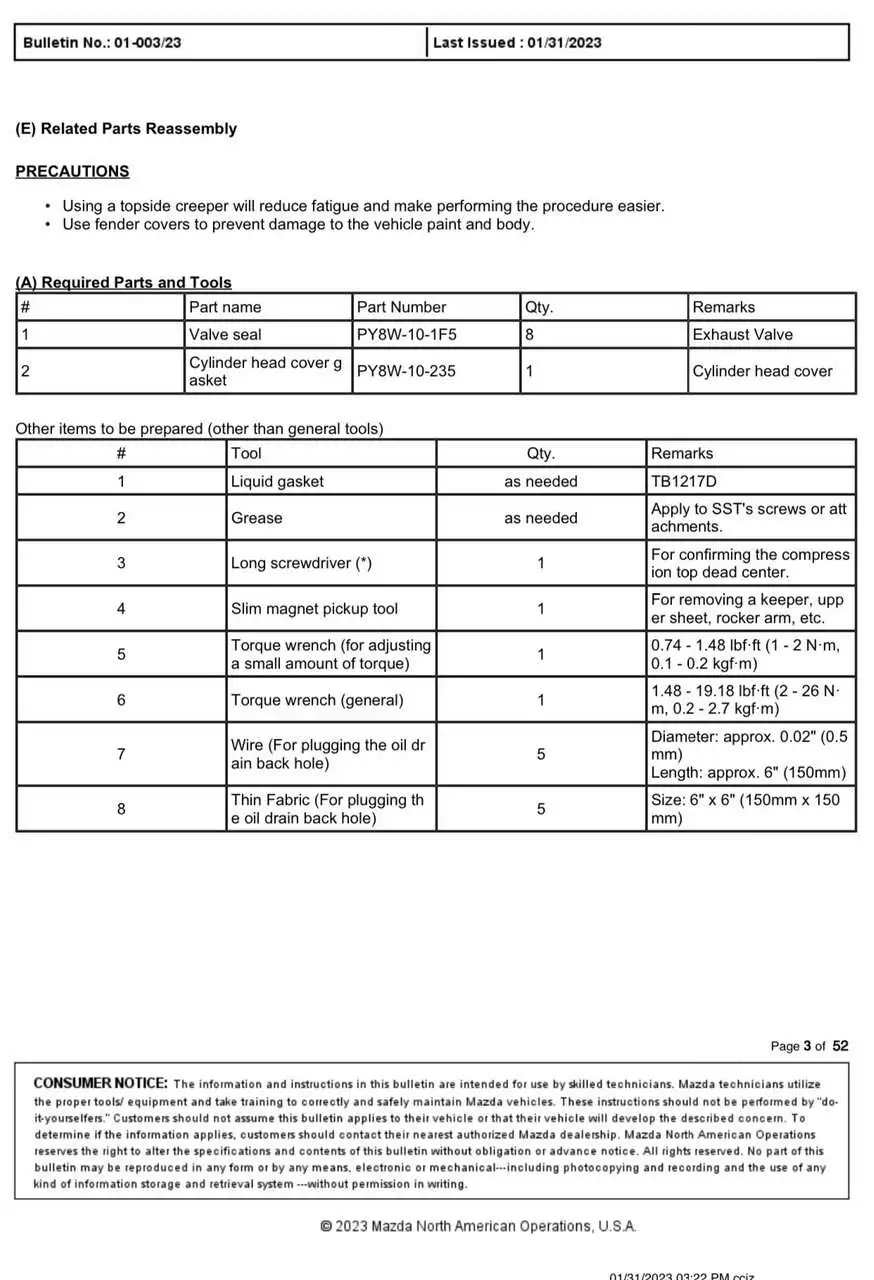

On page 3 we’ll see 2 parts listed for the TSB job:
PY8W-10-1F5 Exhaust valve seal X 8
PY8W-10-235 Cylinder head cover gasket X 1
Your invoice is also listed these 2 parts and p/n 5555-CL-001R Anti-freeze X 4. There’s nothing on the invoice which indicates the cylinder head gasket has been replaced due to coolant in oil. In other words, your dealer has never removed the cylinder head and replaced the cylinder head gasket.

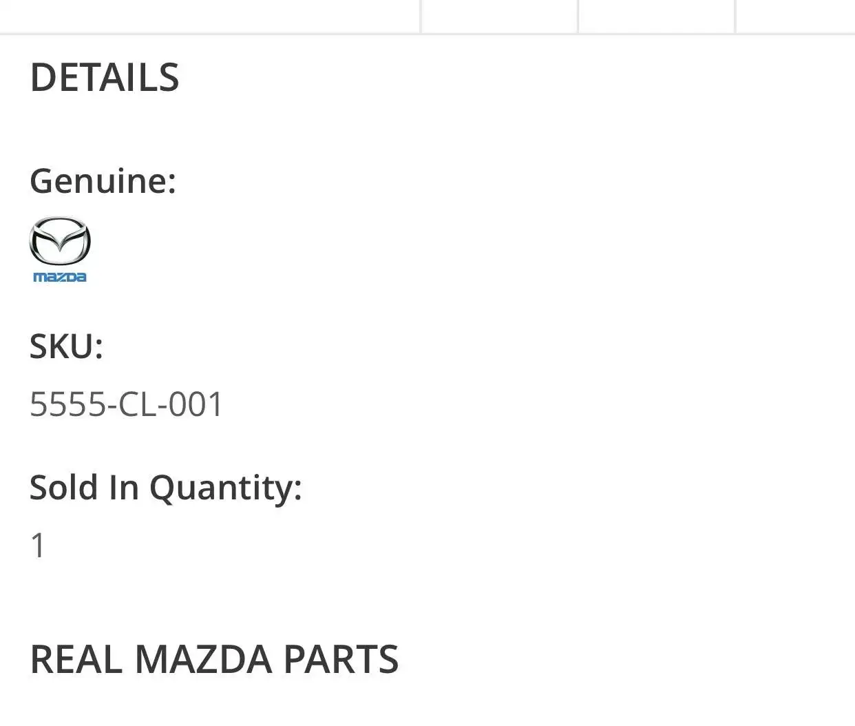

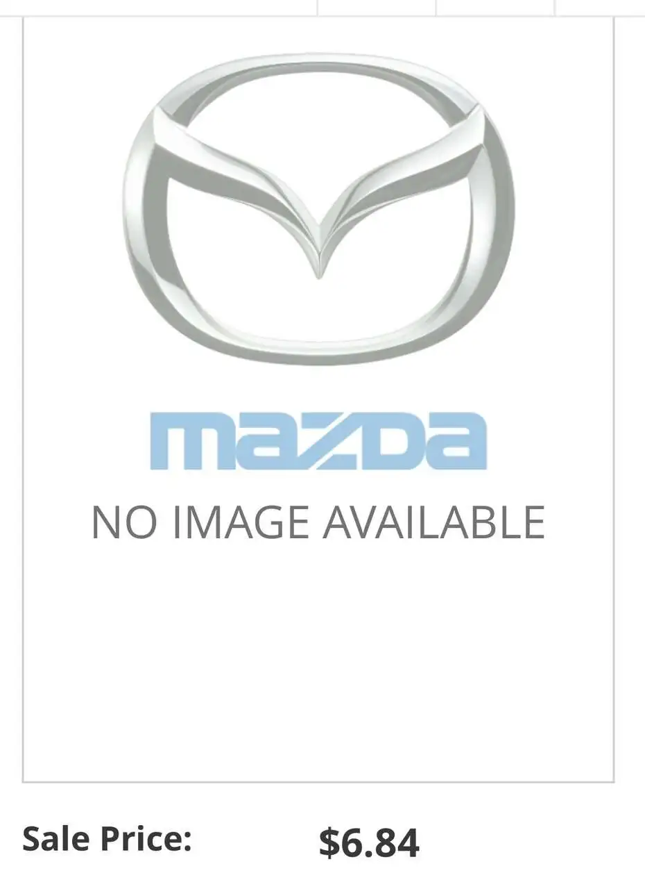

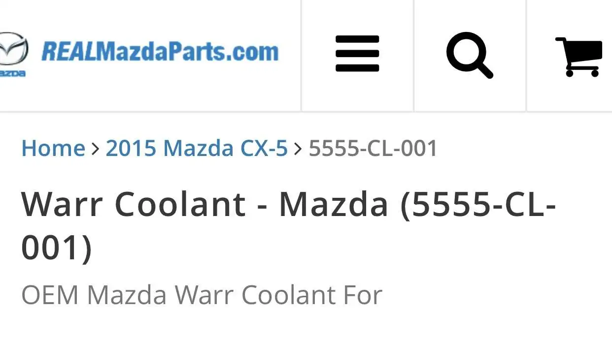

The other thing which is suspicious to me on this work order is the use of p/n 5555-CL-001R Anti-freeze. It’s a Mazda “Warr” coolant (? warranty coolant?) but it doesn’t say it’s a FL22 coolant. The price is so low comparing to normal FL22 which to me it isn’t the required FL22 coolant!
The real Mazda FL22 coolant:
This oil consumption repair based on the TSB for your 2021 CX-9 GT by your Mazda dealer is very disappointing and has full of question marks! And that 4-wheel alignment job is very strange and out of line!

Is there anyway to know the difference between the coolants? Different colour? The one they put in is a light green colour.

For Mazda FL22 coolant i’d say it’s in green/bluish color so it’s hard to describe on paper. Since you’re in Canada the p/n for Mazda FL22 coolant is different from the US, 0000-88-AFFL-22A instead of 0000-77-508F-20.
If I were you I’d take the invoice and talk to the service manager or even general manager questioning the dealer why they didn’t replace the cylinder head gasket and cylinder head at the first place when they spotted the coolant in oil? And why they didn’t use required Mazda FL22 coolant and show them the difference on the part number. I’d also ask them why they did the 4 wheel alignment for unknown reason which isn’t mentioned in 2 TSBs.
It won’t hurt to contact Mazda Canada for the whole issues you’ve encountered. Ask them why your 2021 CX-9 GT is having cracked head problem even thought it has updated cylinder head and exhaust manifold gasket based on the TSB?
