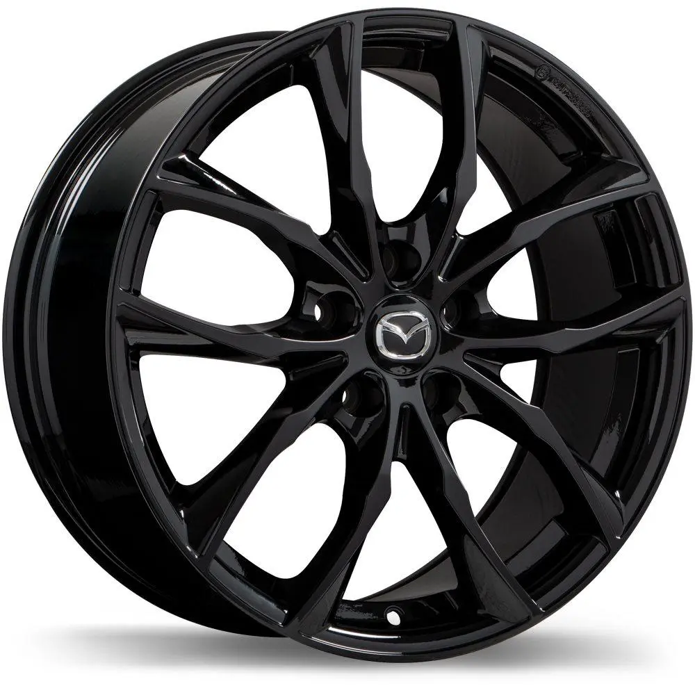

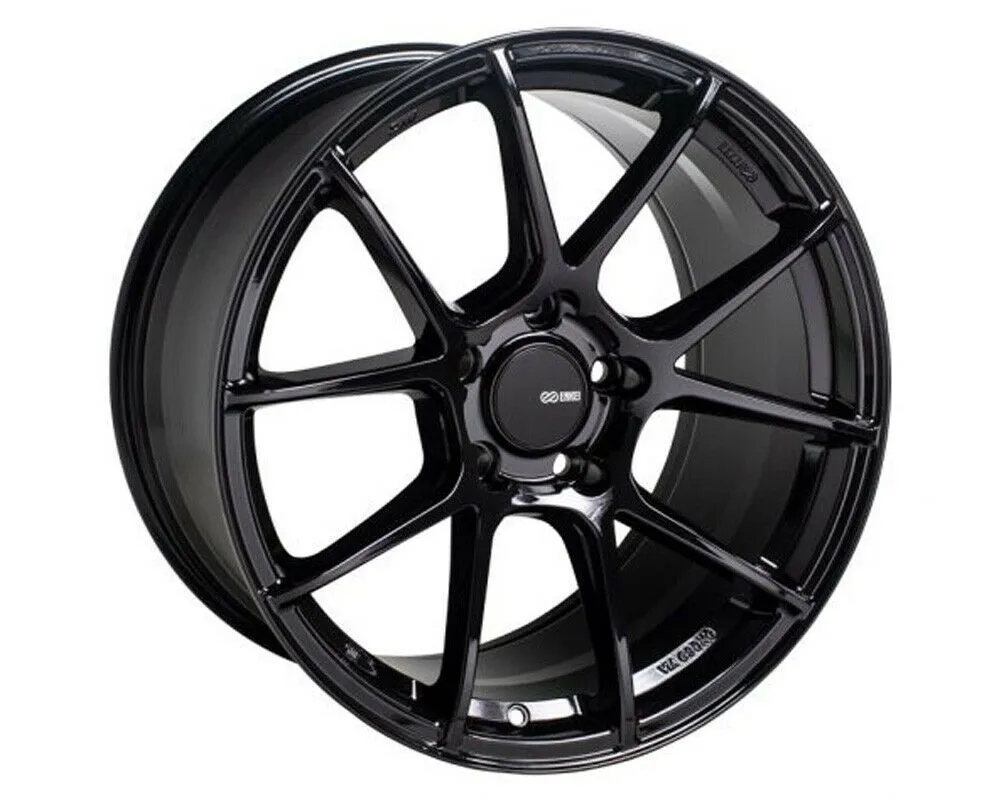

New to the forum, bought a white 2020 CX-5 Touring AWD last weekend. I've narrowed my wheel options down to these two.
18x8 +45 gloss black Mazda M011
18x8 +35 gloss black Enkei TS-V
I'm looking for photos of these wheels mounted on a CX-5. I've been able to find 1 picture of a blue CX-5 with 18" M011 in the "show me your wheels" thread but that's it. The Enkei's only weigh 18.8 pounds which make them more tempting but I also want a somewhat stock look. Also if anybody wants to chime in on going with 235/60/18 over a 225/60/18 on an 8" wide wheel I'd love to hear your thoughts.

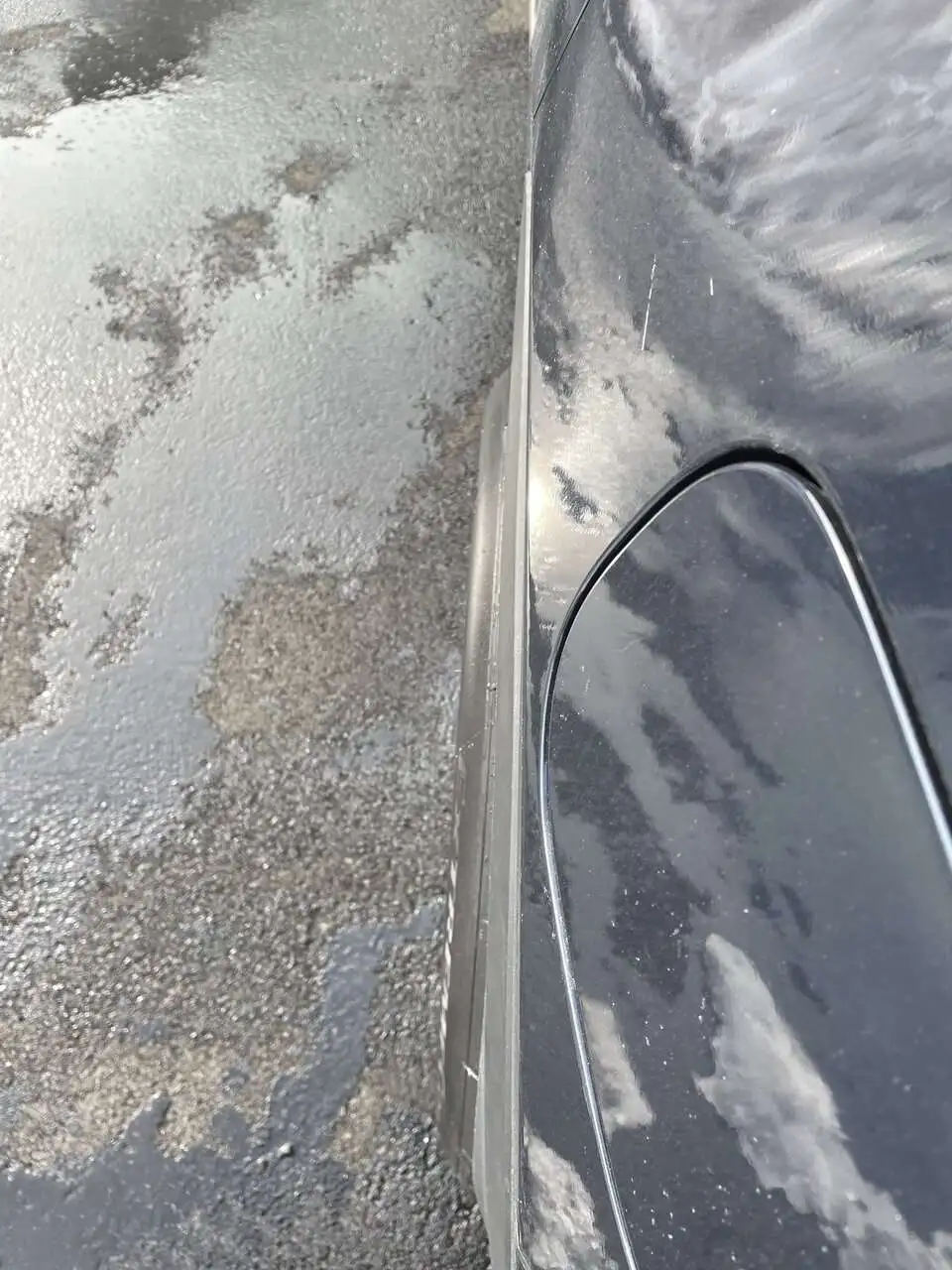

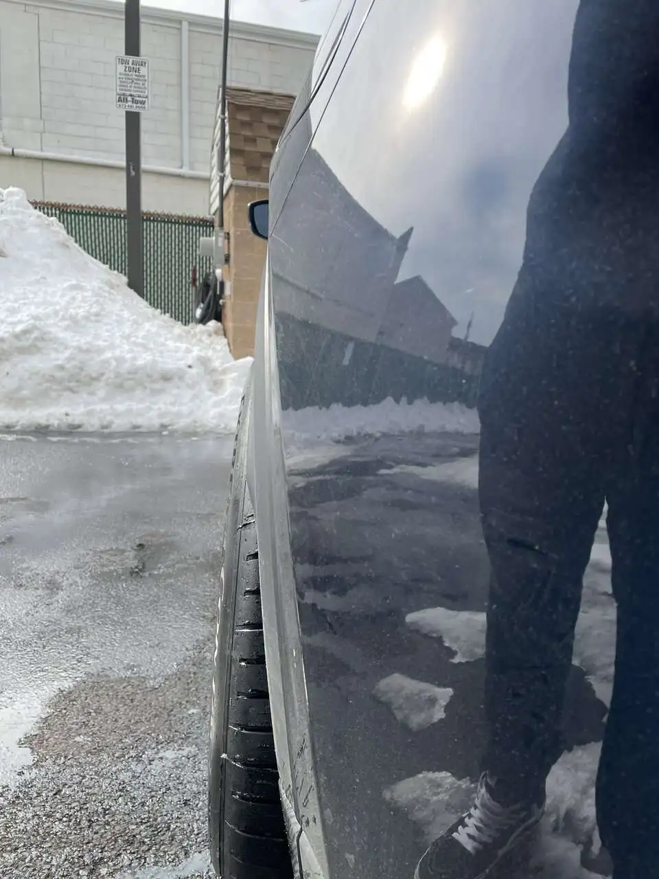

What did you end up doing? Im thinking of a 235/60/18 on 18x8 +35 offset, but want to see if the community can confirm fit/no rubbing at full lock. Photos much appreciated!

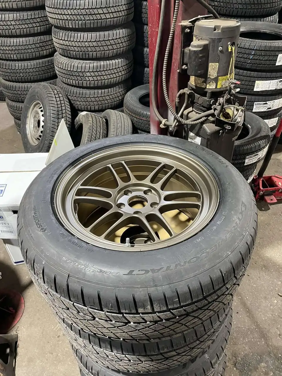

This is a 9.5” wheel with a +35 offset. Actual rim sits flush to the fender, but included tire pic shows how fat the tire sticks out further from the rim.
View attachment 309682This is a 9.5” wheel with a +35 offset. Actual rim sits flush to the fender, but included tire pic shows how fat the tire sticks out further from the rim.
So you ended up with RPF1s! I’m now considering 18x8 +35 RPF1s in silver with nitto nomad grappler 235/60r18
