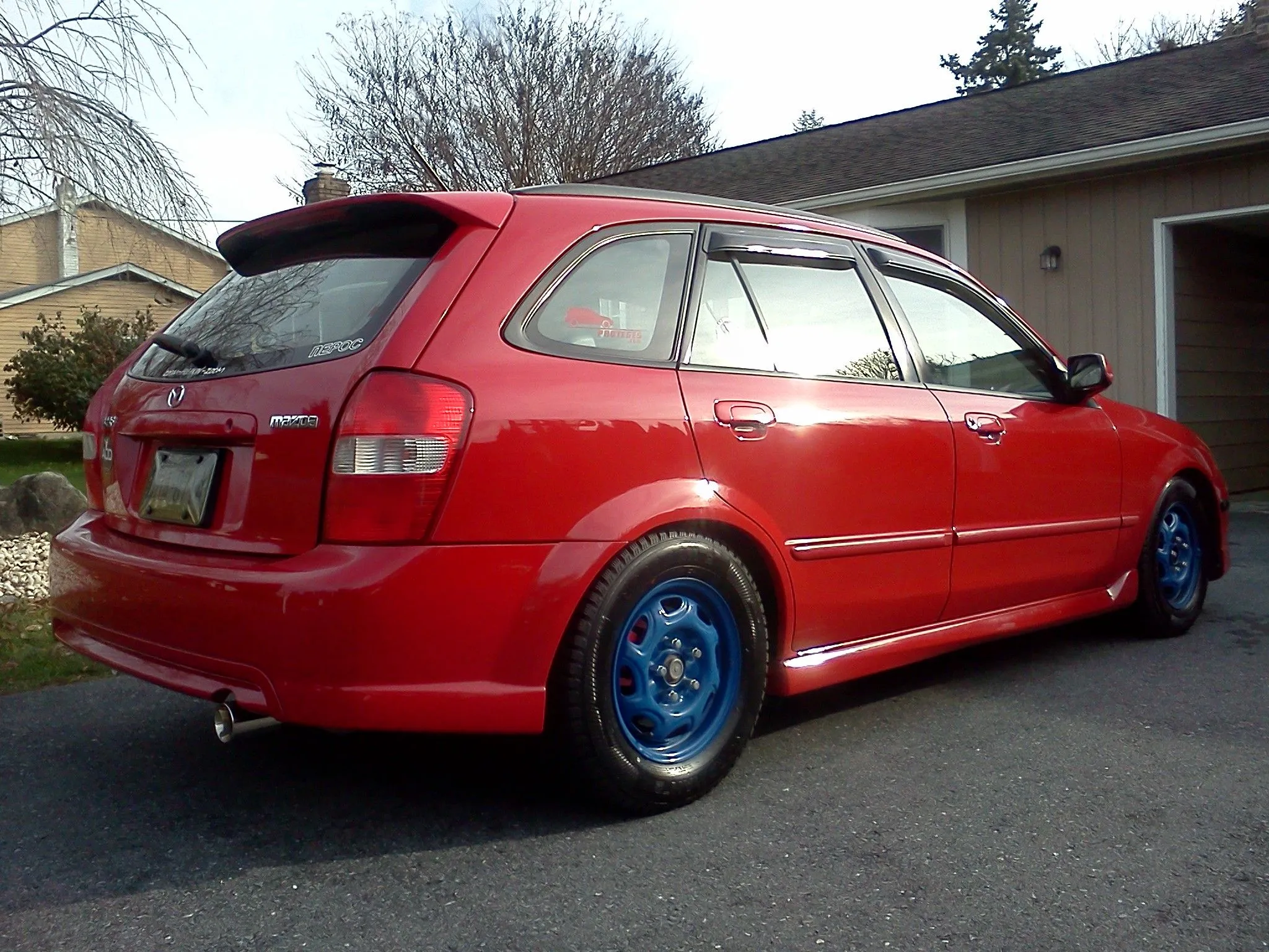

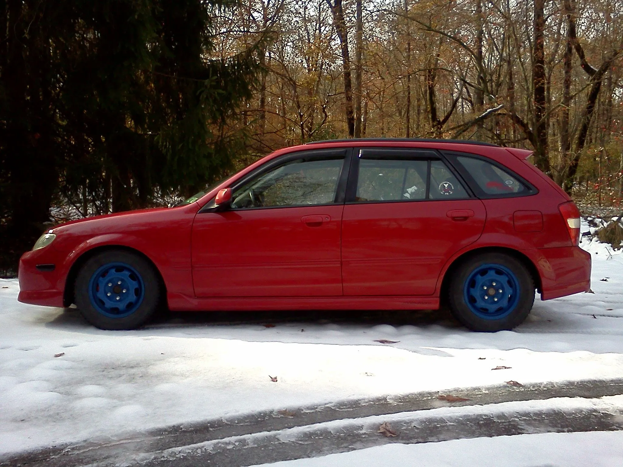

You should be fine with that offset. I'm running 1993 Eclipse steelies that are 14x5.5 +35 with 185/70 tires and have no issues, the caliper is close though. What size tire are you looking to run? 185/65 is suggested but 185/70 will fit both stock height and lowered on Tokico Blues and Tein S-techs.
Here's a few shots of mine and reut1's set-up.
Stock height
w/Blues and S-techs
A little fun with paint

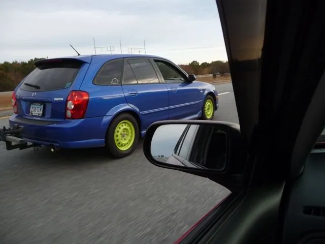

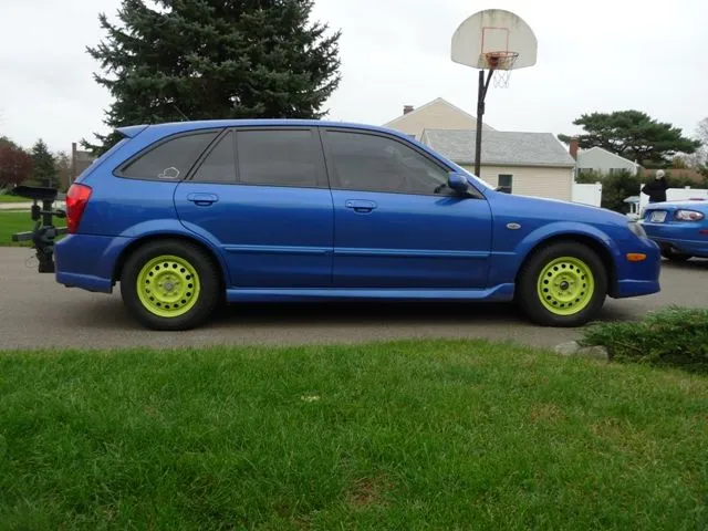

reut1's Laser Blue with key lime green wheels
