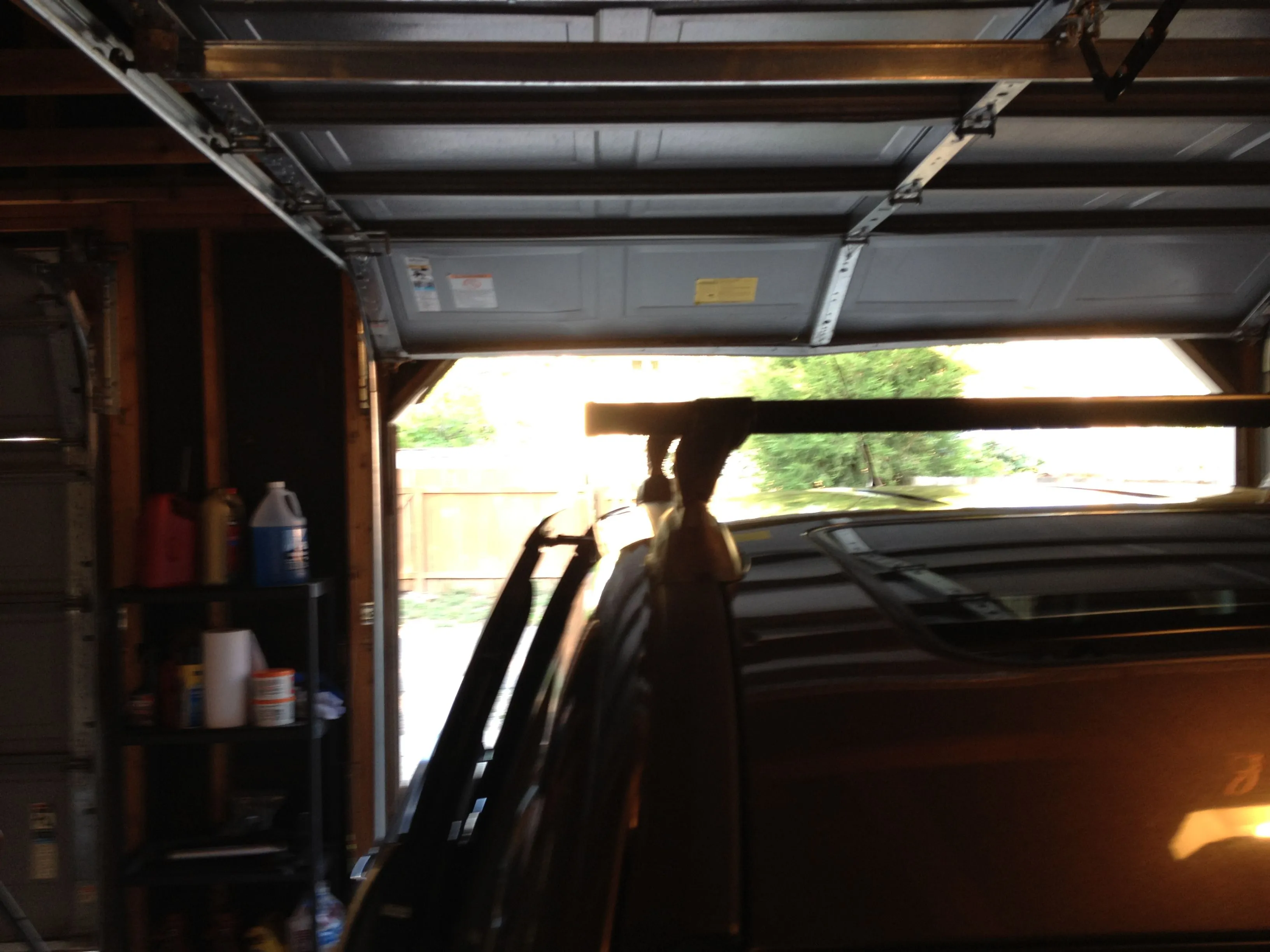

Thanks to all who posted pics and provided info on a rack setup for the 5. After reading this and other threads, I went with the Yakima Control towers, Landing Pad #11, and 48" cross bars. I already had the 48" cross bars and wasn't in the mood to go get longer ones. I'm happy with the fit, as much longer than 48" would have me hitting my head when I got in and out of the car. Attached is a pic for reference of the 48" length.
As for which bolts to use, I used the shortest ones in the box and tightened till I felt the tower was secure enough. Didn't notice any bending of the sheet metal.
No gear on the roof yet, but I'll post up when I start using these things.
